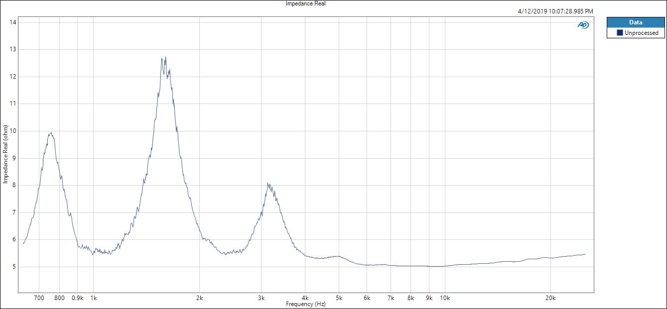

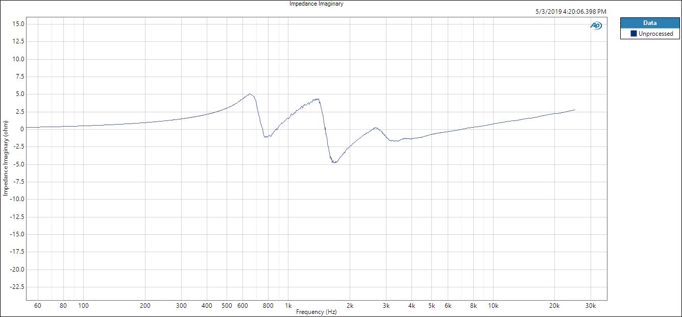

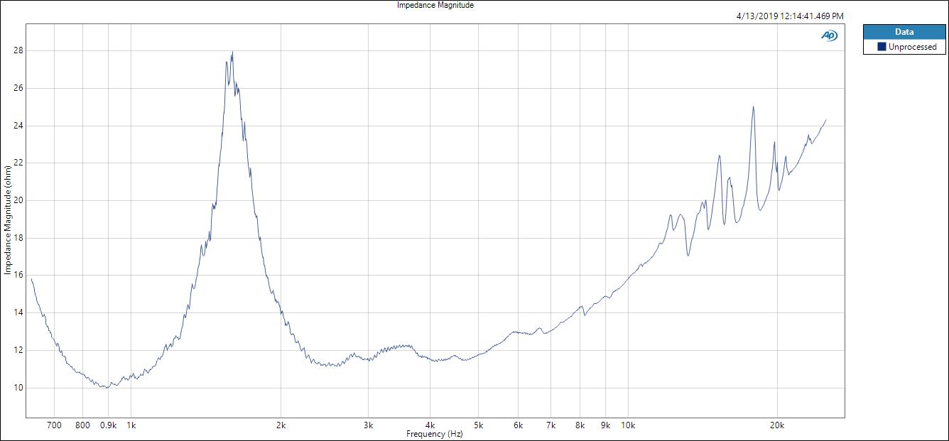

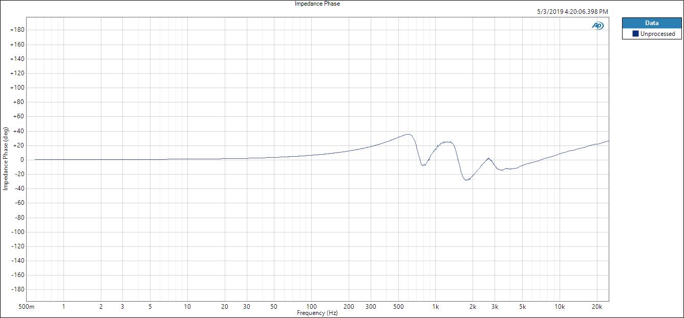

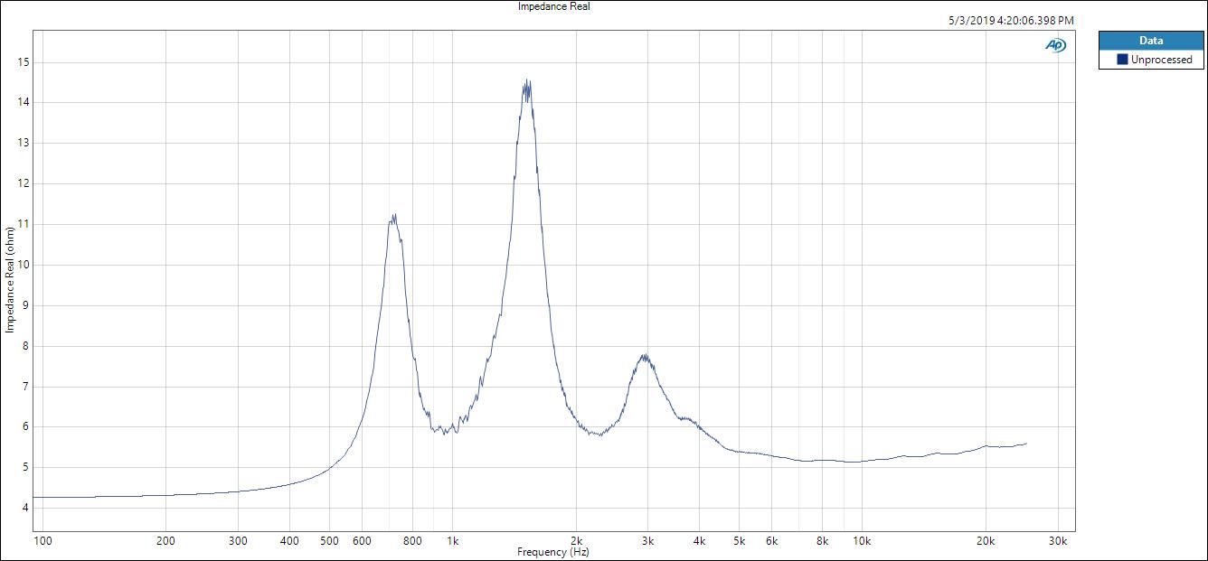

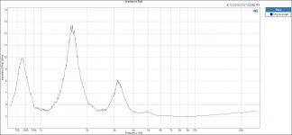

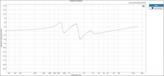

Hello,
Today I have been looking again at the impedance of compression driver attached to waveguides.
See the attached D2 /M2 plots. These plots are done with no passive devices; resistors capacitors or inductors between the amplifier output and the driver input. I know that real world there will be L-Pads and capacitor high pass filters to protect the CD. Also thinking about it, the L-Pad resistor is in series with the CD voice coil(S) and will shunt or damp CD / Waveguide resonance.
Tomorrow I’ll do Frequency Response plots.
Thanks DT
Thanks DT
Great thread.
Do the impedance plots change if you try to eq out some resonances?
Bill,
I do not know. I suspect that the impedance peaks will flatten out with the addition of some passive crossover and EQ parts. The passive network that JBL puts into the M2 attenuates the D2 input by 9dB’s, only 25% of the amplifier output power goes into the CD. Much of the Resonate Back EMF in the driver shunts to ground through the resistor that is in parallel with the driver Voice Coils. That resistor to ground is what Variable Frequency AC motor drives call active breaking. The damping comes at the expense of lost amplifier watts. The typical passive XO has higher dB output HF drivers than woofers and have HF watts to burn.
I plan to add more pieces to the puzzle and do more testing.
Thanks DT

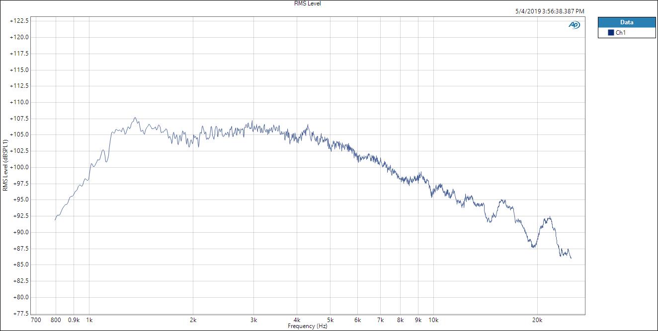

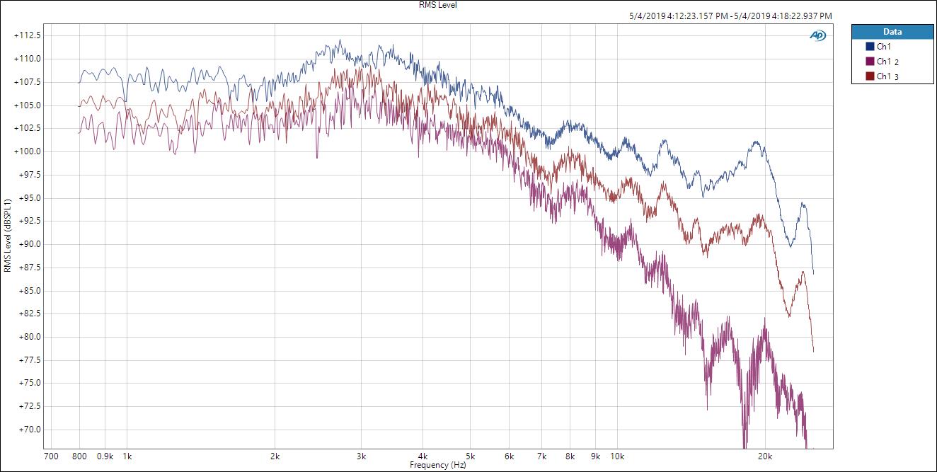

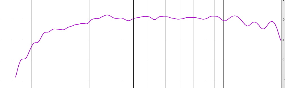

Hello All,
This is the first look at the D2 CD and M2 Waveguide no equalizer and no filtering, on axis, ~ 22.5 degrees Horizontal off axis and ~ 45 degrees Horizontal off axis. I turned up the output a bit to swamp the analyzer’s fan noise. No smoothing.
Thanks DT
Thanks DT
So far, I can't see anything that can't be eqed.
Hello,
No problem; passive, active analog or DSP EQ are all good tools and help flatten out the D2 FR plots. What I see in the plots is the typical -6dB per octave mass break roll-off. I do not see any diaphragm breakup in the D2 plots.
I will sneak up on it with an active 30 band equalizer and active crossover.
Give Mitch credit, a little down the line I will try out the digital solution. The plots that Mitch has posted are like a ruler flat.
I think that this JBL D2 is well capable of 20 KHz and better output.
I believe that Rob is correct 15dB, of boost at 20KHz may be a strain. I am also of the thought that diaphragm breakup if present will contribute to UHF harshness.

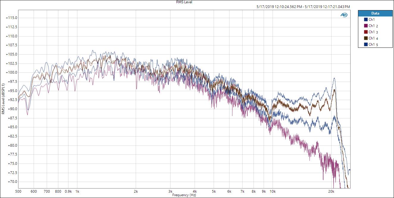

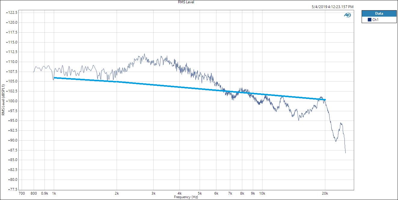

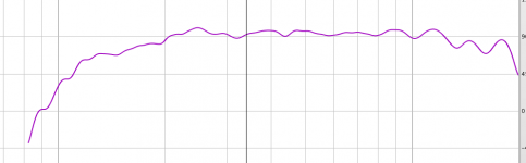

Hello All,
It is interesting looking at and listening to these JBL D2 / M2 CD and waveguides.
There are several options to equalizing these things.
So far I am keeping it active analog. I like listening to old vinyl and do not want to jump just yet into the DSP.
I have taken the CD’s and waveguides out of the lab where I use PPE hearing protection to the listening room where I keep a SPL meter on the table next to me. Thanks Mitch the reference is 83dB SPL.
Using the M2 waveguides and PT H1010HF-1 waveguides with the different; D2, 2432H and 2451J CD’s there is concept taking form. The better I do equalizing the combinations to the target curve, the more they sound the same.
The D2 M2 combination seems to have a more precise soundstage and more natural sounding solo voices and instruments. It is easy to get lost in the music.
The target curve that I am using is downward sloping to to 2KHz at 0.9dB’s per octave and 1.2dB per octave from 2KHz to 20KHz. This target is not too different than the Harmon Curve.
I have plotted the target curve on the D2 M2 Frequency Plot. There is not any extreme EQ being done with the Rane AC23S 30 Band Equalizer. Oh I almost forgot. The AC23S has CD Mass Break roll off compensating bypass capacitors installed on the PCB.

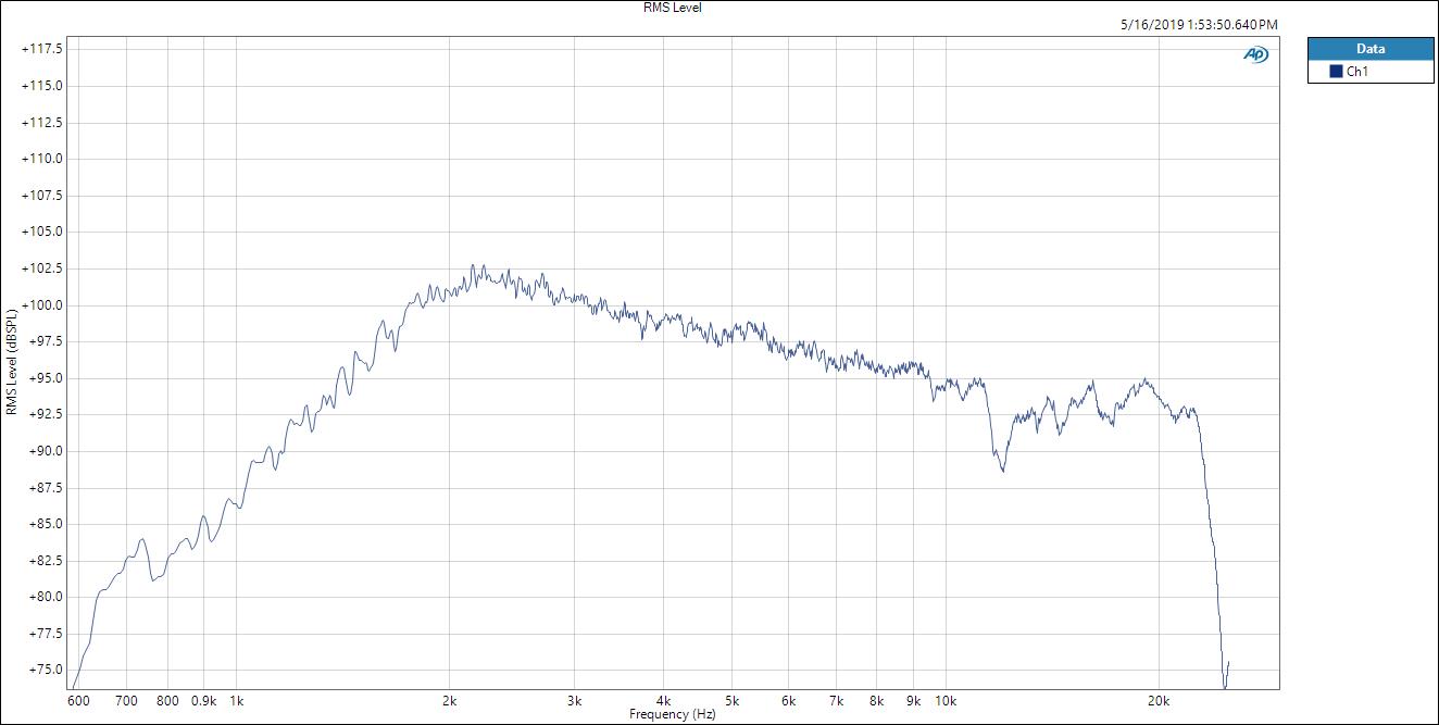

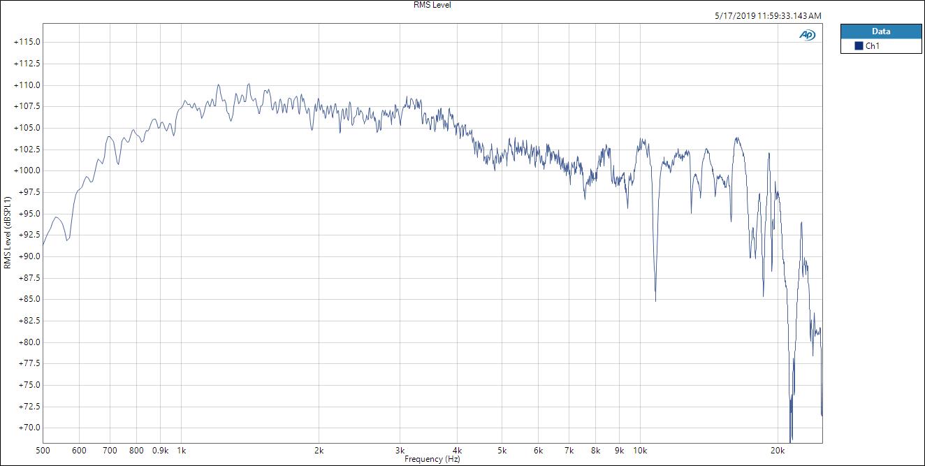

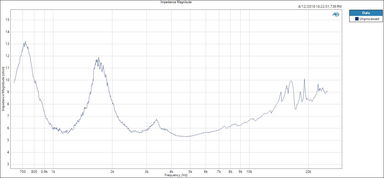

Because someone sent me a PM asking.
I have been crossing over to the PT 1010HF-1 at 2K and above because there is typically a huge ragged acoustic impedance peak right about 1.6KHz. The depth of the waveguide is right at ¼ wavelength at 1.6K. About 4.3 inches. That makes for one huge reflection or family of HOM’s, if you are a believer, centered around 1.6KHz.
A resistor equal in value to the voice coil resistance placed in parallel to the voice coil plus enough series resistance with the parallel resistance will start to tame the impedance peak of the driver/waveguide combination. These days JBL and Crown use a dose of DSP to further tame the phase distortions caused by the impedance peak. (Done in the M2).
Attached are 1010 HF-1 impedance plots with JBL 2432H, JBL2451SL J and D2 drivers. There are also 1010 HF-1 frequency plots with mostly the same drivers.
Thanks DT

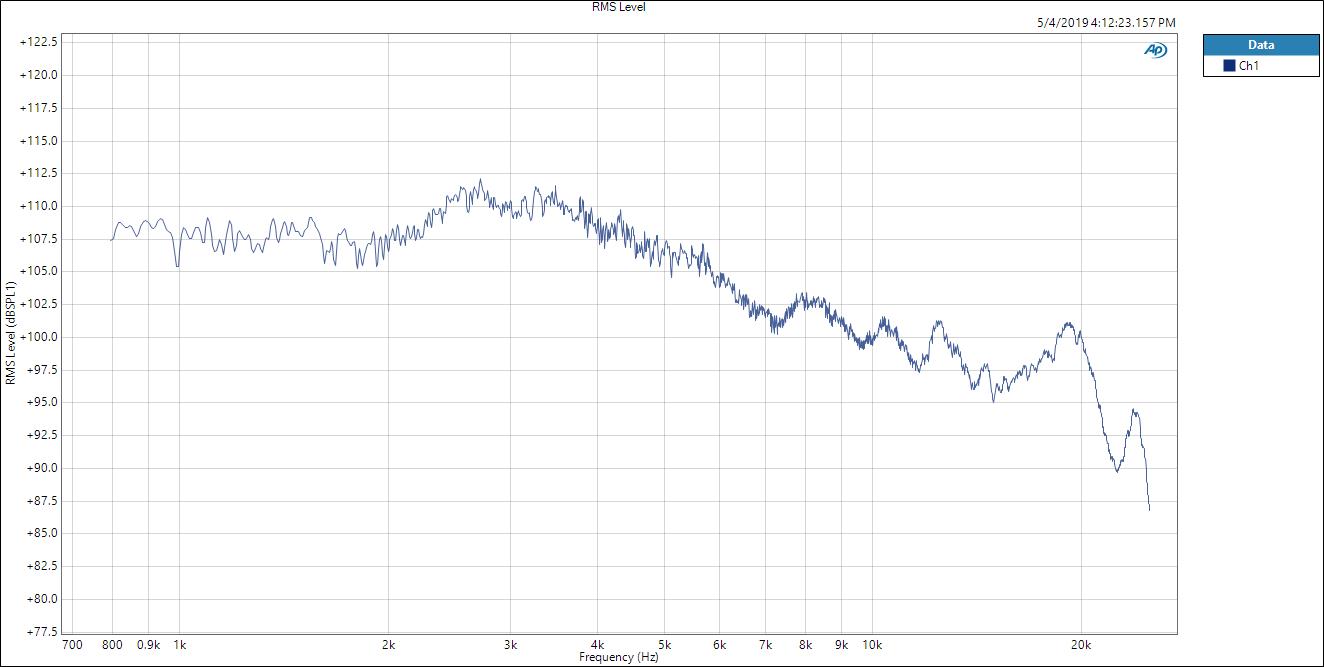

I added the last FR Plot of the PT90 with a JBL2408H2 because I like the looks of it.
Thanks DT

Just because there is a huge Zpeak, it may not be a resonance (showing up on a waterfall or csd).
But others know more.
