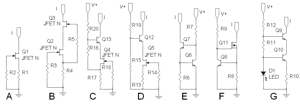

Another solution would be to dump the jfet current source and use something like a ring-of two source instead of the simple jfet current source. This approach is more complex, but conserves jfets (they're getting a bit thin on the ground these days), and eliminates all the matching fol-de-rol. I don't know that there is any advantage to matching the top jfets for VDS, as long as they are in the linear region for the ID that is selected. This can be determined with a simple IDSS test. I used parts left over from my matching session that still had significant VDS at 5ma.

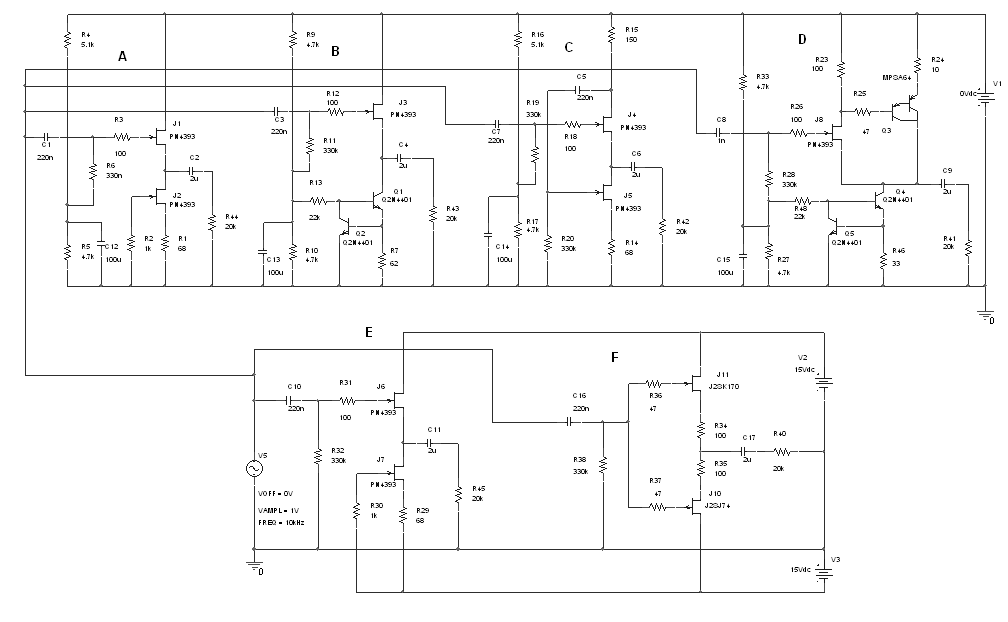

Attached is a menengerie of buffer circuits to play with on sims (got LT Spice?) and on the bench. Circuits A-D are various single supply buffers, while E and F are configured to run on bipolar supplies. Some features can be mixed and matched between the various circuits for even more fun and games. Any one of these would be suitable for the unity gain filter circuits described here. There are more beasts that could possibly be added to the menengerie, but these are ones that have been mentioned here in passing, except for circuit D.

Regarding the menengerie - Circuit "A" is a simple single ended source follower with a jfet current source load, biased for single supply operation, and the one I'm using in the current incarnation of my filter.
"B" is the same thing, but with a ring of two current source, so you can see how it's done.
"C" is the jfet version of the White cathode follower. The value for R15, which determines the drive to the bottom fet J5, is 1/gm, where gm is the transconductance of the bottom fet. For the PN4393, this is around 6-10 umhos, so R15 will be in the region of 100-150 ohms. A fet with higher transconductance like the 2SK170 will require a correspondingly smaller value for R15.
Circuit "D" is a current boosted source follower using an integrated darlington transistor (Q3). The ring of two current source (Q4-5) sets the total current going through J8 and Q3, and R23 apportions the current between J8 and Q3. The ring of two current source is used because jfets capable of linear operation at 20ma are pretty thinn on the ground, and the power dissipation would be too large for a TO-92 device anyway. Transistor Q4 should really be something a bit heftier than the 2N4401 shown in the schematic - a TO-92L package device like the MPSW06 would be suitable, and there are many excellent Japanese driver transistors in this package that would also work well.
Circuit "E" is circuit "A", tricked out for a bipolar supply.
Circuit "F" is a simple complementary buffer. R34 and R35 will probably need to be closer to 47 ohms for "BL" ranked devices.
Circuits A-E, if properly done, clock in at about 0.001% THD, overwhelmingly 2nd harmonic. Circuit F is about 10 times better in simulation, and is pretty well balanced, with about 30-40mV DC offset at the output. I don't know how this will translate to the real world, as the real devices will probably not be as well matched as the PSpice simulation models. Trying something similar in simulation with J176 and PN4393 or (J113 and J176) yields about 0.002% distortion and a lot more offset.
