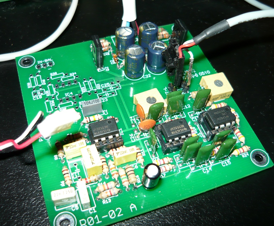

Here's a picture of the new board. It will go inside my new preamp chassis. I'm using SMA RF connectors for ins and outs, and have a central power distribution barrier strip so that I can easily swap functinal blocks. There will be three blocks living inside, all of a standardized size and mounting hole pattern - an RIAA preamp, a lineamp, and an active crossover. I need to get a few more SMA connctors to finish stuffing the board, then I can test.

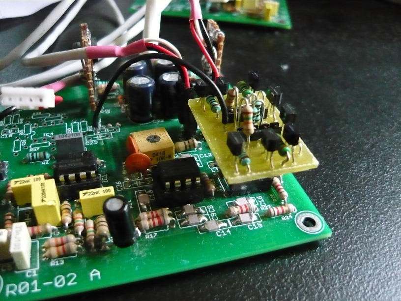

Well, I just put some components on order to produce some plug in veroboards to replace the opamps on my current board, though the space is pretty cramped.
I went with 5LN01N for the MOSFET and 2SA933AS for the BJT. I also put some 2SC1740S's on order for tests between BJT control elements and MOSFETs.
In the meantime when I wait for these components I could probably knock up a BJT version with A1015's and C1815's that I have lying around.
Also one thing I noticed whilst simulating is that even with very small currents running through the MOSFET (essentially BJT level currents) I can still obtain very good THD (~2.0e-6 %) simulations - I'm not sure if I'm missing something regarding how the MOSFET models can be used here. Also I was using the ROHM RUE003N02 model because I can't load the 5LN01 models into TINA-TI :/ I guess it's a hint that I should move to LTSpice.
The new filter is in the last stages of stuffing the board. I don't have a big concern about noise, as I'm running a similar circuit as a lineamp without any problems.

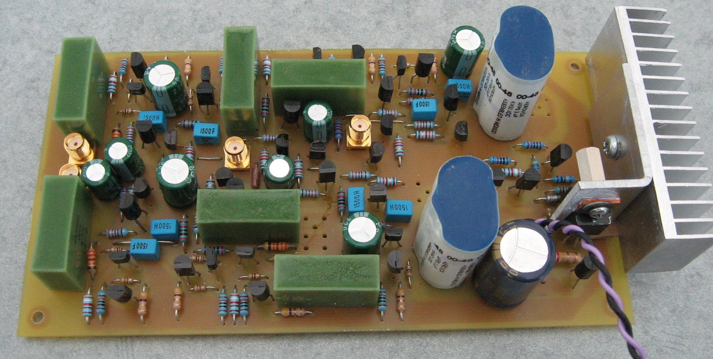

Board is done, connectors installed, and it is waiting to be put in a case with the rest of the modules (RIAA preamp and lineamp). I powered it up, and all the static voltage levels in strategic spots are just fine (a good sign).I just got some 50k "black block" Noble pots for the crossover level controls. All this is being time division multiplexed with life and several other projects.

Yes, Virginia, the crossover makes a difference.... It's not the first time I changed a speaker/crossover and hated my CD player afterwards. This time, it's partially the speaker's fault. I just finished a set of Tri Trix speakers from Parts Express's "Recession Buster" kit. Most of the frustration was finishing the MDF cabinets and figuring out how to do the ins and out for a bi-amped setup. I gave up trying to put lipstick on the pig (MDF cabinets) and used spray-on truck bed liner from Kragen.The result is a pair of speakers that are very black and very functional. They were sharp and shouty with a 5kHz crossover point, making my CD player sound very strident, and painful on crescendos. I looked up the curves on the drivers, and there's a big fat peak at 5kHz on the Dayton 5 1/4" mid-woofs. The crossover point for the passive crossovers designed for these speakers looks to be set to ~1.5kHz to take advantage of the extended tweeter response, and to knock down that peak. I took apart the jfet crossover today and reset things accordingly (30.9k resistors and 3n3 capacitors), and the speakers are quite different now, definitely less strident. I will chime in again after some more listening.
BTW -these observations are all using the first crossover circuit I posted using 2 X PN4393 employed in current source loaded source followers for each stage (2 follower stages for each filter element - input buffer, then actual filter). With a couple of value changes, J310s would probably work just as well (widely available on E-pay...). The second filter hasn't been aired yet - it's sitting patiently in the basement waiting to be fitted with a case and power supply..

I don't really want to taint wrenchone's thread with my budget discrete efforts, but if you want to do comparisons you can simply do what I've done and build the op-amp version of the crossover and then make discrete plug-in buffers to compare.
Of course this only works for replacing non-inverting op-amp stages and you need to add DC blocking in some areas, but most of the ones on for example Rod Elliot's board are non-inverting (e.g all the filter stages and the output buffers - the input buffer could easily enough be noninverting if you didn't use his balanced input scheme)
P.S. This is what I ended up doing with my board on the last page - the 5LN01SP's turned out to be pretty good listening to them, though I have no measurements yet.
