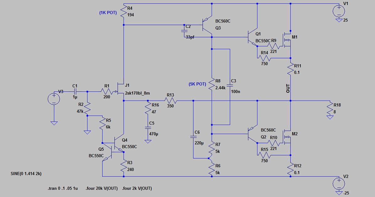

Quasi Version
Someone wanted a quasi version, so I'm having a go....need to pass the time while I wait for the parts!
Sims quite well, even with vertical fets (IRFP240) and very cheap transistors. Some resistor values may need tweaking though. Also there is some potential for themal runaway if the driver transistors get hot. Not sure if that needs to be dealt with or not.

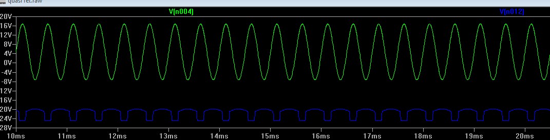

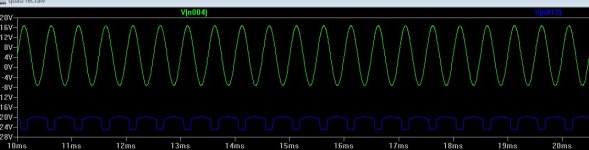

Why are my gate drive waveforms so strange though (top fet gate is top trace, bottom fet gate is bottom trace)?
The beauty of this circuit (if it can be made to work) is that only the main fets need heatsinking. Every other active device has a very easy job and cheap signal transistors can be used.
Current through input stage and VAS can be significantly reduced due to high gain devices at gates of fet (though you are encouraged to experiment).
Even with bootstrap VAS and my weird gate waveforms, simulated distortion is very low and all even order.
This is the first quasi circuit I have tried so I look forward to your help getting it sorted. It's potentially a very easy circuit to build.

You feed the Gates only ~2mA
For big vertikal HEXFET this is on the low side.
I want at least 10mA (or 20mA)
There is a charge current needed into those gates.
This is why driving them in Class A when there is a Gate current all the time
is a good way to get HEXFET to operate.
Say the momentarily gate takes 1mA just for charging.
There will not be a very smooth turning on.
This gives a strange waveform and increased distortion.
Why you do not get so high distortion
is because of effective Feedback correction.

Yes, I think that transistor would work, though it might be overkill for the purpose. You will need to tweak the input and vas stage current to suit it.
However, before constructing we need to identify the problems lineup mentioned in post #189. One improvement is to increase R14 and R15 to force more of the transistor output into the fet gate, but then the gate discharge is impeded. A careful compromise is needed.
Lineup, any thoughts on how to improve this? Also, can you please explain how you determined the gate current is limited to 2mA?
Thanks,
Greg.

In swordfishy Quasi circuit Q1 and Q2 runs at 5 mA (4V/750 Ohm)
This is better than 2mA, but I would like to make it 10mA.
We can change R14/R15 to 470 Ohm.
This makes more current pass the need of the Gate.
This is for HEXFETs like IRFP240/IRFP9240
For laterals the circuit should be okay, as it is.
I say swordfishys circuit is good enough.
Nothing wrong I can find.
