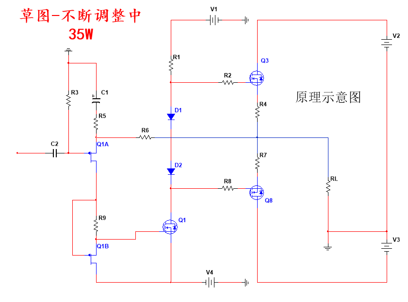

Hi Hugh,
Please re-read carefully
This is not an accurate simulation for the reasons previously stated and restated below.
"Here is the somewhat simplified schematic that shows more or less what I'm listening to at present. Please ignore the actual parts - I switched to LT spice a while back and am finding it almost impossible to import parts - perhaps coz I'm running W7 on a MacBook - so I just use whatever parts are in the box to get an idea of what is going on. My output devices are still buffered lateral mosfets."
I used to believe that simple designs were the best designs but now, based on my own experience, I make my designs as simple as possible but as complicated as necessary to achieve a performance that sounds accurate and is not hard on the ears.
I think comparing this new input arrangement with a simple Jfet may be a classic example of how conventional measurement techniques don't get to the real significance of what is changing.

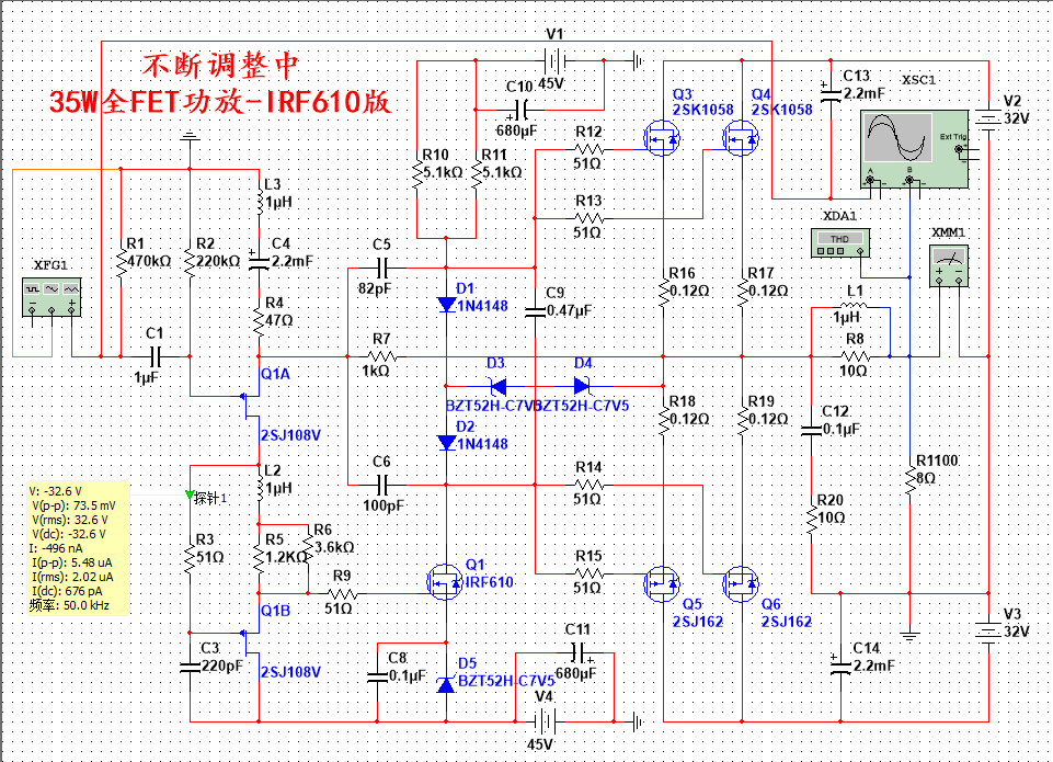

Lineup,
could you add in an index to post1, of up to date sch & bom & PCB source etc, for new readers and us oldies that forget?
In this particular thread this is not really possible because the final consensus about this design has morphed away quite a bit from the idea in the first post.
I strongly support the unchanged buffered Q2 VAS though I'm not quite sure why you put in D1.
adding D1 enables a higher value 1st stage load resistor and gives more gain

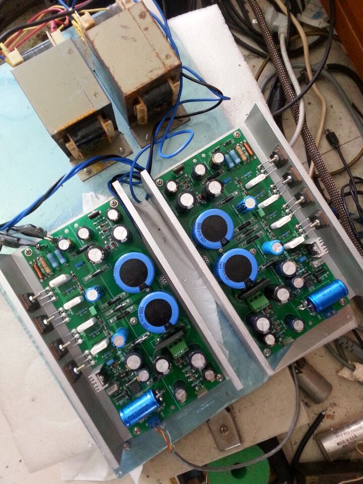

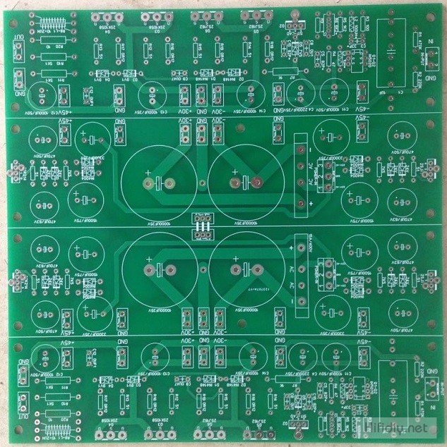

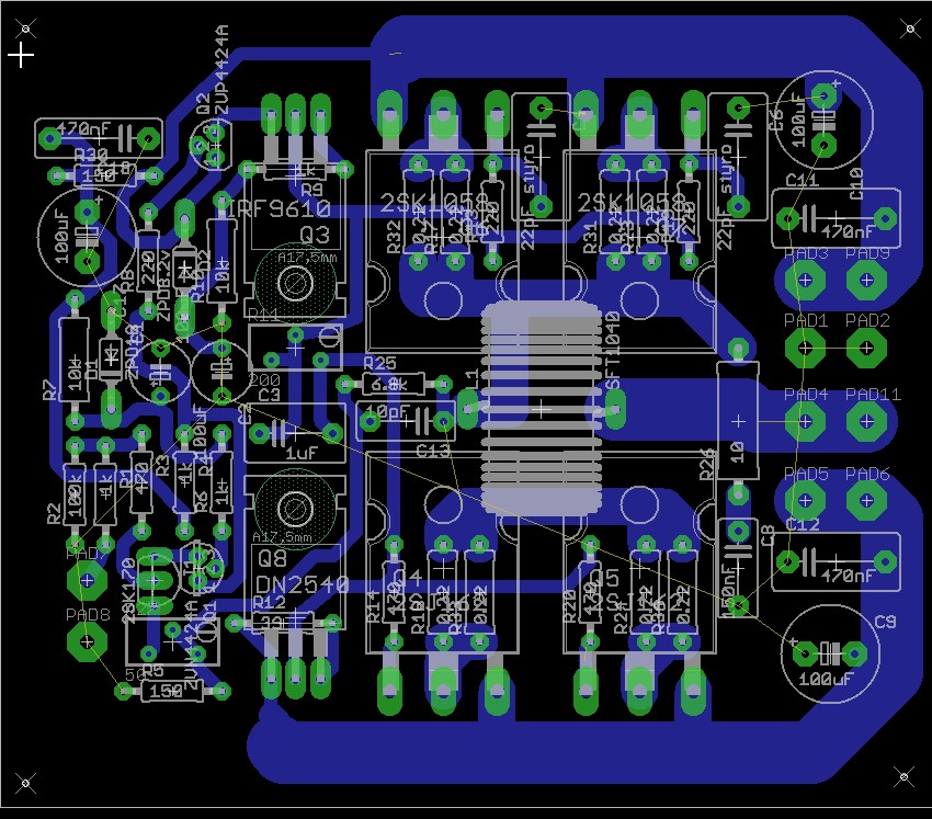

I have no idea what posts have the circuit and PCB, BOM to the actually final stuff.Lineup,
If somebody knows I would add an index in post #1.
Maybe in the forum of AKSA, there is all we should know?
Have o look here and look for FETZILLA: AKSA - diyAudio

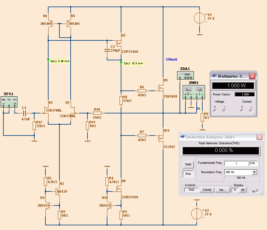

do you have any idea about which simulation software has been used ?

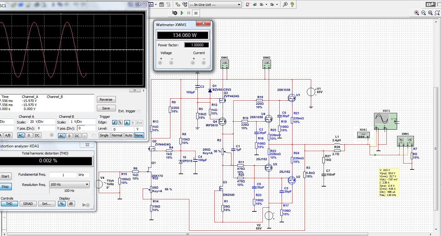

Here a new take on JFET input, MOSFET vas and MOSFET output.
It does 48 Watt RMS before clipping in Class AB (bias is 200mA).
The only bipolar are the drivers: 2SC2911/2SA1209
I use them drivers to get 12 mA onto gates of IRFP240.
Power supply are trafos 2x24 VAC, 200VA for +/-35 Volt rails.
One trafo for each channel.
To setup you need to seek a resistance R8 that give ~5 mA through your JFET 2SK170BL at 35 Volt
Then chose feedback resistor R9 for gain like x20
After this you can adjust R1 (632 Ohm) for zero at output.
Then adjust R4 (4.95 kOhm) for 200 mA in the output devices.
Performance.
THD at 1 kHz is low.
0.0008% at 1 Watt
0.0060% at 42 Watt
The good thing is that 2nd harmonic is very dominant at all levels.
The sound is probably very MOSFETish!
Enjoy![]()
would like to know the name of simulation software which you have used to create this schematic .
I did use multisim.

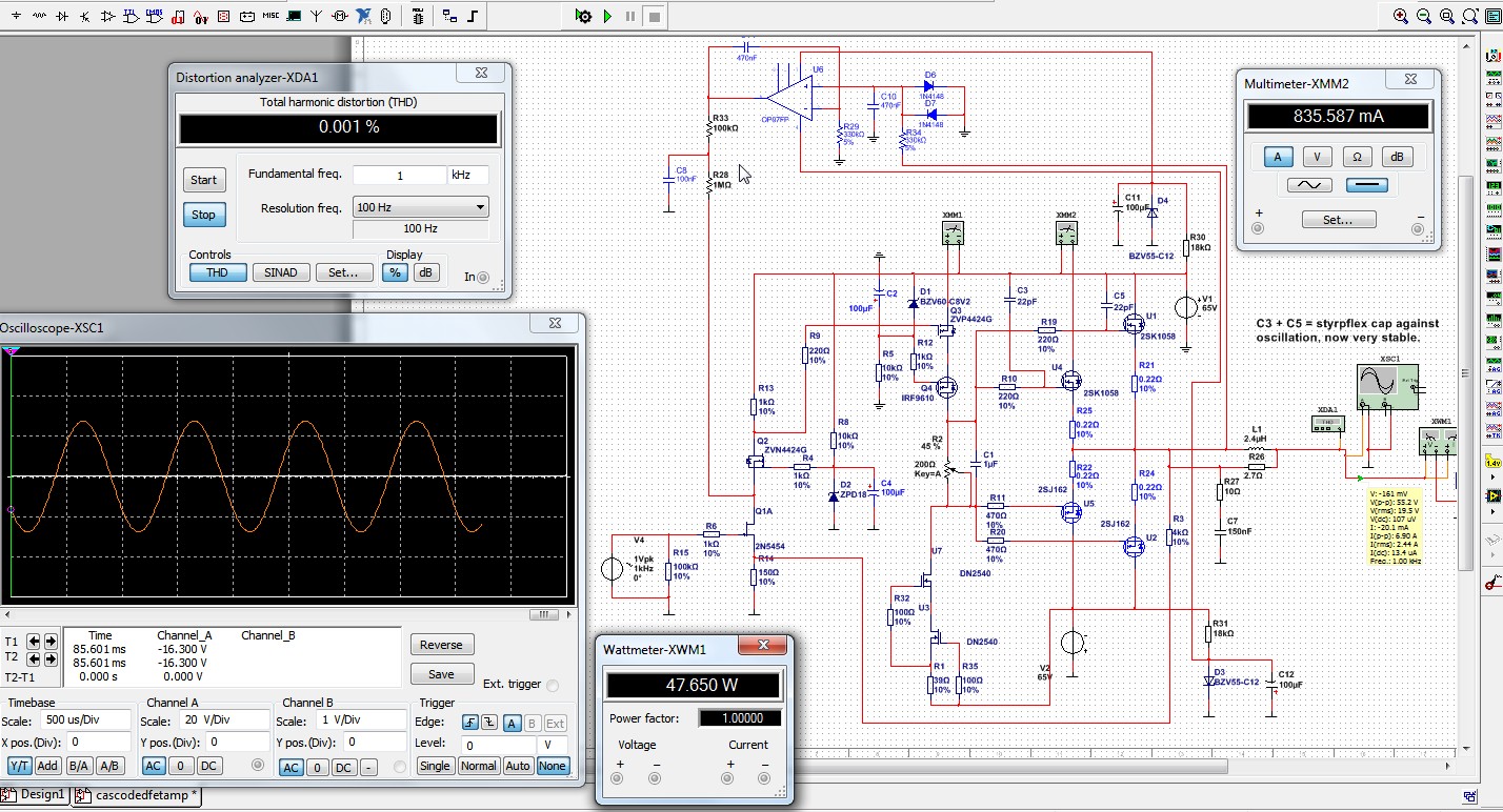

This is the most perfect amplifier I have spiced.
It is simple but yet very, very good.
- JFET input with minimal offset problems.
- MOSFET VAS for speed and gain
- LATERAL output for be a light load to VAS
When CLass AB operation, 350mA bias, it shows only
THD 0.00018% at 1 Watt
And there is almost no increase of THD at 25 Watt output
Enjoy!!
EDIT:
For more building the final stuff and details, look for FETZILLA
in this AKSA forum: AKSA - diyAudio

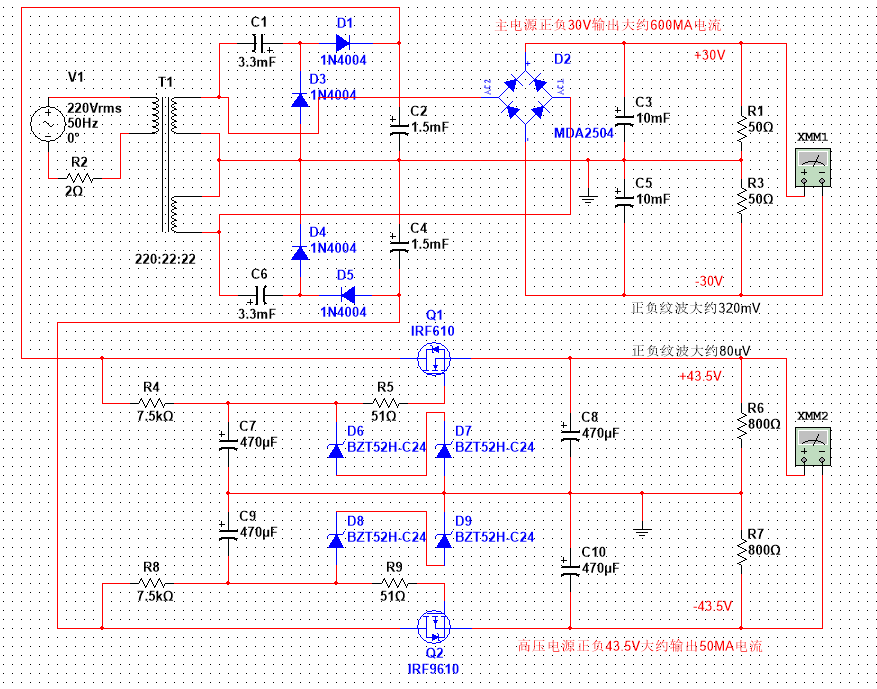

Can we use this like a preamp with +/-20V with IRF610 and IRF9610 in output and a hexfet based Vbe Multiplier?
Poor 2sk1058 mosfet, he wil glow red

Dear all,
please look at having a gate resistor for the Vas MOSFET instead of the Band limiting C2-Capacitor. The overall stability pole is better employed at the input LTP pair.
This all best done by simulating Circuit in OL-Open loop response mode.
Just me humble '2-cents suggestions'...
Best 4 it
a1gd
Best 4 it
a1gd
Good idea having a gate stopper resistor onto MOSFET U7.Dear all,
Best 4 it
a1gd
Capacitor should only be used as the final choice.
Because they are un-linear.
Better use the input capacitance in the MOSFET together with Resistor to shape the circuit behavior.

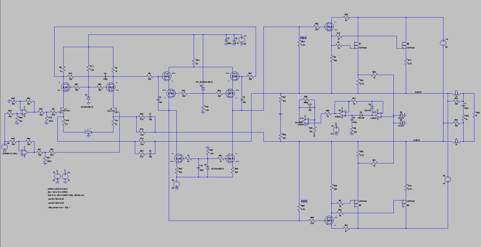

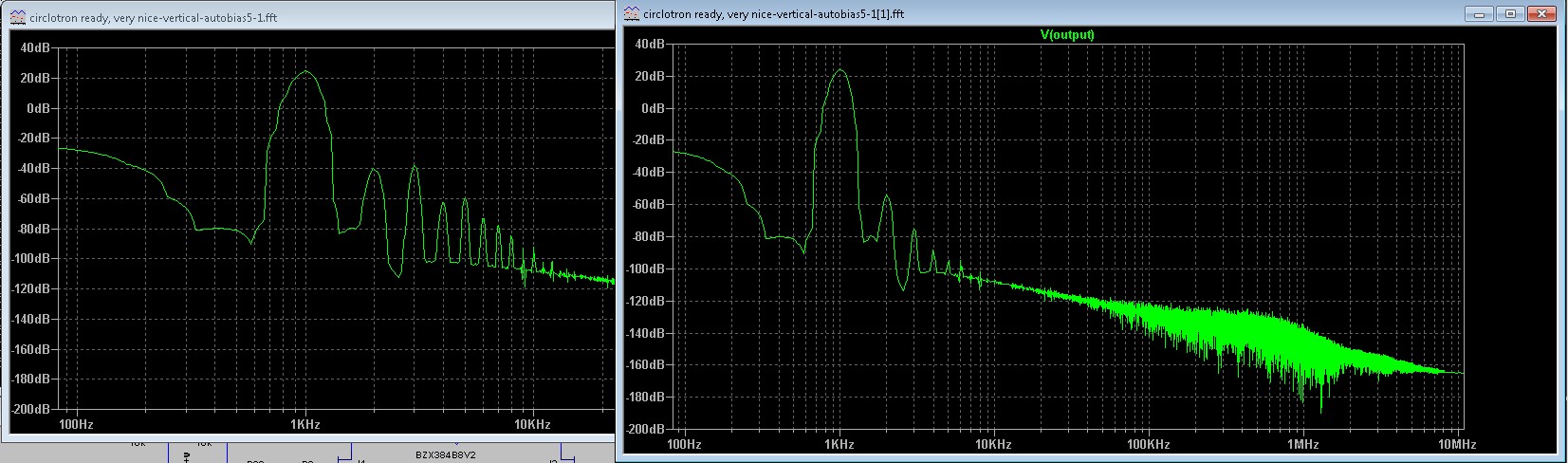

This is a time back? I am busy with a circlotron with mosfet vas, can you guys take a look? I have low output distortion, but it does have high distortion on the vas side and even more on the long tail pair input.
Maybe I did something wrong, or can do better.
I have use the phillips bsp225 types, have 2 volts gate on voltage. I have 65 + 65 supply on prestage because it needs 16 volts above circlotron output, maybe the cascode vas has high impedance and can not drive output well.
Practice is not problem for me, but the dieper knowledge is, I never had school for electronics, I did learn on mine own, en still see new things, class D is not a problem for me.
thanks in advance.
