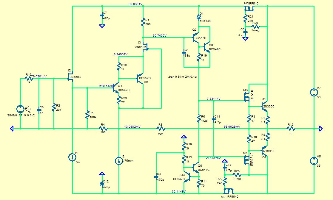

So I decided to try a CFP cascoded with a Jfet as the i/p transistor of my DC linked fetzilla. This means I can no longer call it a fetzilla ! and technically it no longer falls within the remit of this thread. Never-the-less I though I would post an update here as it may be of interest to all the fetzilla enthusiasts here.
There is one technical problem with adding this cascoded CFP - it introduces a 0.63V offset compared with the Jfet and this needs to be addressed. However my amps already had a Jfet follower driver stage so I changed to a higher IDSS Jfet here to give me a 0.63V offset feeding into the new compound i/p device - the servo took care of any minor anomalies.
I don't want to appear too over enthusiastic but in the context of this design, this is a very significant modification. Here are the main subjective changes:
The amps now sounds like it has more effortless power particularly in the bass which now sounds much deeper & fuller. The effect of this when listening to music is that instruments like saxophones sound fatter and more rounded - more like real instruments.
The other main area of improvement is low level detail which improved dramatically - and this is the good kind of unexagerated detail that just makes everything sound natural & realistic.
Sound staging is also improved.
From my limited theoretical understanding I think this cascoded compound FB pair comes close to being an ideal transistor and I am begining to think that the reason many transistor amps with global FB do not sound as natural as amps without, may be because the devices used to mastermind the operation of the feedback most often are not ideal enough.
So all in all I think this is a very significant mod.

Hi Hugh,
I think out of all the threads I joined in this forum, this one was the one that seemed most in the spirit of friendly, open minded co-operation and positive lively debate. Many thanks for all your input. Happy to be chatting here again.
Here is the somewhat simplified schematic that shows more or less what I'm listening to at present. Please ignore the actual parts - I switched to LT spice a while back and am finding it almost impossible to import parts - perhaps coz I'm running W7 on a MacBook - so I just use whatever parts are in the box to get an idea of what is going on. My output devices are still buffered lateral mosfets.
I2 is in fact a servo controlled variable CCS.

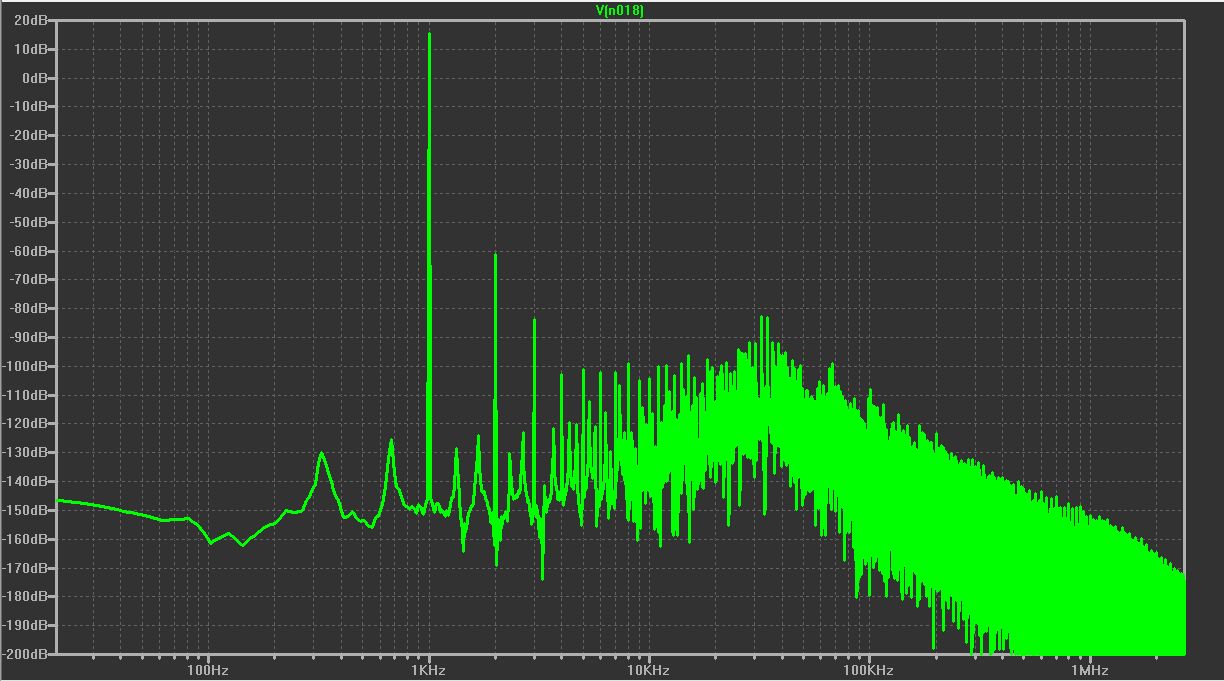

Hi Lineup,
good to see you and thx for starting this great thread.
Interestingly, your original idea was inspired by a good measured performance in spice from a simple circuit.
However, I am not aware that this new mod brings any obvious change in measured performance but subjectively the sound has changed significantly.
It now has a full bodied, warm sound that many solid state designs lack when compared to a good valve design.
When I listen to real acoustic instruments close up ( thx to all those buskers ) that warm, full bodied sound is what I hear.
Thank you Mike, Lineup,
You are great guys, and wonderful community people. Generally, the truly objectionable behaviour comes from the very clever people who know more than everyone else; not with you guys....... a credit to your restraint and temperament.
Now, Mike your amp is HUGELY different. Let me count the ways:
1. jfet source follower with CCS buffer driving not just a singleton, but a CFP master running at only 650uA! To me, I must admit it's like wearing three pairs of socks.......
2. A CFP singleton input stage with constant power cascade. (Q4, Q6 and J3). I did some sims on this and replacing the singleton with a CFP singleton, albeit without the cascode, delivered NO improvement on distortion, I found it was around the same THD figure, no more, and normally a jfet is cascaded by a bipolar to get around the Vds issues. This is reversed; it seems topsy turvy to me.
3. I strongly support the unchanged buffered Q2 VAS though I'm not quite sure why you put in D1. A great idea from Graham Maynard about 15 years back, and very clever and we know works very well. Linear amplification with very low Zout.
4. No bootstrap, Mike? Tsk tsk....... I love 'em, they improve the human voice and the ratio of the resistors can profile the harmonics too. Very helpful, and very reliable.
5. Complementary mosfet master/bipolar slave double emitter OPS? WOW!! It is so reversed over the usual approach that I would expect it would sound very difficult.
Finally, this is not to pooh pooh your circuit. You say it sounds wonderful, BUT, I count off 14 semiconductors, including series cap multipliers, and in fact there is no inclusion of thermal bias control. The profile in post #2357 indicates falling H2, H3 and H4, but rising H5 and beyond..... not the Hiraga profile I seek and which can be manipulated nicely in the FetZilla...... HOWEVER, subjective rule, OK? If this sounds better than the bog standard Fet, then we need to take note. BUT, I don't like the semi count, too many bits!
Thanks Mike..... You have taken a Crewe V8 and turned it into the new 4 litre DOHC twin turbo.....
Hugh
