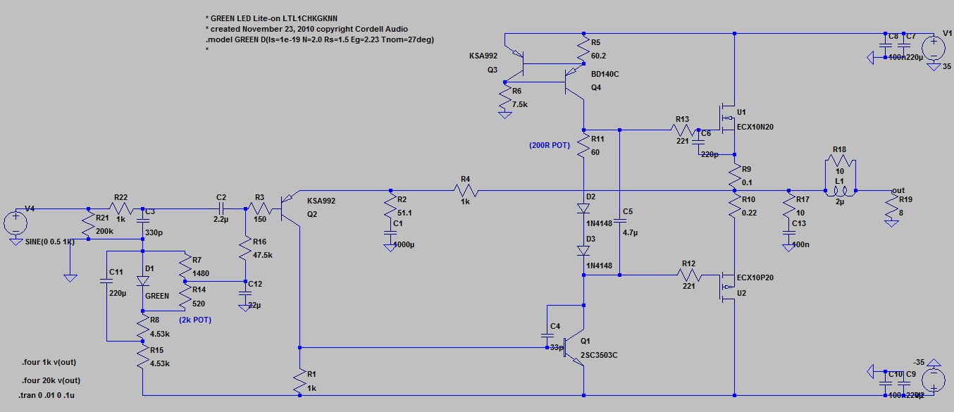

BJTzilla
Hi All,
Here is the schematic as promised.
Starting from the front:
1) KSA992 low noise, high gain BJT input being biased by highly filtered LED voltage source.
2) Low capacitance CRT driver BJT VAS designed to be linear with high voltage/current swings (thanks Hugh).
3) Simple dual BJT VAS CCS. BD140 was chosen to keep it a bit slow and "doughy" to ensure stability without resorting to base stoppers. Current fixed at about 10-11mA. I experimented with a bootstrap here but ultimately preferred the sound of the bjt ccs.
4) Lateral fet output stage with asymmetric source resistors. This actually reduces distortion by matching the gain of the fets (see Cordell's book for more info). The difference is audible and sounds good!
How does it sound? Well, it's definitely not as engaging as a pure fet fetzilla, but it's a very honest amplifier. It is not as sterile sounding as the distortion spectrum might suggest. In fact, I question the spice profile given that it has both a single ended input and VAS. It is clean and sharp but still definitely more musical than most. Plenty of air around voices and lots of deep detailed bass. Clean treble. More musically capable than the fet version I would say.
In a pinch it can be made with BC560 and BD139 transistors and still sound quite good.

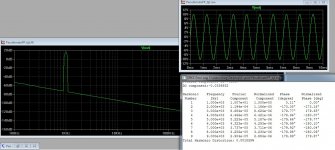

![up :up: :up:](https://files.diyaudio.com/forums/images/smilies/up.gif)
Hi!
I think that your sim settings in LT spice are incorrect,
you should have visible peaks of the harmonics.
- JFET input, MOSFET VAS, LATERAL output = Perfect!!
