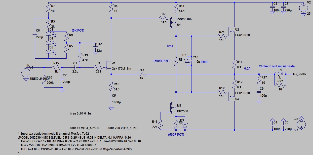

Current working Diagram
The DC drift is definetly better with the i/p stage CCS fitted.
I think I could adjust it to stay within +&- 50mV ( excluding the 1st 60 seconds )
If I stay with this design I would add a DC servo - it gives more design flexibility.
To improve the drift look at temperature compensating the ccs feeding the vas.
As to stability these type amps perform better using only lead compensation, with BJT vas anyway although I dont see why it wouldnt be the same with mosfets. Look at Mooly s amp as an example.

Hi Mike, all,
I'm looking to build a DC version of this amp, and have a couple of questions. First how critical is the current through the input transistor? Would it be possible to make a CCS that has an inverse tempco to the JFET, stabilizing DC drift? Also, how does one adjust offset?

Well, as you may have noticed I have replaced the i/p stage resistor with a 2sk170 based CCS. This does help to stabilize the DC drift but whether or not that will be low enough to satsify you I'm not sure.
Also this arrangement does significantly increase the OLG in the audio band which changes the sound - to my ears that change is for the better. At frequencies where stability issue arise the OLG is unchanged so compensation can be left unchanged - perhaps with a minimum of 10pF - I think 30pF sounds best
To change the offset the CCS value can be adjusted with a trimmer. . . .
However, my ultimate version of this amp will probably end up having a very carefully implemented DC servo but NOT because I am unduly worried about the DC offset levels. . . .
In the development of this design I gradually changed over from standard metal film resistors to Caddock TF020 or MK132's. Each upgraded resistor brought a noticeable change in audio quality and significantly even more of a change was heard when trimmers were replaced with these high quality fixed value resistors.
To enable me to entirely eliminate trimmers from the "Audioband" part of the circuit I am planning to consign my DC offset trimmer to the servo circuit which will operate well below the audio band thus, I hope, making it sonically invisible.

Thanks, that's helpful Mike. I'll build it with a trimmer in the CCS. I guess the high OLG version sounds cleaner and less "romantic", hopefully it doesn't lose the charm.
Earlier you said that you had to use a particular earthing arrangement, could you say more about that? This is my first veroboard amp, so I'm having to work out these details as best I can.
Yeah - very clean and quite romantic - that's a good description :)
I make every effort to keep the earth as clean as possible. As the earth is common throughout the system these measures have to be applied everywhere to gain maximum effect. I use differential & common mode chokes on all of my supplies to achieve this.

These seem to be readily available laterals. Your first circuit modelled as very nice performance.
A bit late to the party, but,
I put the Exicons in my Hafler 120. It took quite a bit of work to get it stable. Basically totally redoing the compensation. ( VAS loading to TMC) The model is higher distortion than the Hitachi model, but I don't know reality yet. The Exicon's are faster had have half the gate capacitance.
I spent the last week playing with ccs models. ( about 20 typologies) The basic BJT-LED is darn good. A really fast FET is more linear. Fet-cascode stiffer. The FBP seems popular in VAS, It is also pretty linear but not as stiff. Those three seem to better all the other typologies.
My basic conclusion is the most important factor is the actual transistor. It has to be very fast. RF fast. Models lie a lot, if you even have them. I will be ordering a pile of faster transistors for test. After 40 years, someone has bound to better the 2N5551!
