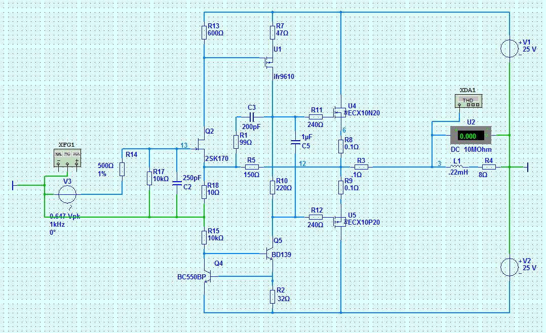

Iv'e been investigating what factors influence achieving low broadband HD and I think Swordfishy should be awarded a prize for extreme accurate hearing.
Here are my broad findings
To achieve very low level HD across the whole spectrum 2K - 40K these seem to be the keys points.
1) Bias the o/p stage to about 1amp
2) Bias the VAS to about 20mA
3) Bias the i/p stage to about 8mA ( by reducing the size of the FB resistors to about 10 & 150 ohms ) This increases OLG to over 100dB - which from SWF's comments is the sound he likes. 25 & 375 is also good.
100 & 1500 ohms gives OLG just over 90dB still nice but more HD, more relaxed, more stable - probably a matter of preference
That's it !
There are other methods that MiiB is following but it seems we can have a very simple cct and very low broadband HD.
My testing was only done in a DC linked cct so adjustments may need to be made - but I feel sure the principals remain sound.
All my tests were done at 10V peak which is as loud as I tend to go.
here is the circuit

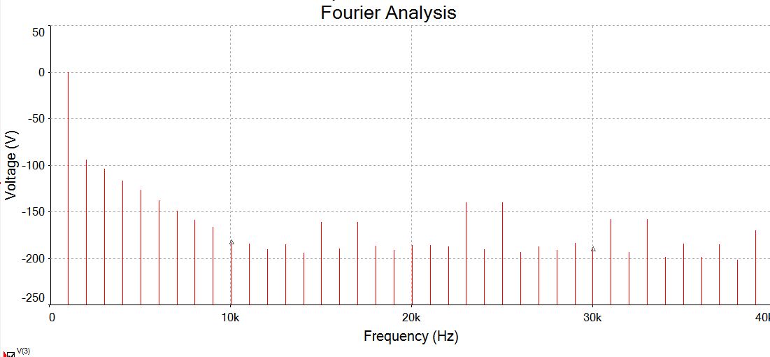

. . . and here is the Fourier.
I don't necessarily trust the figures absolutely but I do tend to trust the trends that spice indicates, and all of the measures I list above had a significant effect on lowering the HD noise floor.
I cannot imagine wanting better performance than this:
You did not remove the emitter resistor of IRF9610. 47 Ohm
I think this would lower THD a little bit.
I see you use 200pF-99 Ohm for compensation. From VAS to source of 2SK170
This is certainly needed when we go for highest OLG
Do you think is necessary with 0.1 Ohm resistors in output?
Well, your circuit is surely close to ultimate Fetzilla.
Is for those who want low THD distortion amp.
The compensation cap may inreality need to be increased somewhat.
I did see this happen with Danspy's amplifier.
My sim gave one cap value, but i reality was 4 times higher.
The next challenge, Gentlemen, is to remove switch on transients.
This is a tough one..... presently there is about a +7.5V spike at turn on which is unacceptable.

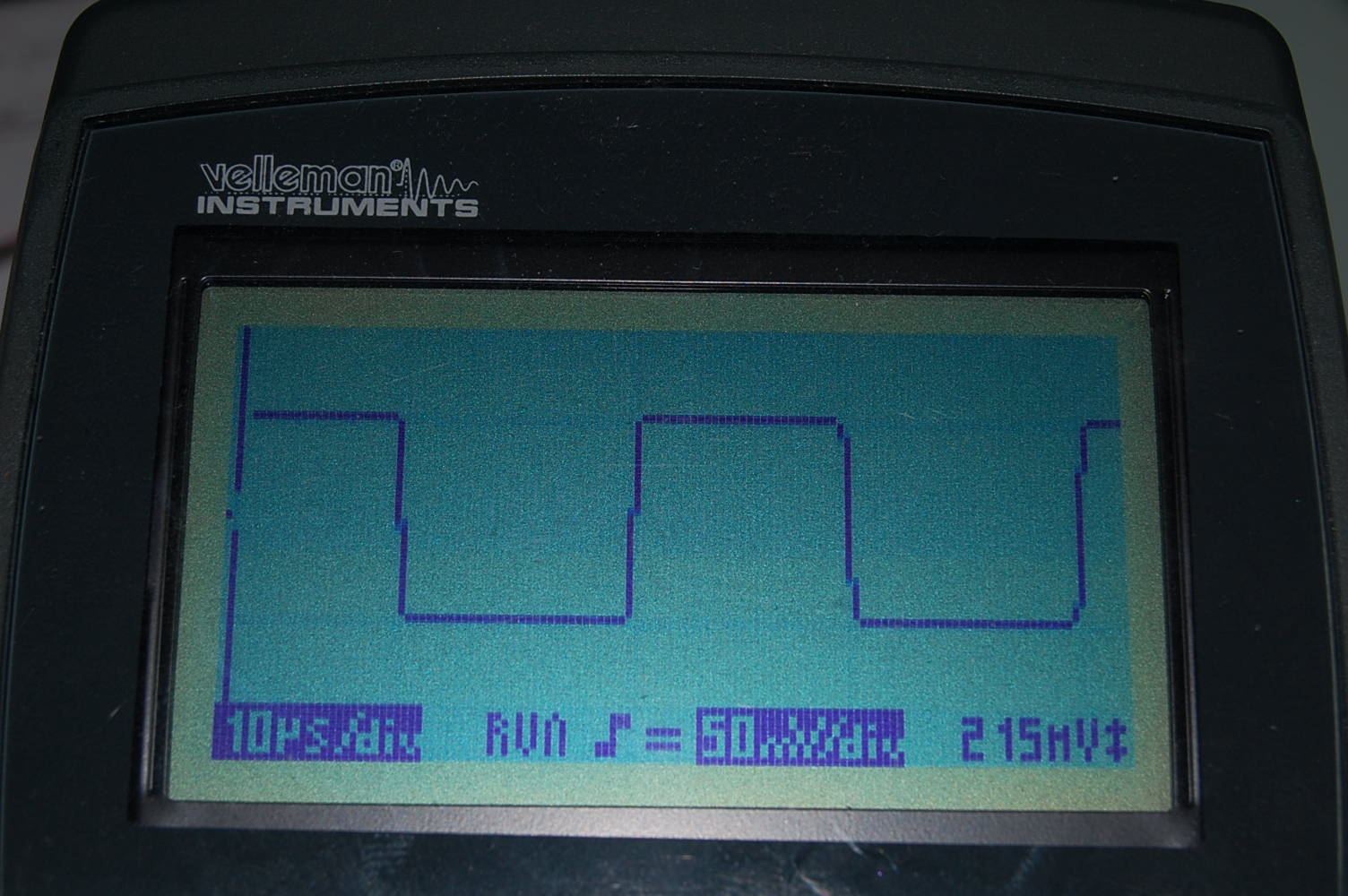

3) Here's a shot of how the amp clips, for general interest.

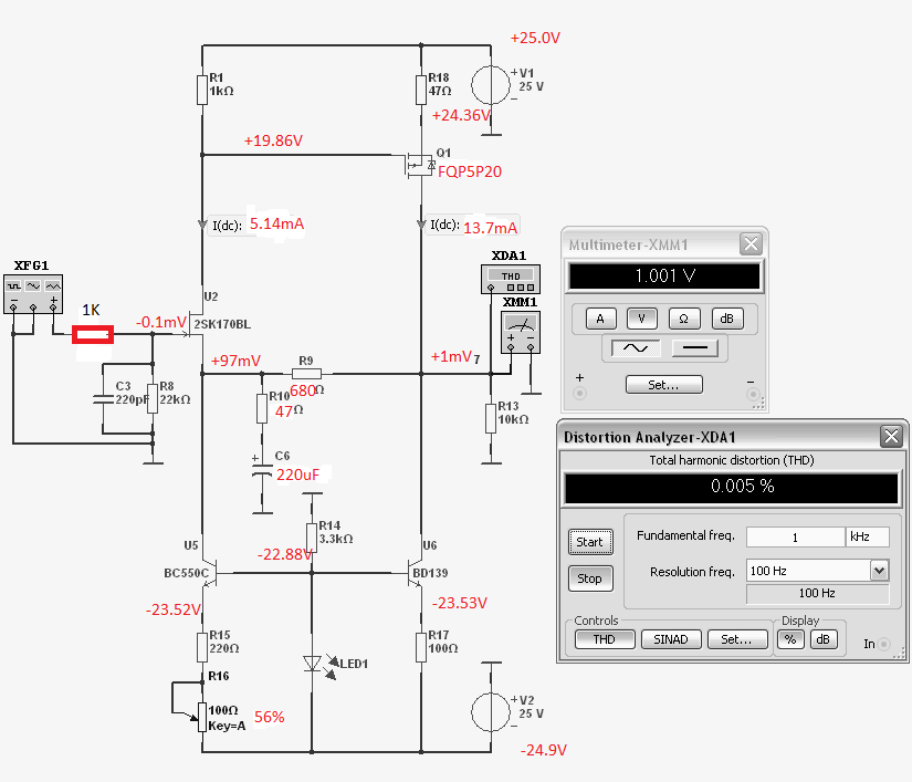

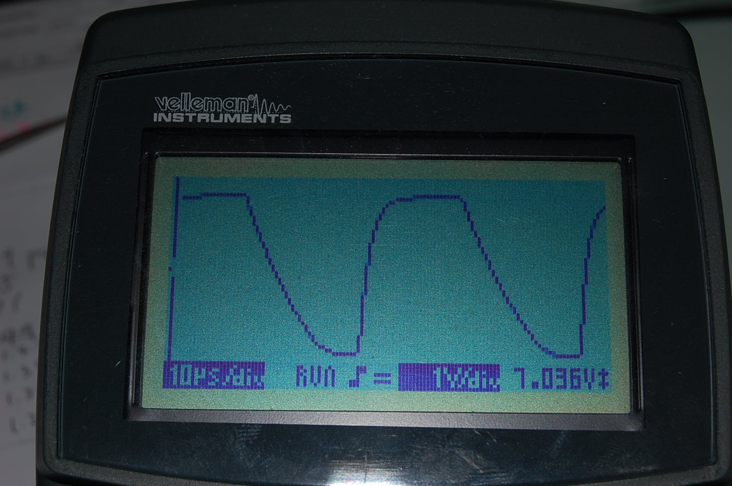

Some experiments with different MOSFET
Hi all,
I build the lineup's recommended version of Fetzilla, with some minor changes (pic.1).
First at all, I ordered the IRF9610 but I have not got it yet.

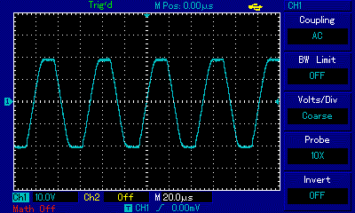

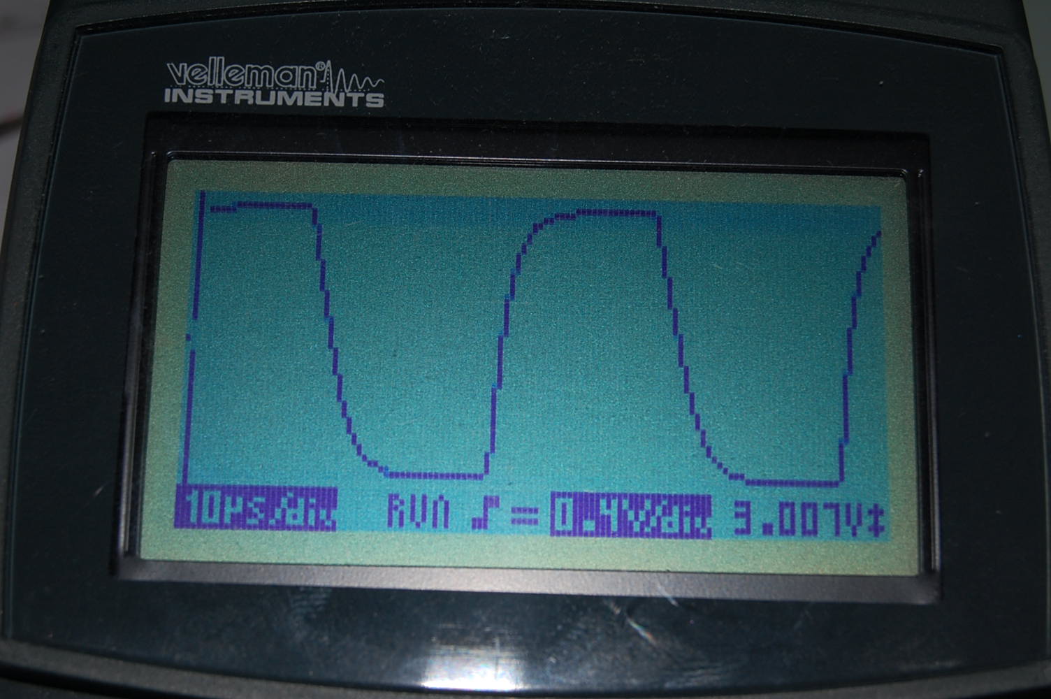

Whilst I am waiting for the parts, I tried the IRF4905 (-55V/74A/Ciss=3400pF), the result was pretty poor with the 18.5kHz square wave. (pic.2).
I then tried FQP5P20 (-200V/4.8A/Ciss=330pF), it improved the rise time a bit.
Source (pic.3); Output@3V-pp (pic.4) & Output@7V-pp (pic.5).
Hopefully the IRF9610 (-200V/1.8A/Ciss=170pF) will improve the rise time.
Cheers, Stanley
