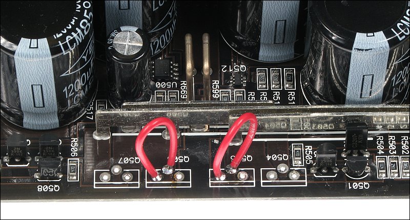

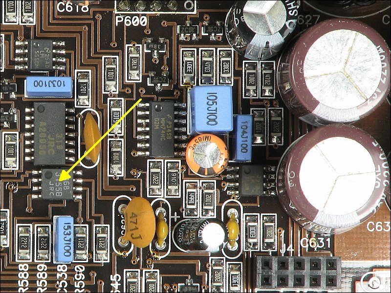

With the outputs out of the amp, solder a bridge across terminals 1 and 2 of the op-amp in the photo.
Install jumpers as shown.
Does that give you the drive you expect?

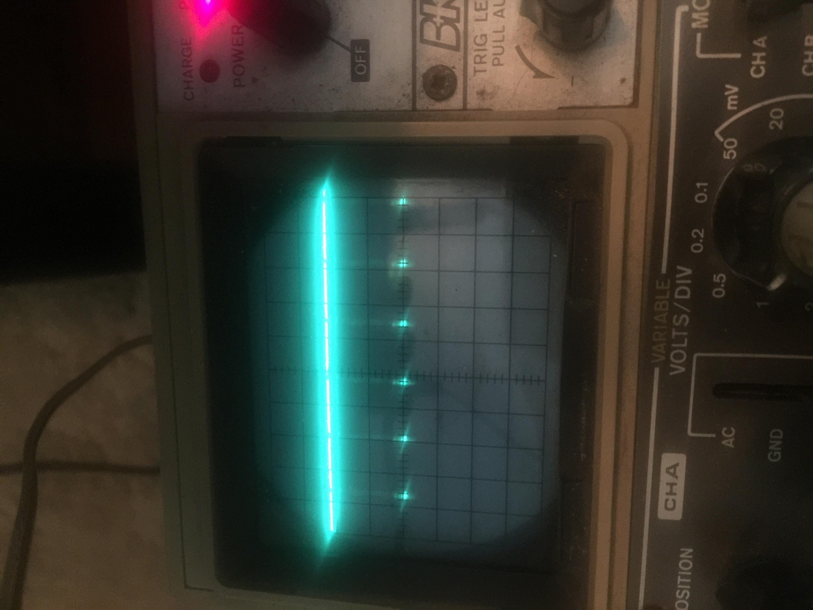

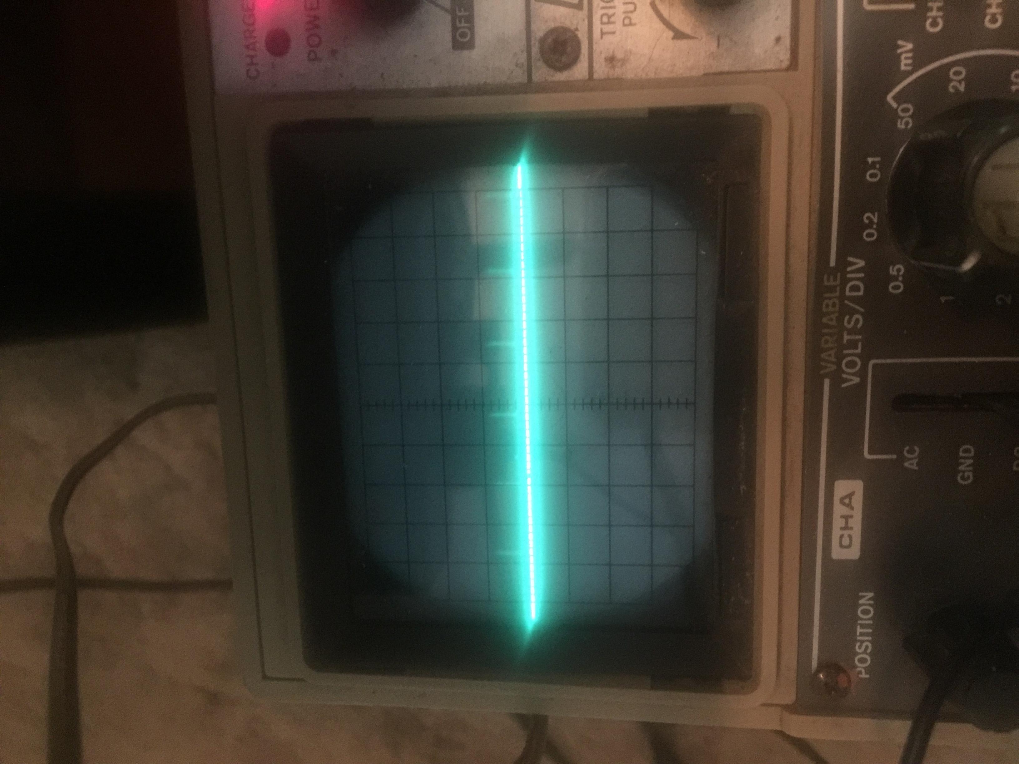

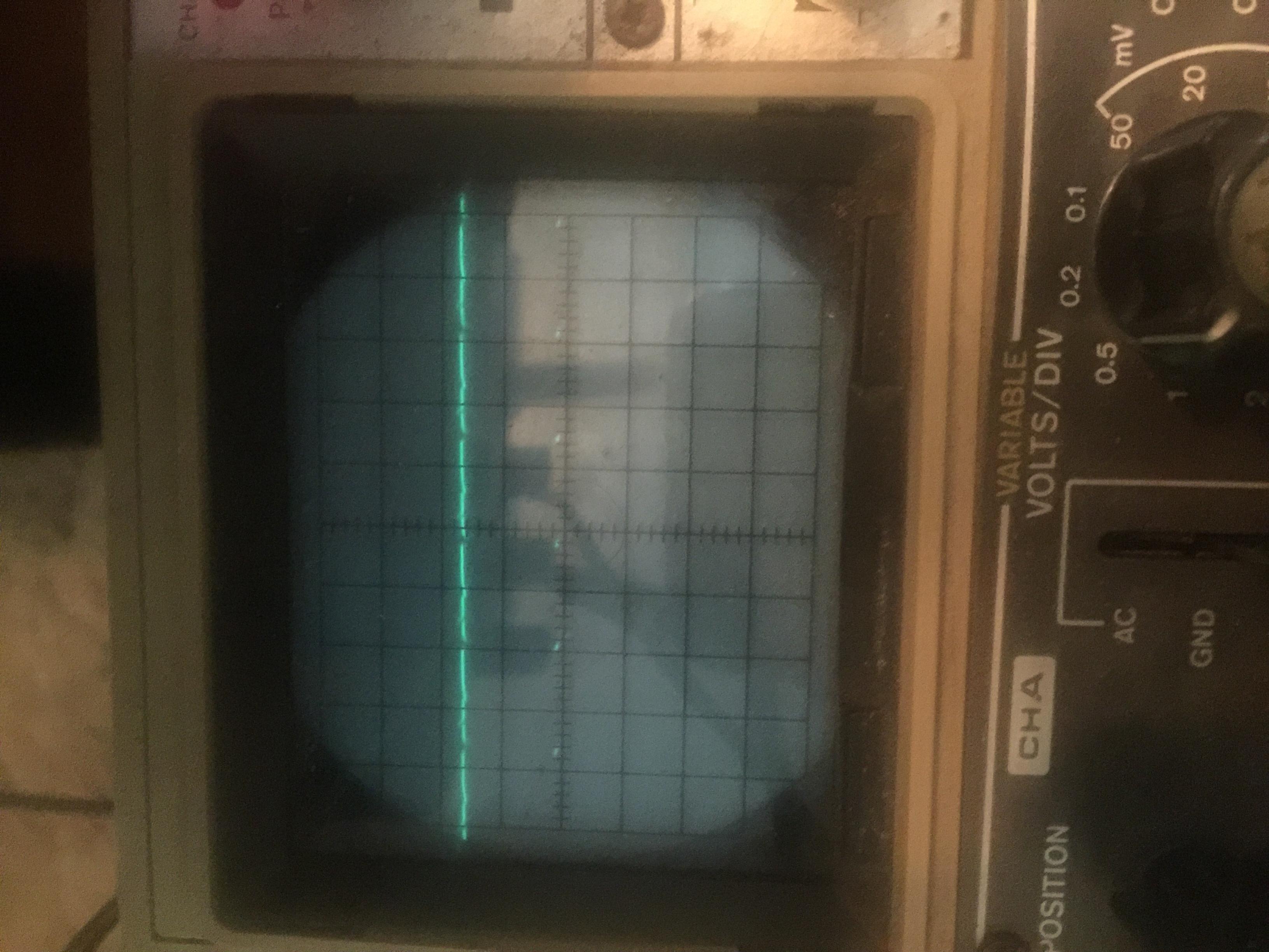

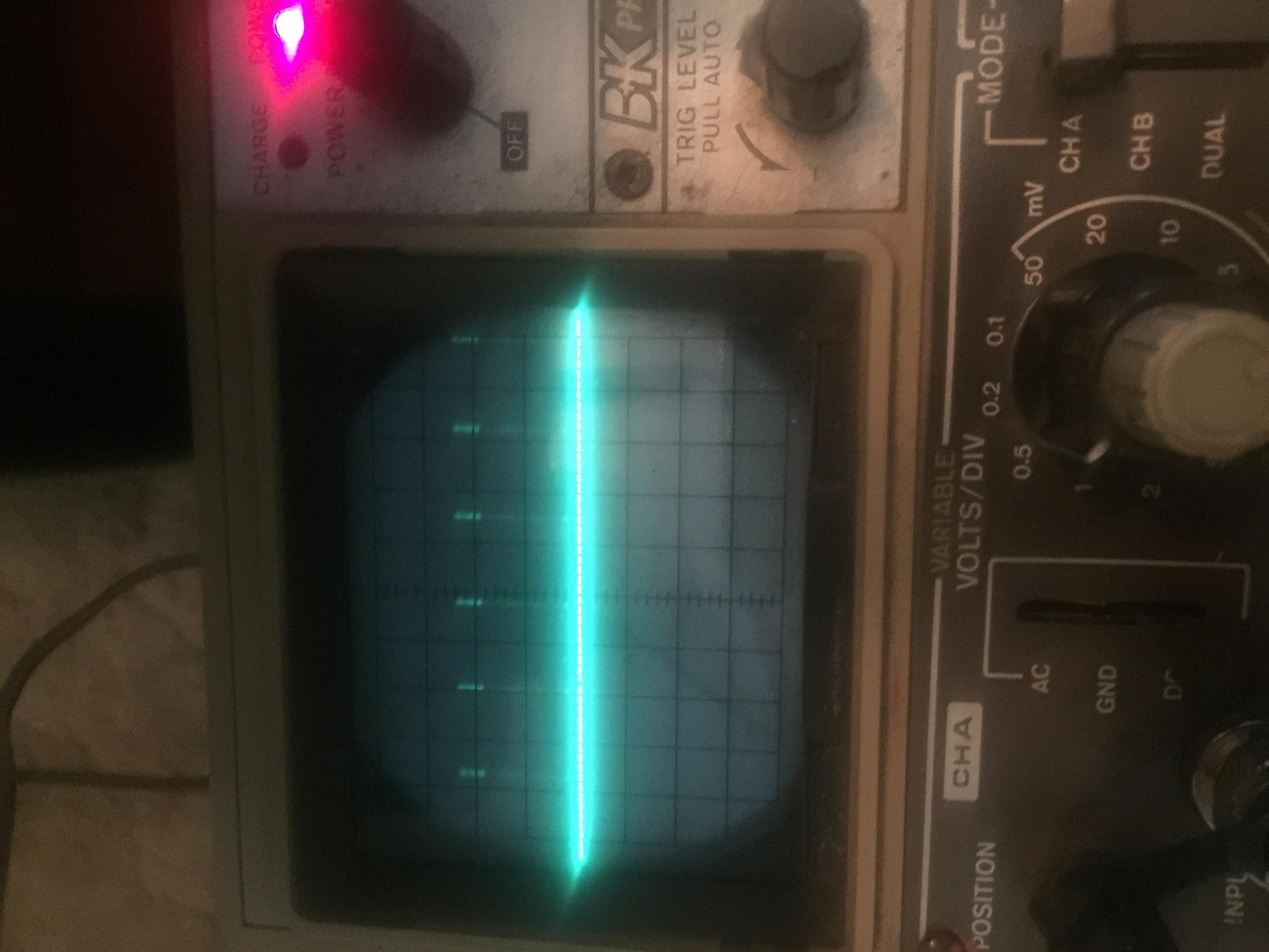

Pins 1/2 on OPAMP shorted, low side FETs jumpered as shown in above post. This is what’s on the gates of Q504/5/6/7 in that order, 10x probe, .5v/div, 10us timebase. Sorry about the crappy quality/rotated shots, I don’t know why that always happens in forums they look fine on the phone. To me it looks like drive is missing from Q504, and the high side FETs have a high duty cycle while the low side have nearly nothing.

So I take it this is a PWM duty cycle issue, and not to do with the output stage itself? I can’t extend the board, but I can tack little wires onto whatever point I need and reinstall the preamp board. I assume I’ll be searching for whatever is causing it to drive the high side to full duty cycle even though there’s no input, is this a bad comparator or a railed OPAMP by chance?
