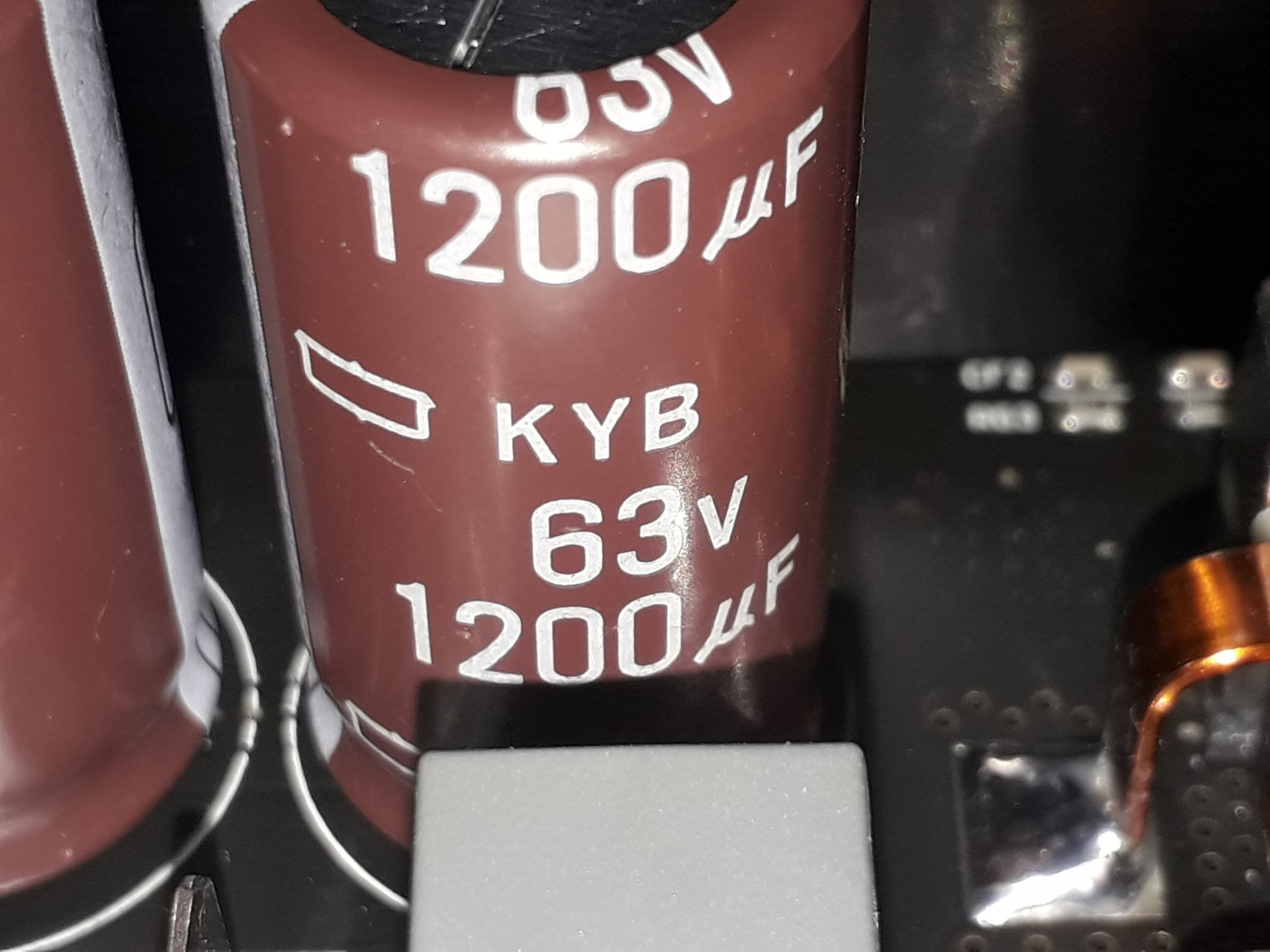

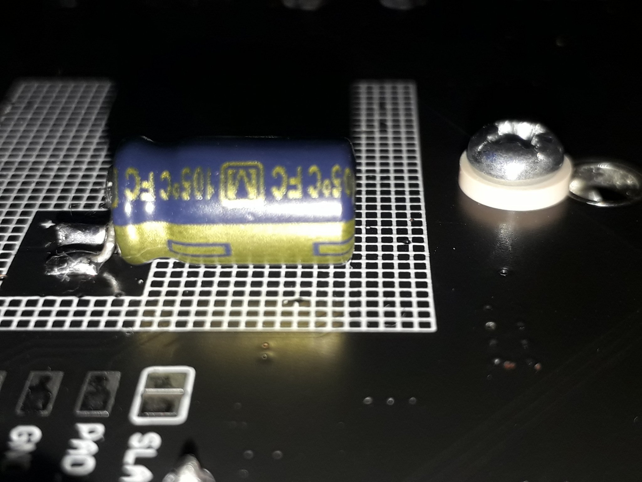

United Chemi-con KYB is the one currently available. (same as pic on the web store). Thank youPS: you wrote on your shop -> "Capacitor for PVDD is either United Chemi-con KZN / KYB Series or Panasonic FC series whichever is available".
Which ones will be mounted on your last series, knowing that I ordered a SYLPH-D200 Mk II PCB from you and that I rather have a preference for the United Chemi-con KYB?

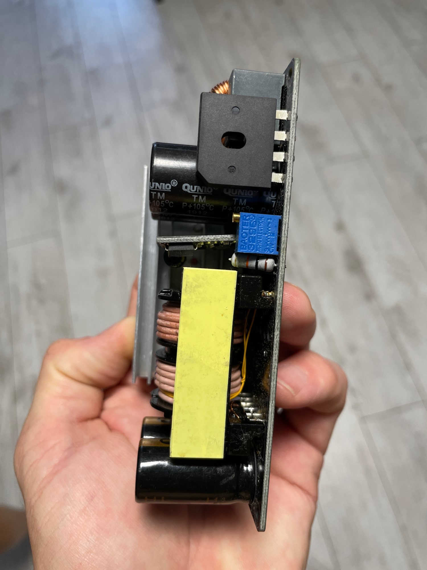

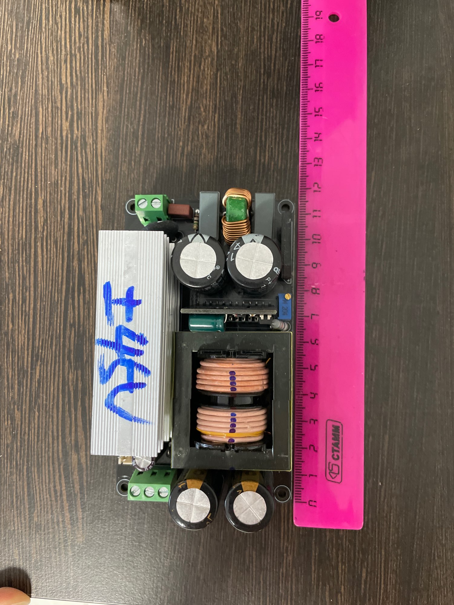

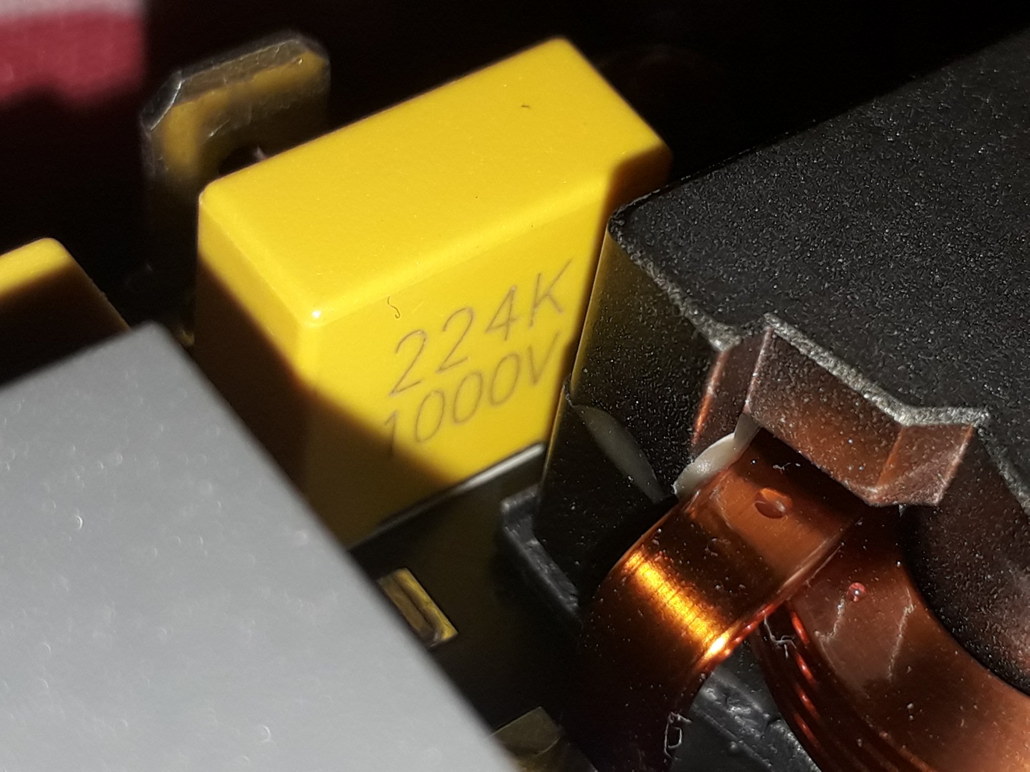

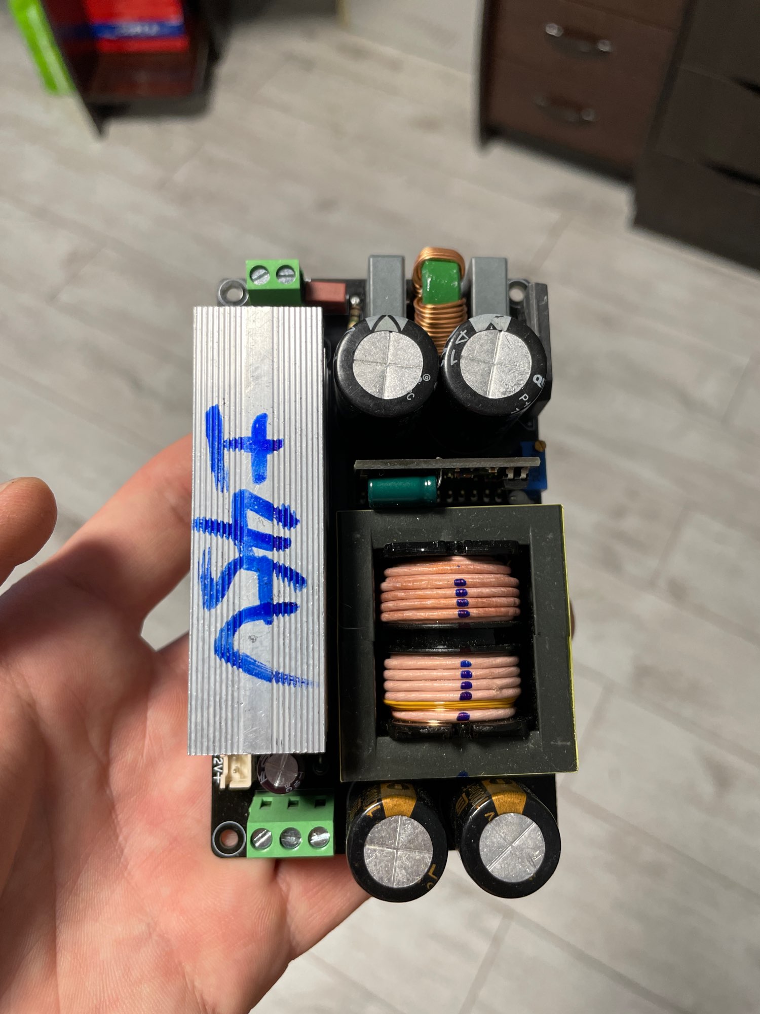

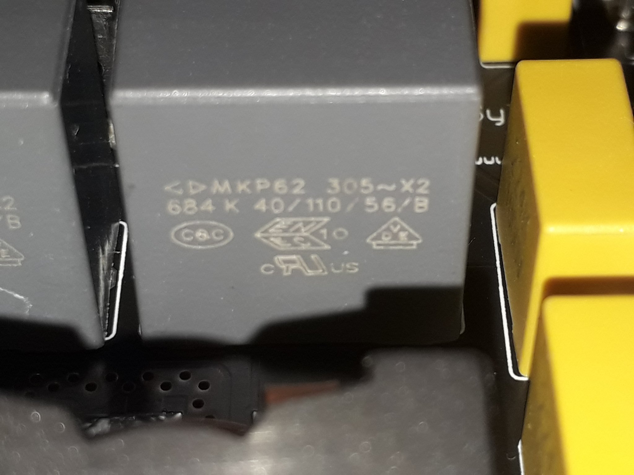

Hi Lester.
What did you think about this supply (220-240VAC/Single 50VDC/600W) ?
https://fr.aliexpress.com/item/1005...st_main.5.2cac5e5brvLtXV&gatewayAdapt=glo2fra
Here are some pictures from the net ->
Regards.
Regards.
D
Deleted member 148505
Looks like it has the same implementation as the one that I'm currently using, it's also easier to modify.Hi Lester.
Regards.
For their single supply version in aliexpress, I saw that they are just removing the TO-220 rectifier for the negative side and connecting the output negative trace to ground.
I have checked my green SMPS on the scope and it was significantly noisier than the meanwell's. As for the sound, it's still good and doesn't degrade the Sylph-D to the point that it's noticeable. I will check the FFT of my green smps setup once I have the time to do it. (I tried a cheap meanwell knockoff and it has a spurious noise around 25kHz on the FFT, also felt that it degraded the sound)

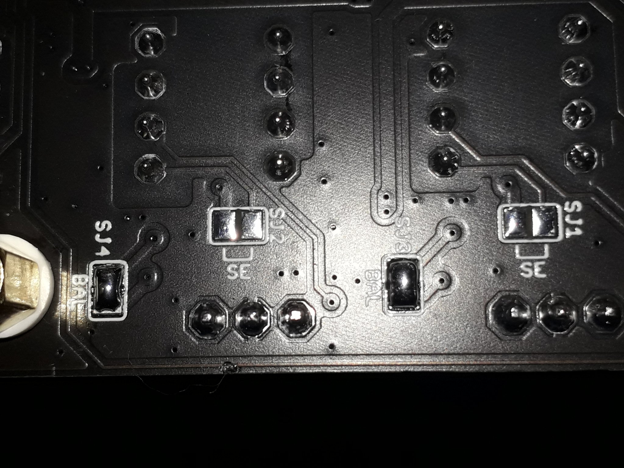

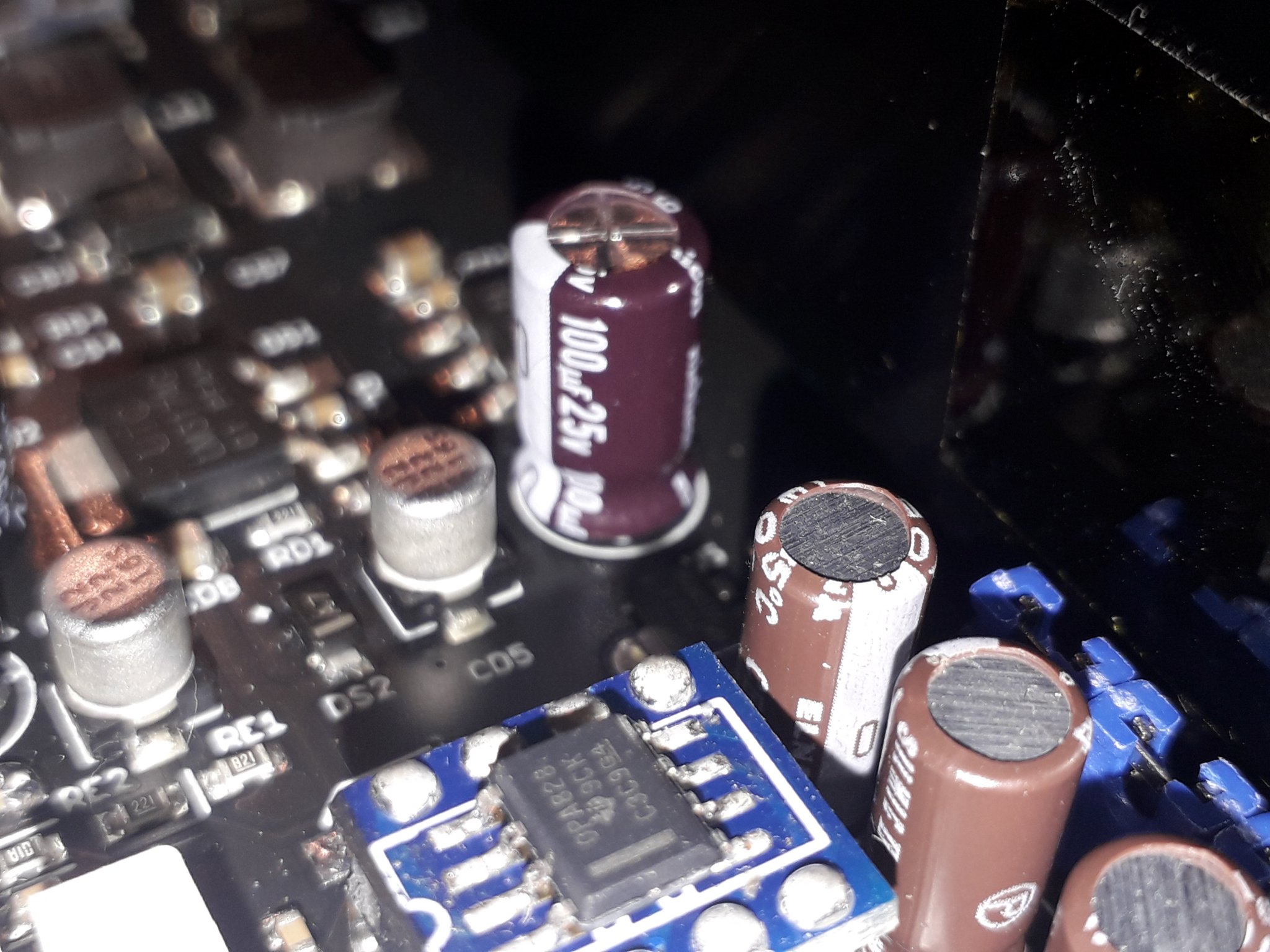

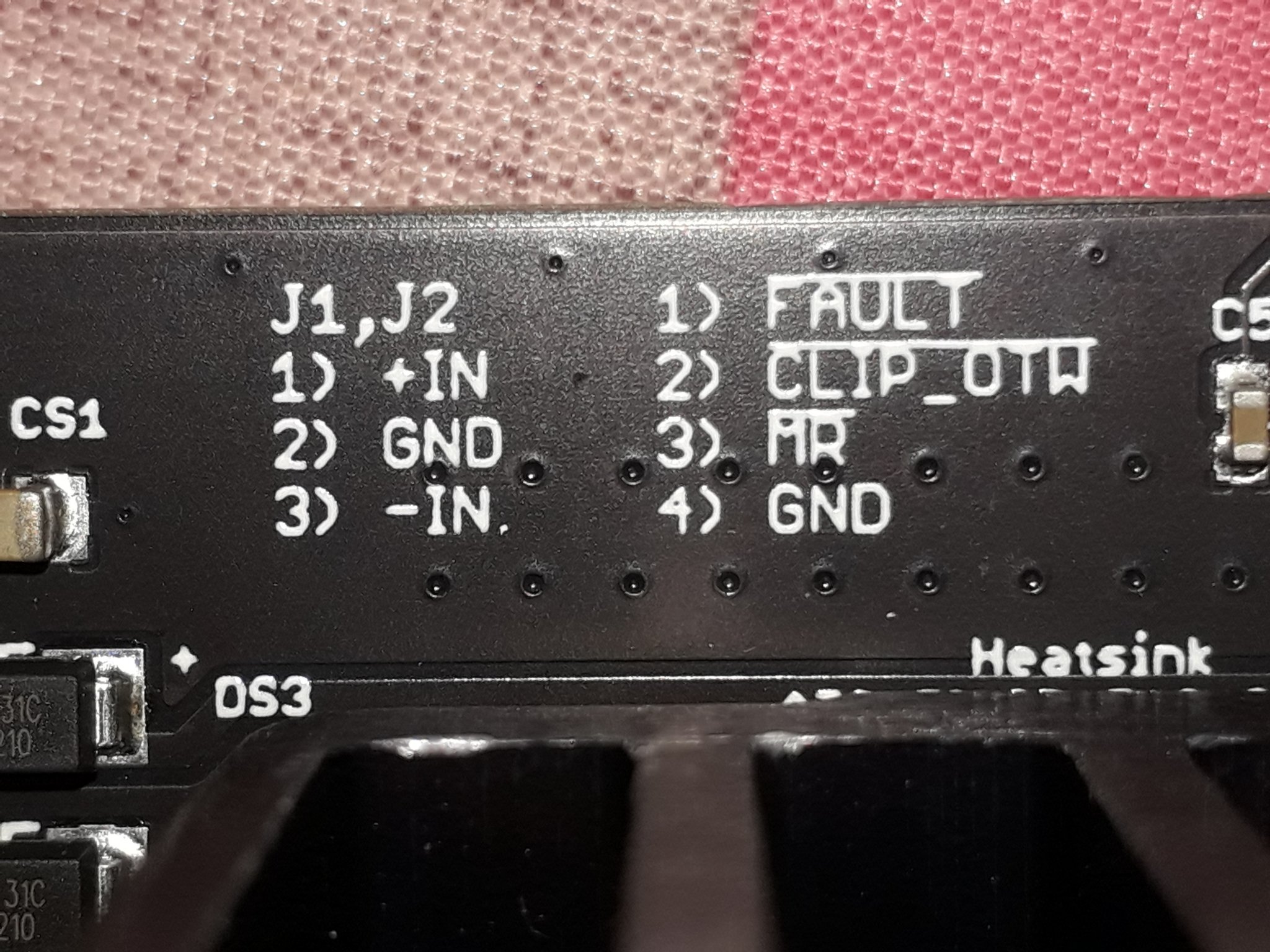

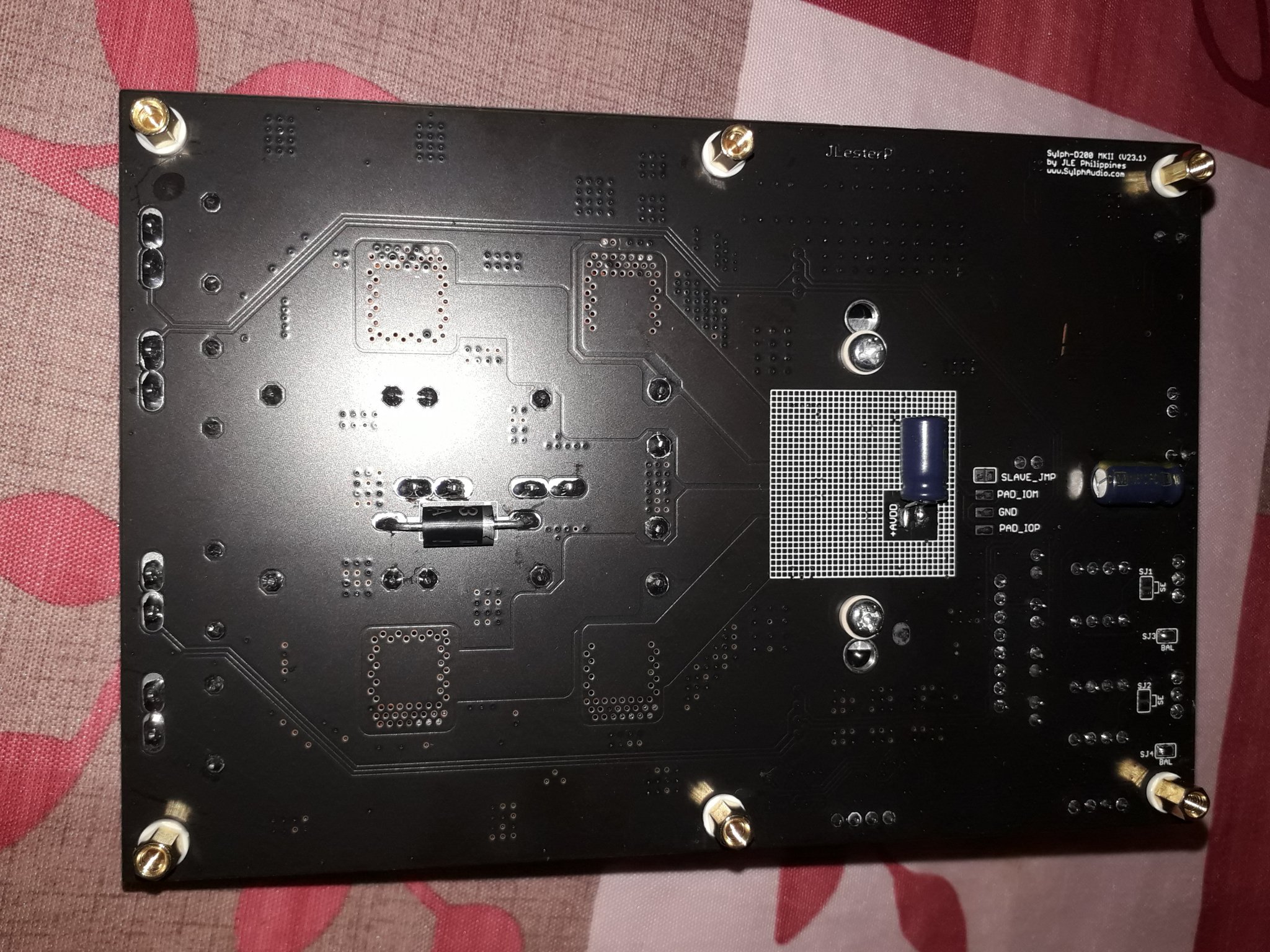

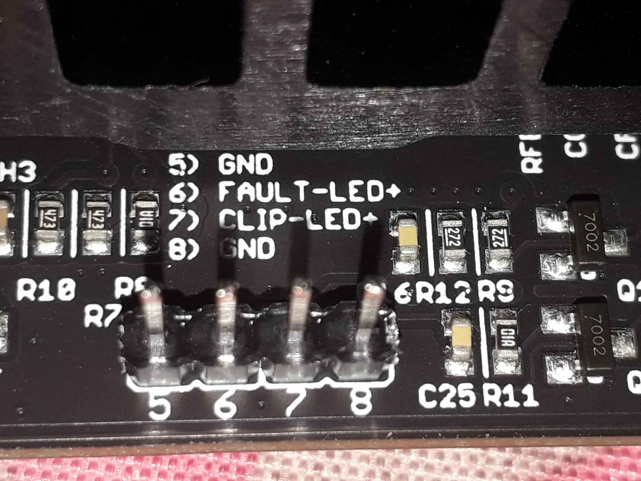

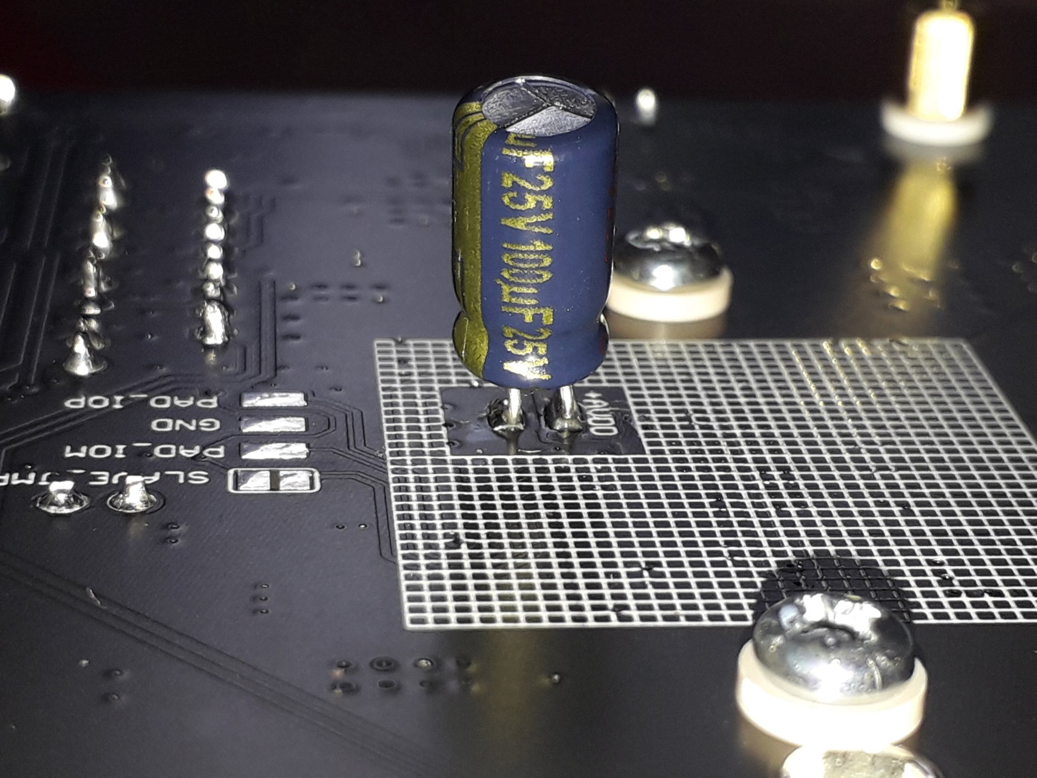

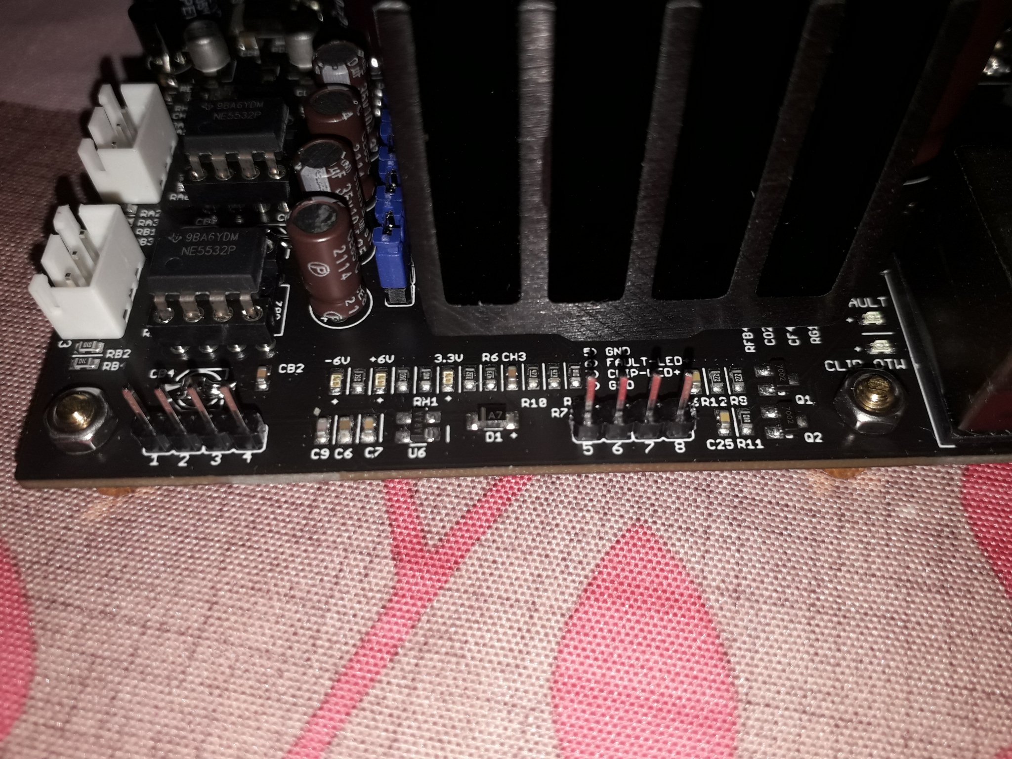

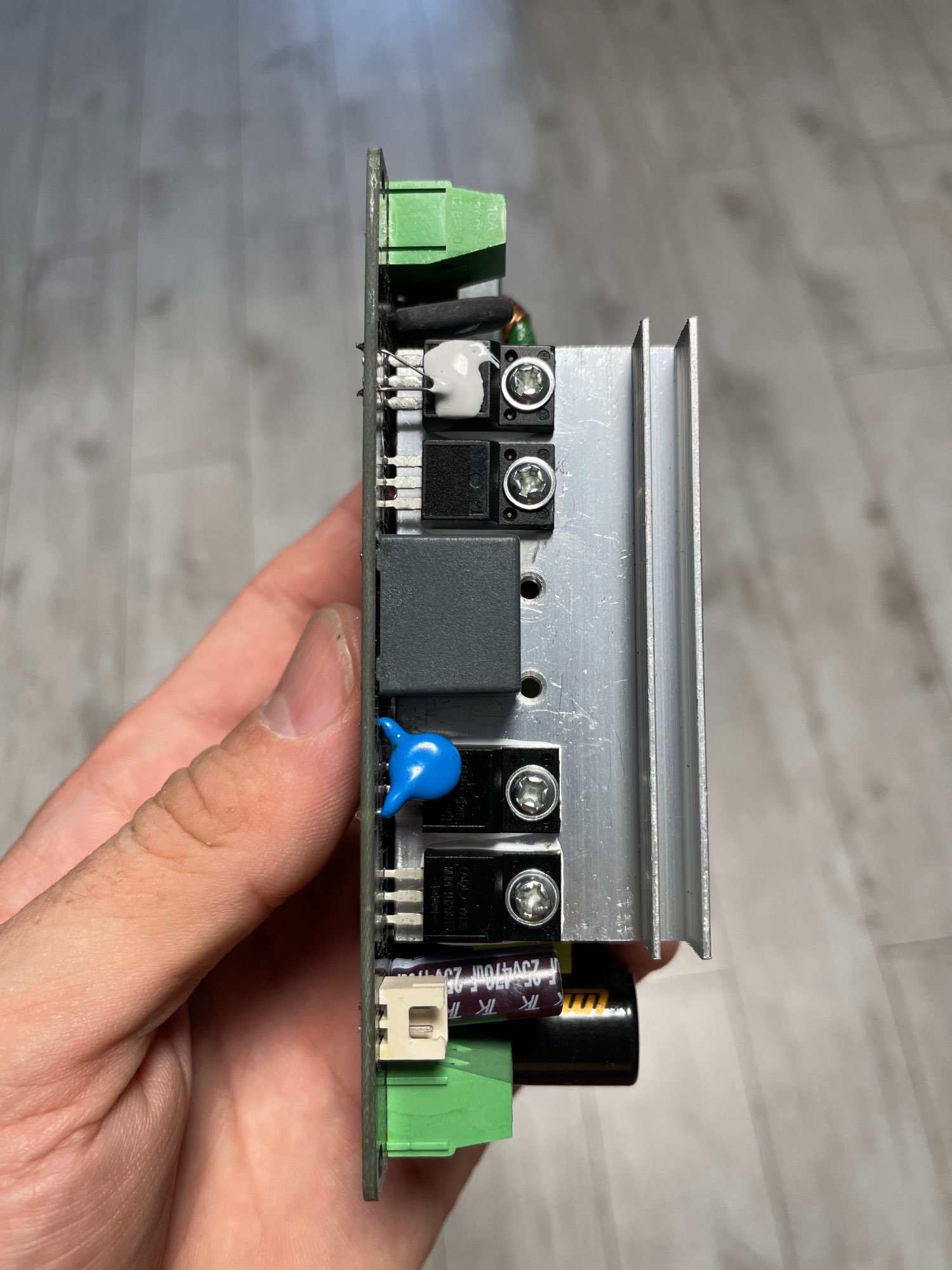

People hi !

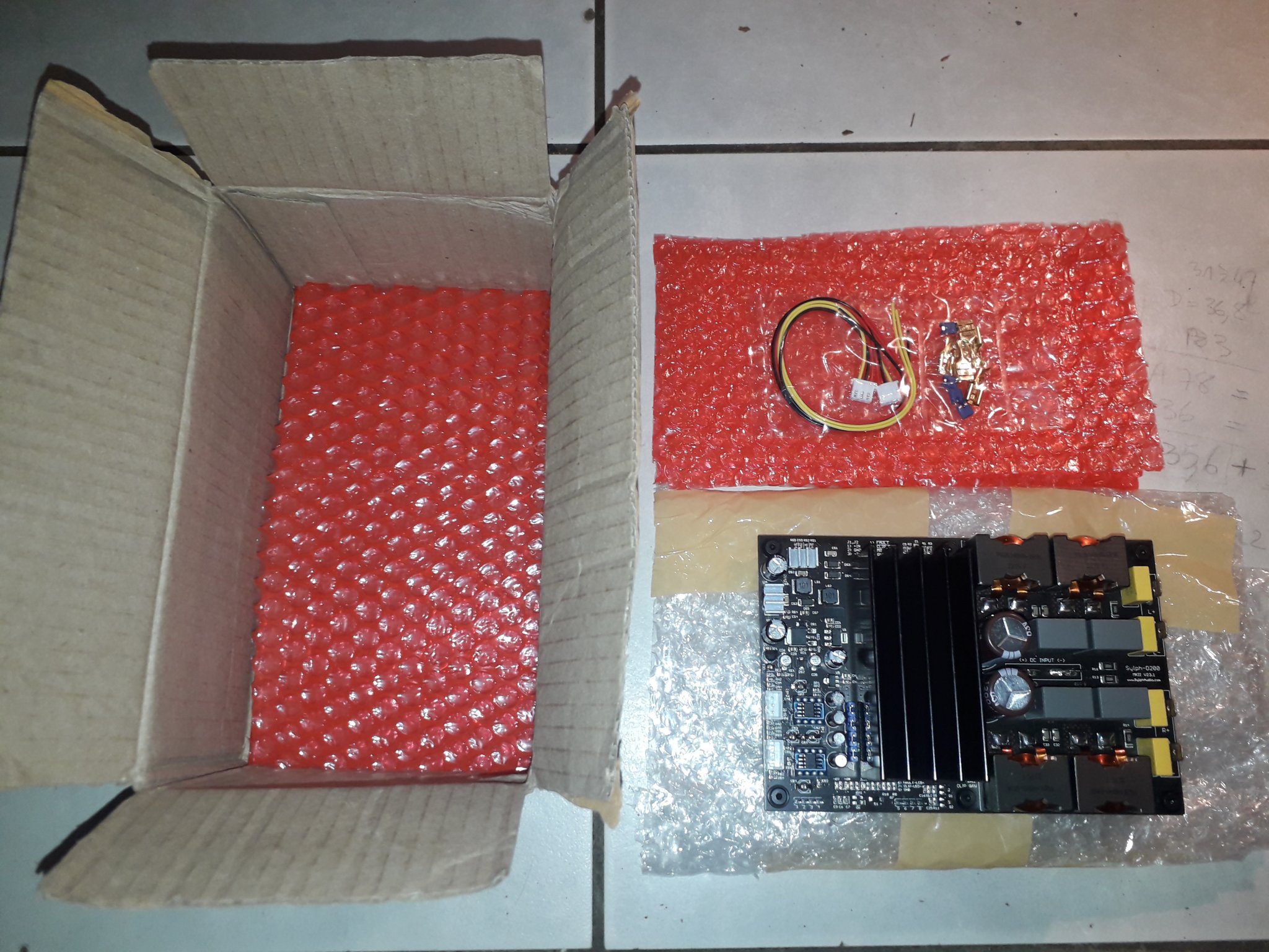

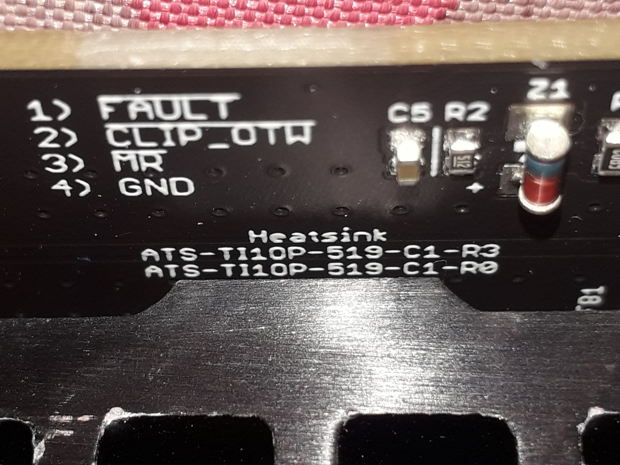

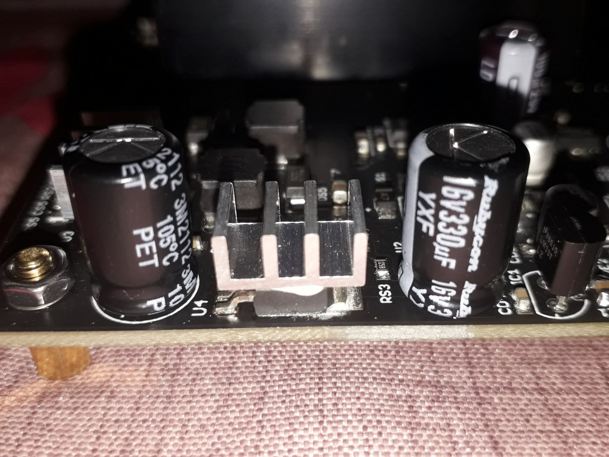

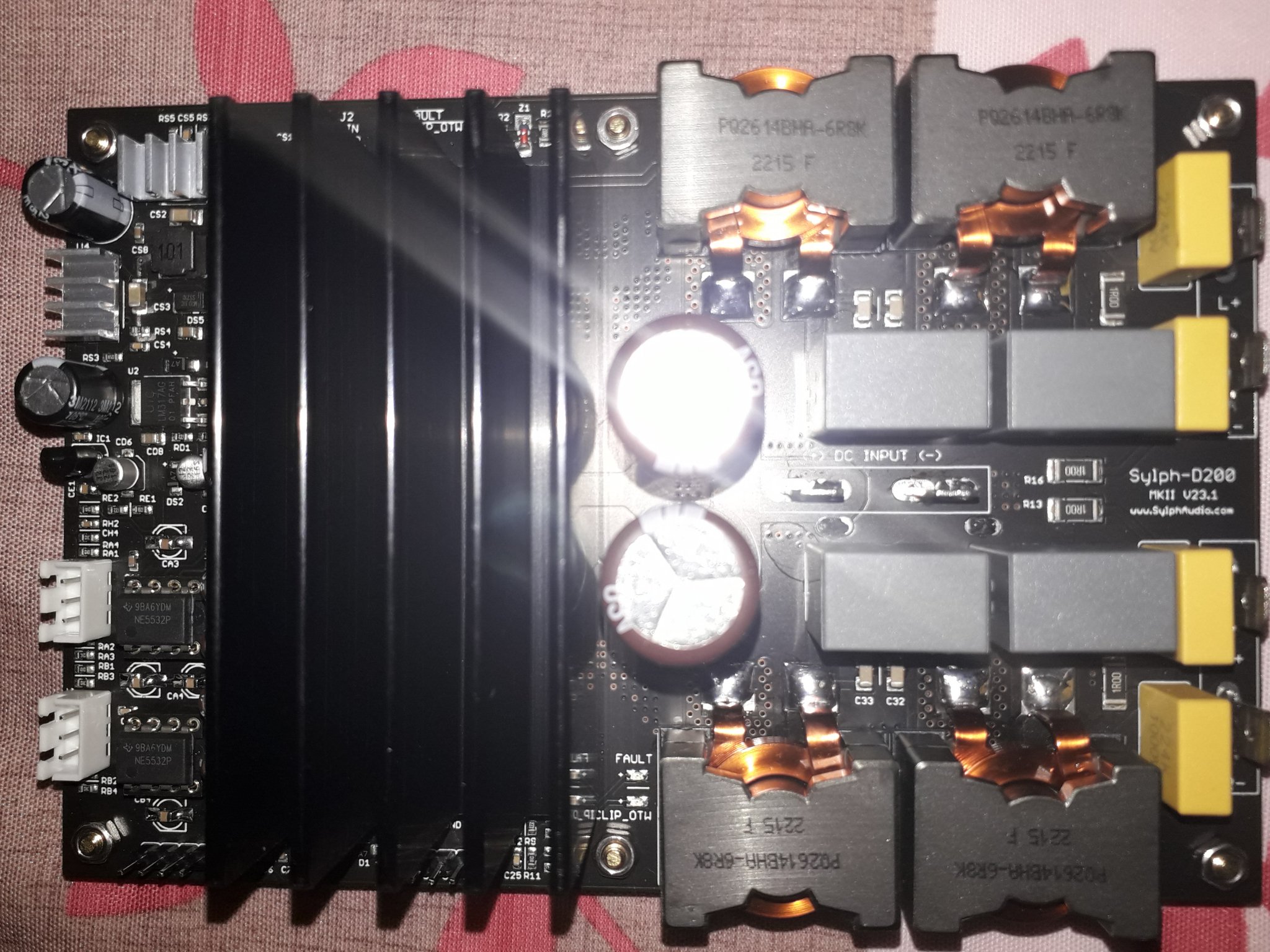

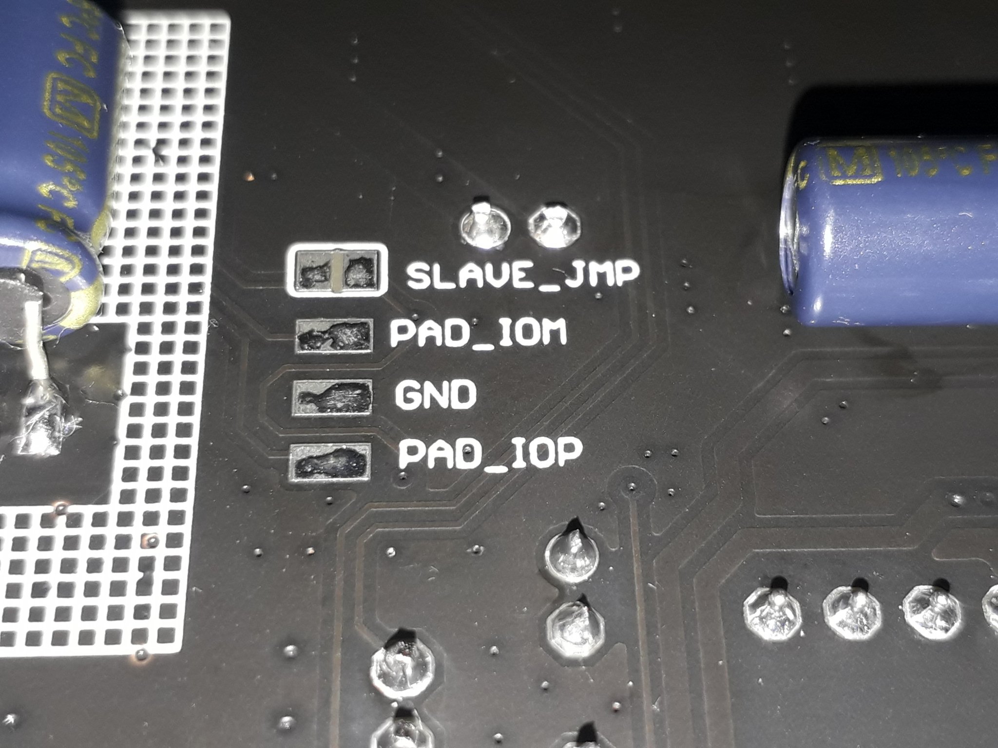

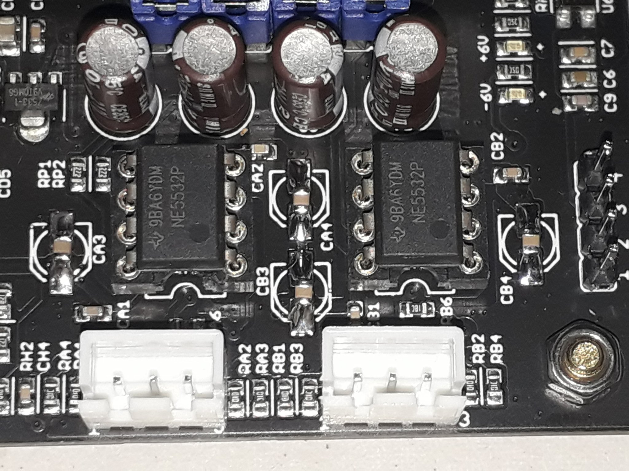

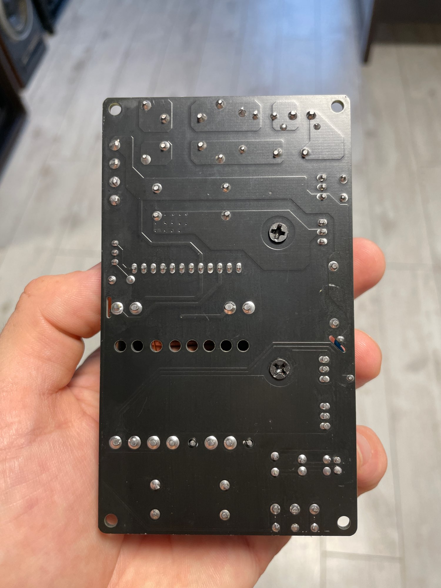

I received my PCB 'Sylph D200 MKII'
The work done is simply exceptional and I would like to congratulate LESTER: there is nothing at all to complain about regarding the quality.
It's an 'extra PCB'
I haven't received all the hardware to build my amp yet but I'll post new pictures as soon as it's finished, I promise
In the meantime, here are some pictures ->
It's an 'extra PCB'
