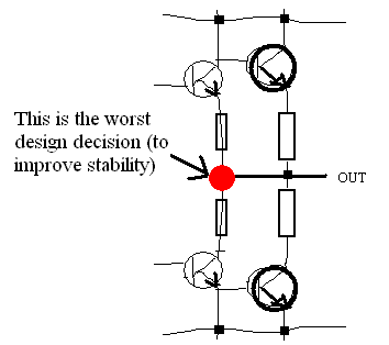

The problem is not in the splitting but in the regrouping after splitting ;) For example, see attachment!
But like many things else, it is about compromises: how much to gain and how much to loose. In general, imo good sound comes from 2 things: internally from the amp itself and externally from its ability to synergy with the speaker.

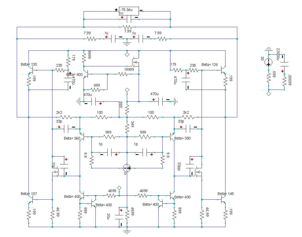

Hi Jay,
As you are planning to build a version soon I thought you may be interested / amused to see a balanced version I built in 2000 and enjoyed for a few years - I changed the feedback resistor values on the diagram for more inherent stability. The driver mosfet is a ZVN3310a and this combined with the i/p stage CCS greatly increases OLG and reduces HD.
I am aware some would say I ruined the concept by increasing OLG & adopting compensation, but I found these modifications pleasing and compared to other topologies this design still has a significant gain / phase advantage.
I'm sure I would do it differently if I were to do it again today - mainly reducing PSU voltage and increasing bias current. I would also be temped to do an mosfet o/p version which I have read good reports about.

Hi Mike,
Interesting circuit you have there (I think I have never seen it before :confused:). You're right, I will also be interested to see an all-FET version of your circuit. But I have different plan for my mosfets :D
I think I will build your amp. What is that resistance in series with power supply cap? How much current running through each output transistor and driver? What is the possible range of the rail voltage? Why is the 1pF at the input?
