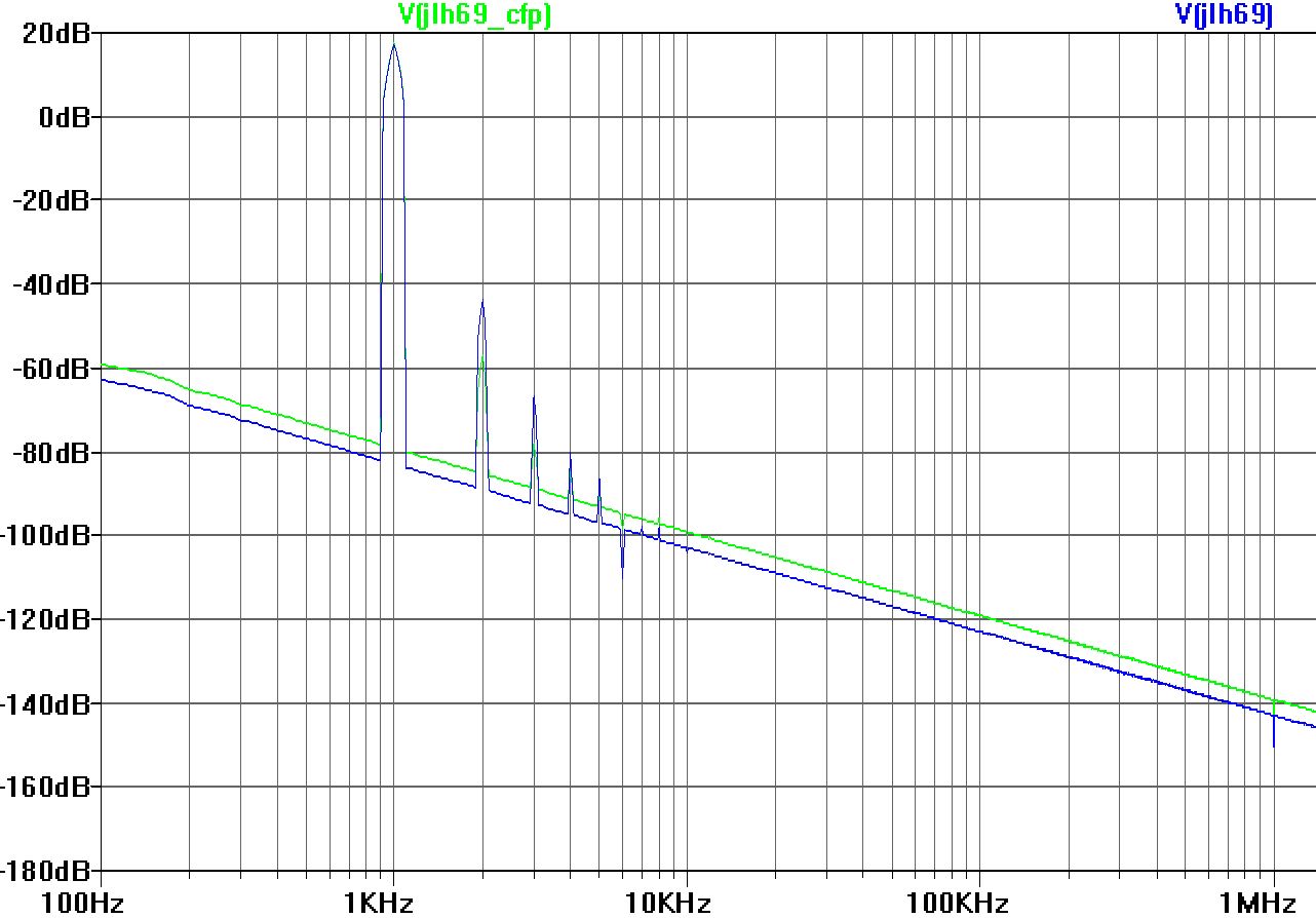

I ve posted this before but no comments posted, In one of JLH books he proposes the use of CFP based phase splitter saying that it will improve performance. Anyone tried that yet ??
The first time I heard about this was from your post. If you can draw the schematic I think many will try it (CFP has unique sound yes).
It is a phase splitter anyway. Types of transistor may also count. I mean, today we have many good transistors compared to that era when JLH thought a CFP based splitter will improve performance. At least, I guess we're going to use NPN input transistor instead of the PNP as used in current JLH, aren't we?
Well from here you can see what a cfp is, Sziklai pair - Wikipedia, the free encyclopedia.
I dont think it is any major change changing the phase splitter transistor to this, I cant post here the page dedicated to this from a JLH book but think of the input impedance and output impedance the change makes as well as the positive effects it would have.
Oh, I know what a Sziklai pair is. I thought the CFP is the second transistor in the pair. If what you meant was adding another transistor to make up a pair for the phase splitter, yes, there will be no major change like I thought.
But still, the existence of better device than the 2N1711 (faster, low Cob) might dismiss the need for extra transistor.

BTW, I am interested in the CFP phase splitter. Currently simulating, soon will build a JLH around it and post results here.

for those that like to see simulations. The cfp option for the phase splitter reduces distortion considerably. You may not like the sound as much, or you may prefer it.
A-ha! Eight transistors at the output of the JLH! That's what I have been thinking to build (at least 0.65mA each). How/why do you come up with that circuit?
I think if we see the JLH as a single ended collector "follower", the CFP splitter should do no harm but good, even if the distortion spectrum is different. I will build this hopefully within next month
