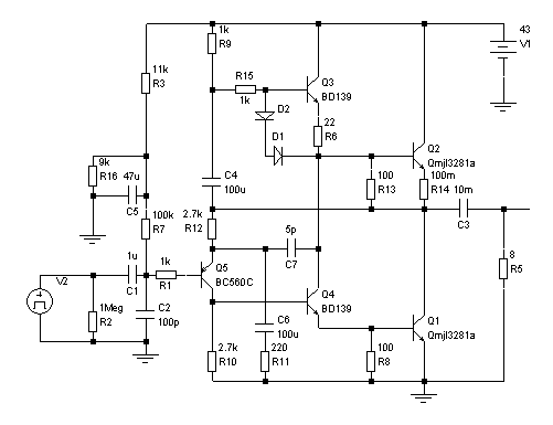

I just simulated the following DOZ schematic with the CCS config as shown in the attachment. It passed all the tests and gave lower THD level, higher output swing and higher slew rate than the original DOZ with the same output transistors. So I was wondering how it may sound.
The CCS runs okay in the sim and to me it looks like a better option as it will have less Iq increase with temperature increase. Still, can someone please tell me if there's some problem waiting for me if I use this CCS?

Jay, It doesn't have an audible effect. But it has an effect on the minimum value of C5, which increases as (R16+R3) decreases, in order to effectively prevent any power supply hum or noise from getting into the input. I used this combination cause I have a lot of 20K pots in stock, in the past I used 100K and that was okay too.

If this is true then higher value of (R16+R3) is better because you can use smaller value of C5 which means you can choose higher quality cap, or means less dollar. But... I doubt it.
From my limited experience, there is a "sweet spot" for this RC filter. I have temporarily assumed that this is true: you have to aim for a specific RC values (not just minimum R*C) which may means a specific frequency, but it is a DC anyway

I have finished and tested the circuit. Stable and quite. But,
Doesn't sound nearly as good as the DOZ.

Actually sounds very bad.
So there was indeed some problems waiting for me. Well, right now I am not in the mood of searching-finding-solving.
Project halted.

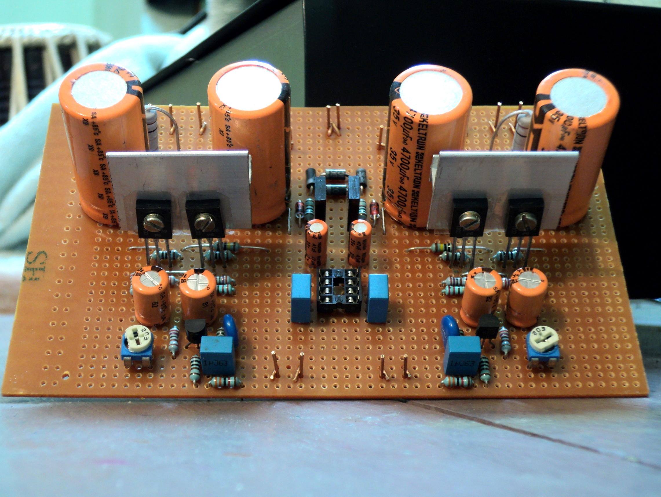

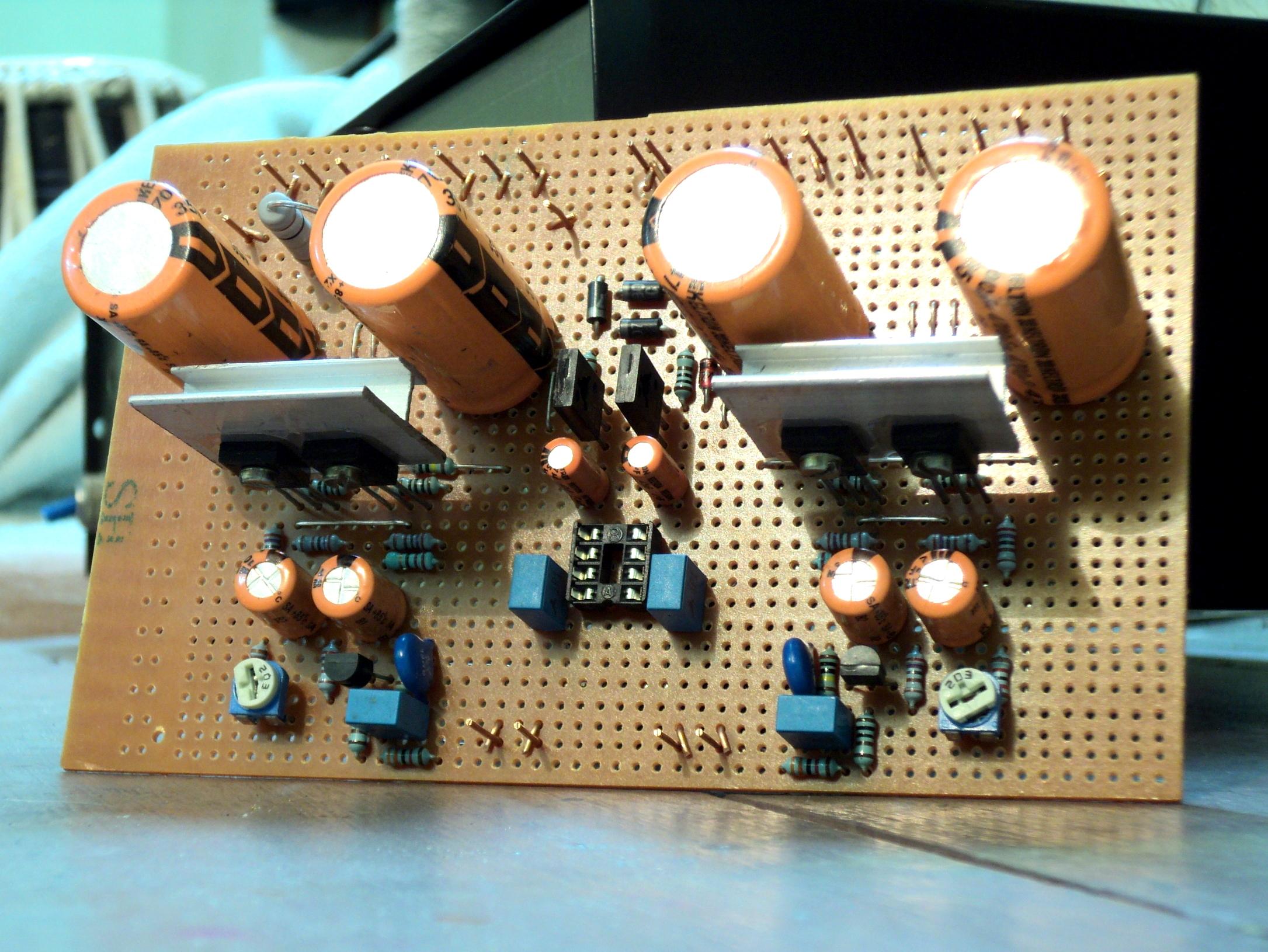

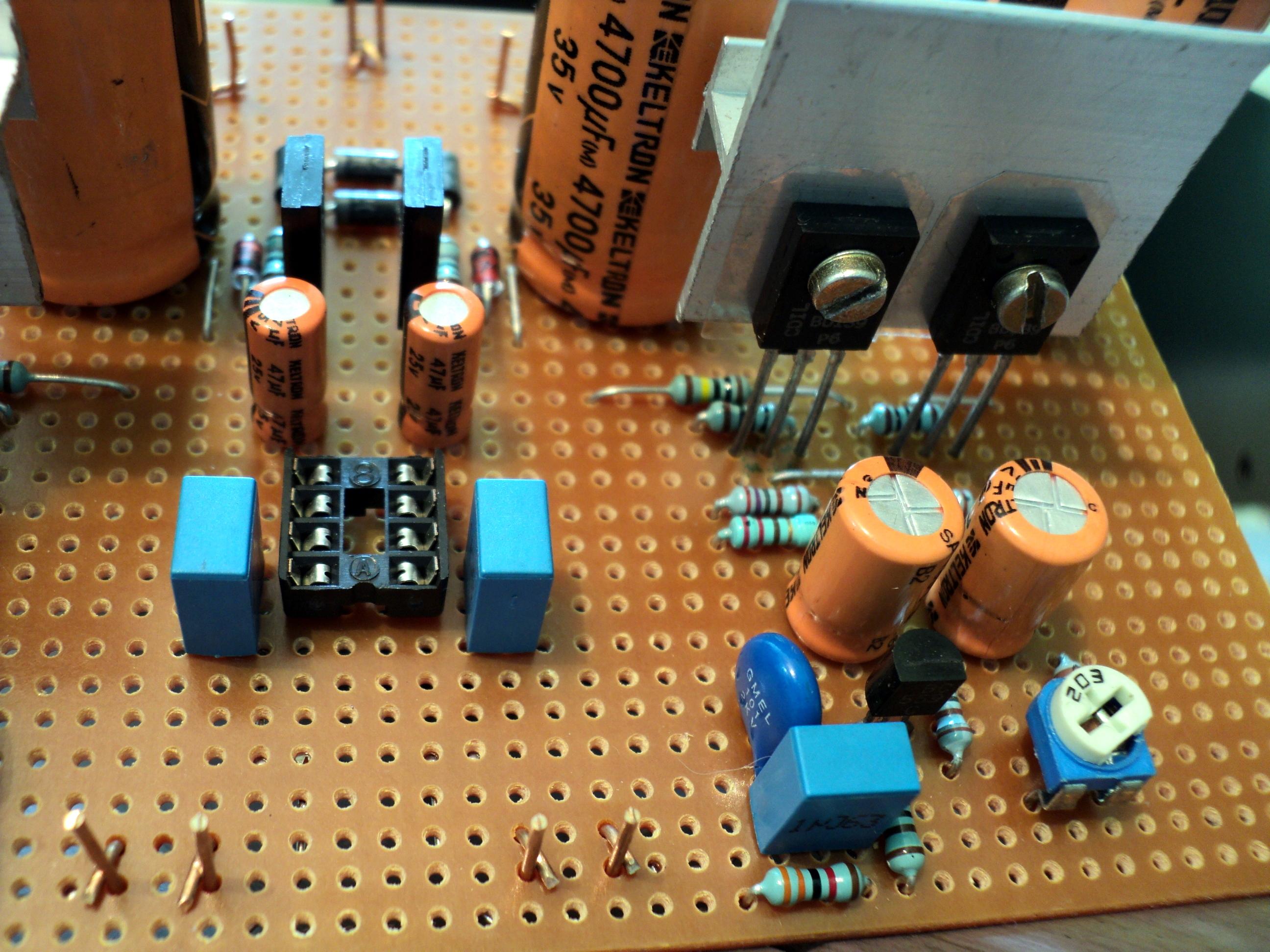

My direct coupled DOZ with DC servo powered from main rails. At the time of writing it is running ok with less than 1mV offset and 1.5A Iq from +-20V. PS filtering is not optimum so there is a little hum at the speaker, expected this. From a distance of about 2 meter the hum is inaudible and I played some music, sounds like a DOZ. Testing only one channel, with the feedback capacitor. I will now short the feedback cap and test it.

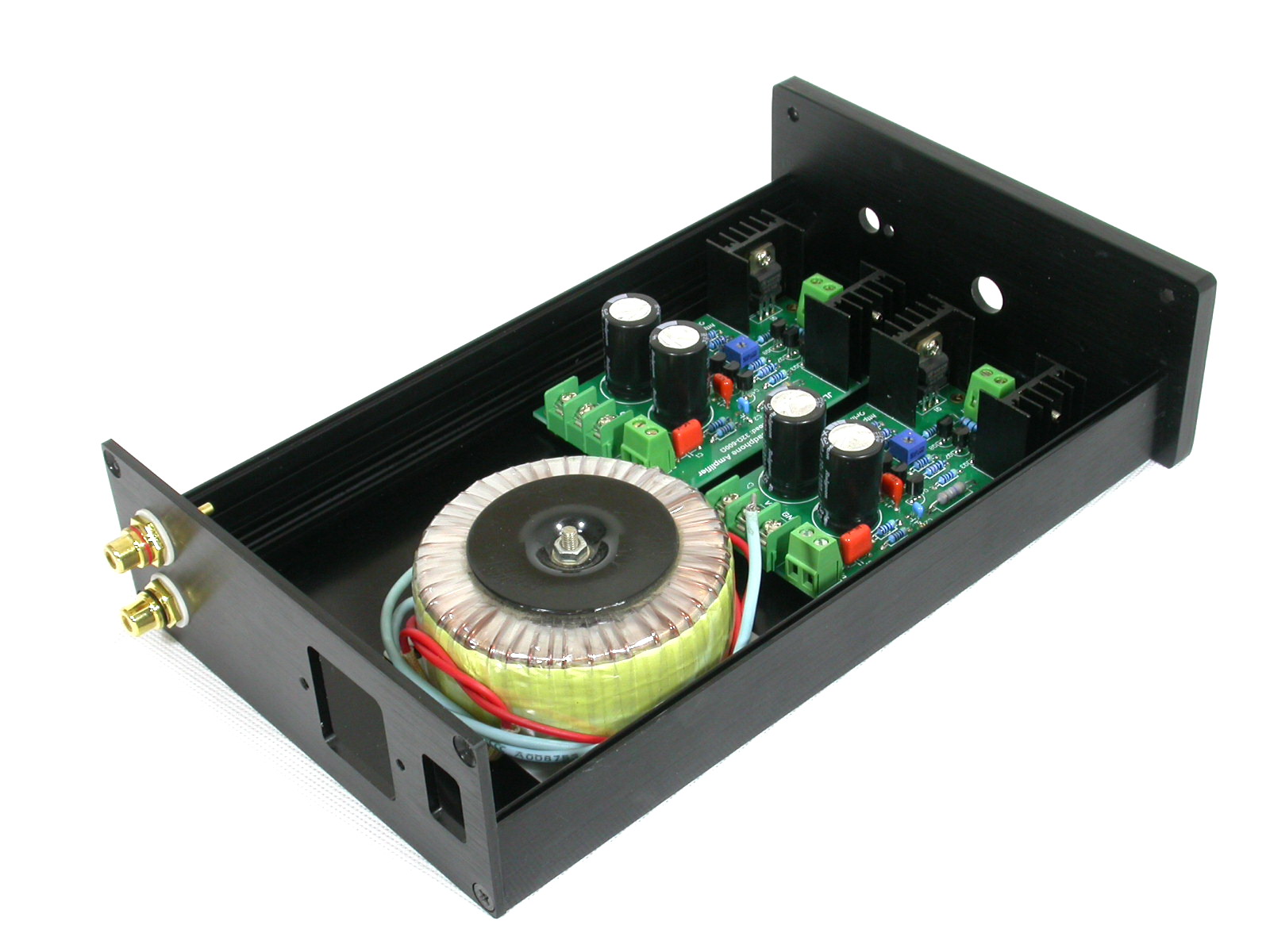

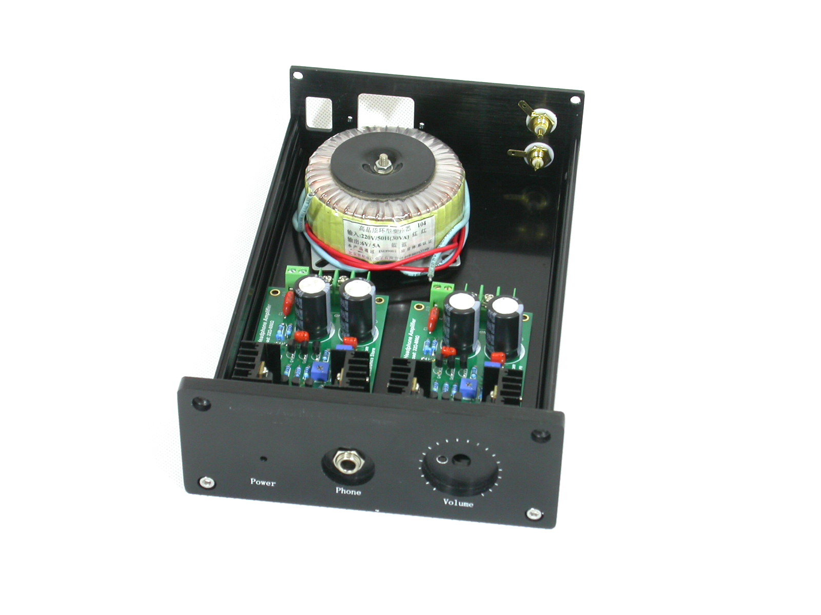

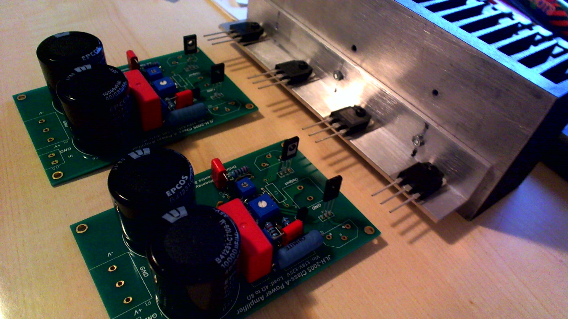

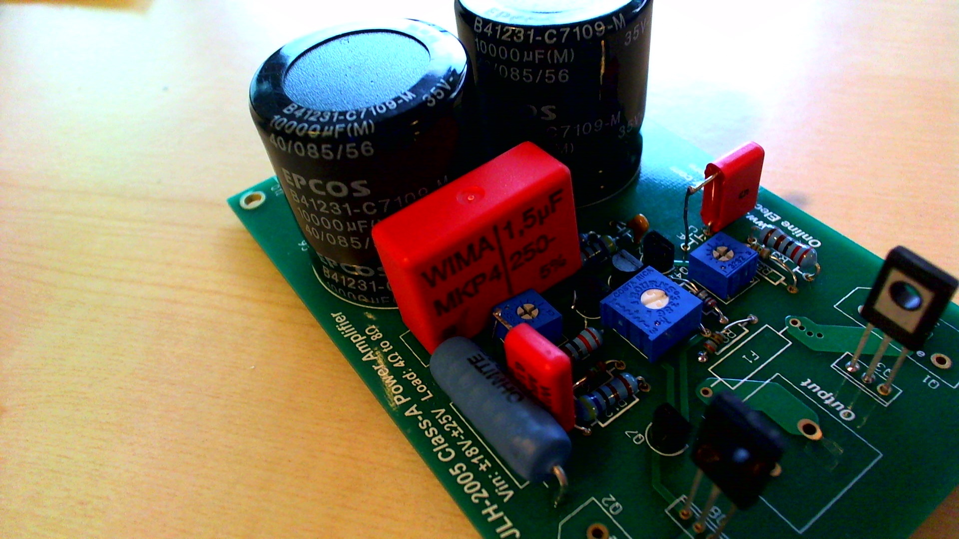

My DIY JLH headphone amp. A 30W toroid is overkill for headphone but that's what I have in hand. The RE1506 enclosure still have plenty of room for a power board with rectifier and 2 big caps. Hope it can be finished in 2 weeks.
Shann what is your power transistor? How much Iq? I'm afraid the heatsink is too small for a JLH. My heatsink is 5 times bigger than yours for each transistor but still very hot.
How can you see what size Shaan's heat sinks are? The ones you see on the board are not the main heat sink, surely the power devices are mounted off board on a hefty heat sink.
- JLH 10 Watt class A amplifier
