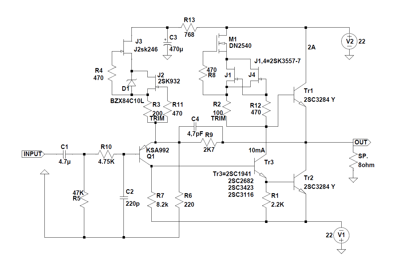

Look at my scheme, I used FETs in CCS instead of bipolars, everything else is the same as in the 1996 scheme.
With FETs I have great experiences from using with tubes and they are generally good for CCS.
In my case after heating the amplifier the offset at the output does not exceed +/- 5mV. I made a version without CCS for the test but this one sounds a lot better. No feedback capacitor is better.
The same effect should be expected with the 1969 version.

Constant current sources in reality seldom do as well as they should. Many reasons. They are well liked because they are very cheap to do. In many applications constant current isn't the reason they are used. It's the illusion of being at a seemingly ultra high voltage with an almost infinite impedance. When used with a valve a distortion of 1% might tumble below 0.1% for the same voltage. However a bootstrapped anode load in the same place can be as good. The JLH has this to a lesser extent..

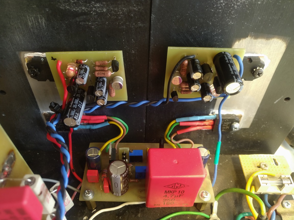

I made my first CCS based on these articles about ten years ago.
Before that I have already used DN2540 for CCS around tubes with excellent results.
For small currents I use FETs, and for larger currents depletion-mode MOSFET with FET (s) below.
By the way I am a big fan of Mr. Walt Jung, the regulators in my JLH and Le Monstre are made according to the scheme of his regulator.
