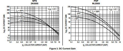

The characeteristics you showed also show my earlier comment that at around 1A there is a trade-off between temperature variation and gain reduction.
It would be hard to use a 3055 in class A at 3A because the gain roll-off means the quiescent current would have to be significantly greater than the theoretical Ipk/2.

The original RCA 2N3055 hometaxial device (the one with the negative differential of gain with temperature at 1A BTW) had quite a terrible 10kHz (min) fhfe, typically 15kHz, that I was surprised people thought it suitable for the JLH. Epitaxial devices with ft's around 3MHz (TIP3055 for example, or the current 2N3055) have fhfe's around 60kHz, so they would be reasonable for many I suspect. Although I've suggested modern 30MHz type devices should give the best results, they have such large input capacitance that I'd have to re-evaluate, because, once again, the base current is limited.
