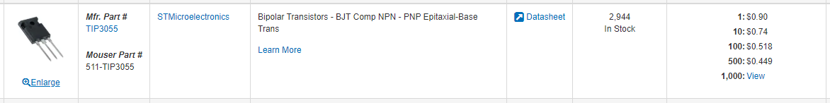

There are better parts in TO3P packages if you want cheap semis. You can use other boards which suit these newer packages and are cheaper too. I use KTD1047 (marked K 1047 since it's a copy of 2SD1047 which Rotel used with 2SB817 in everything they made for many years). It sounds better to me than 2N3055 anyway. There's nothing wrong with TIP3055 either and they are cheap and reliable, from genuine new parts sellers everywhere.
The TIP3055 is quite affordable at $0.74 each for quantity 10 at Mouser. So if that is a good choice I will try it. I see the KTD1047 in a number of my LJM projects such as the MX50SE, MX50X2 and the L20.5. However they seem expensive to buy at $3.70 for the 2SD1047 at Mouser (I didn't see the KTD1047 listed). I suspect it is affordable in quantity or at other resellers if you know where to find it. (Otherwise the MX50SE would cost much more.) I see them inexpensively on AliExpress but the ink marking does not match the laser marking on the ones in my LJM kits so who knows what is inside of a copy of a copy. Do you know where real ones can be bought?
