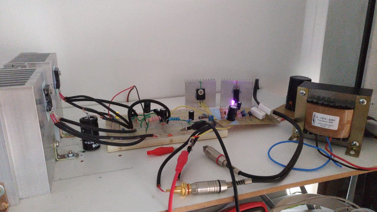

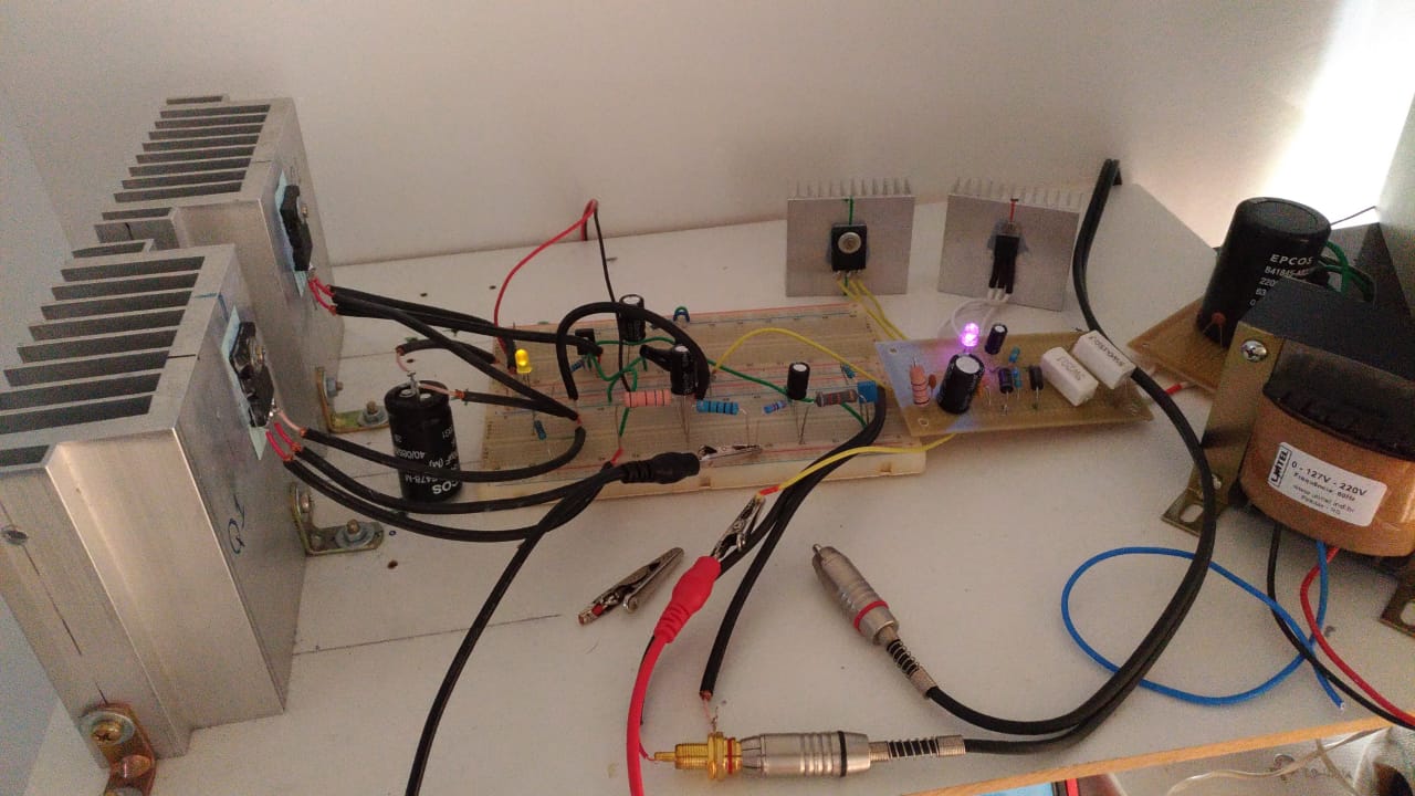

REV. in my JLH 1969 (10W) DC

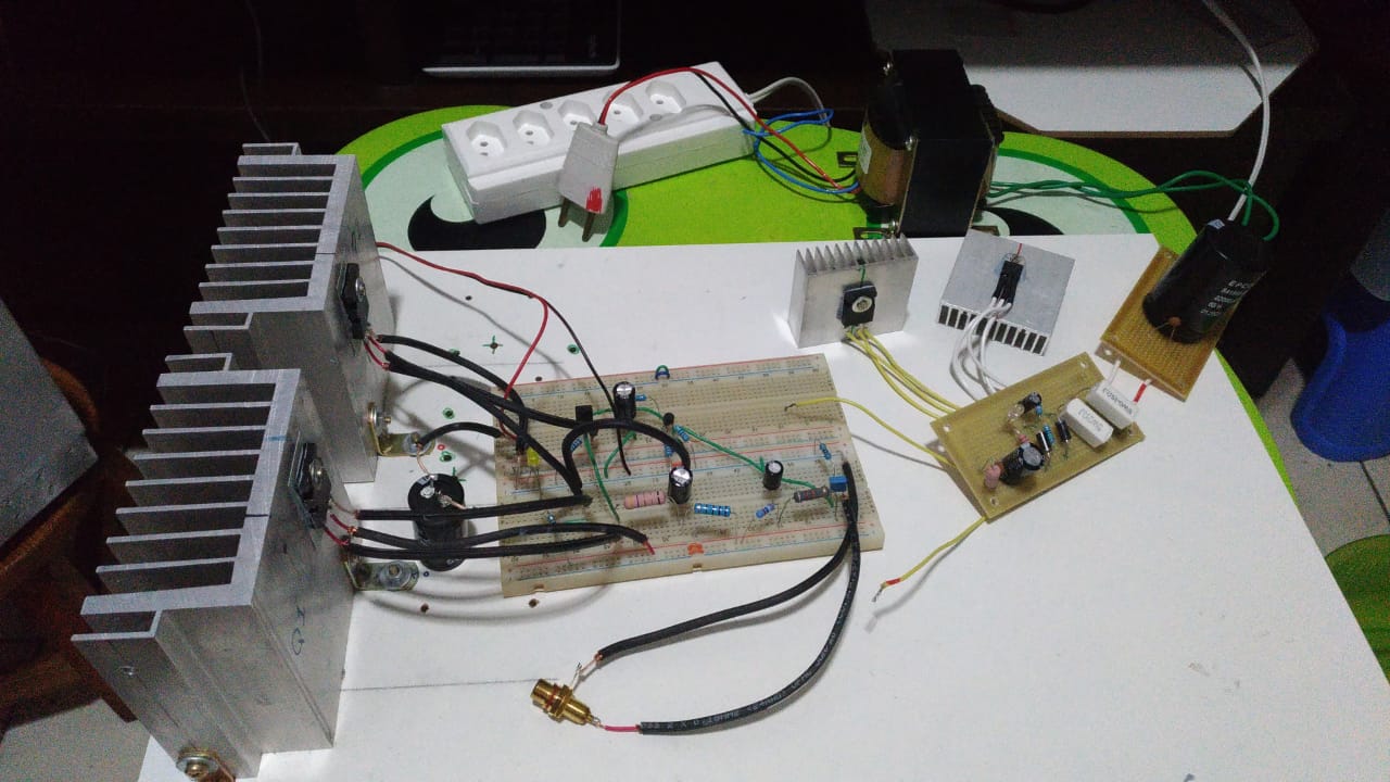

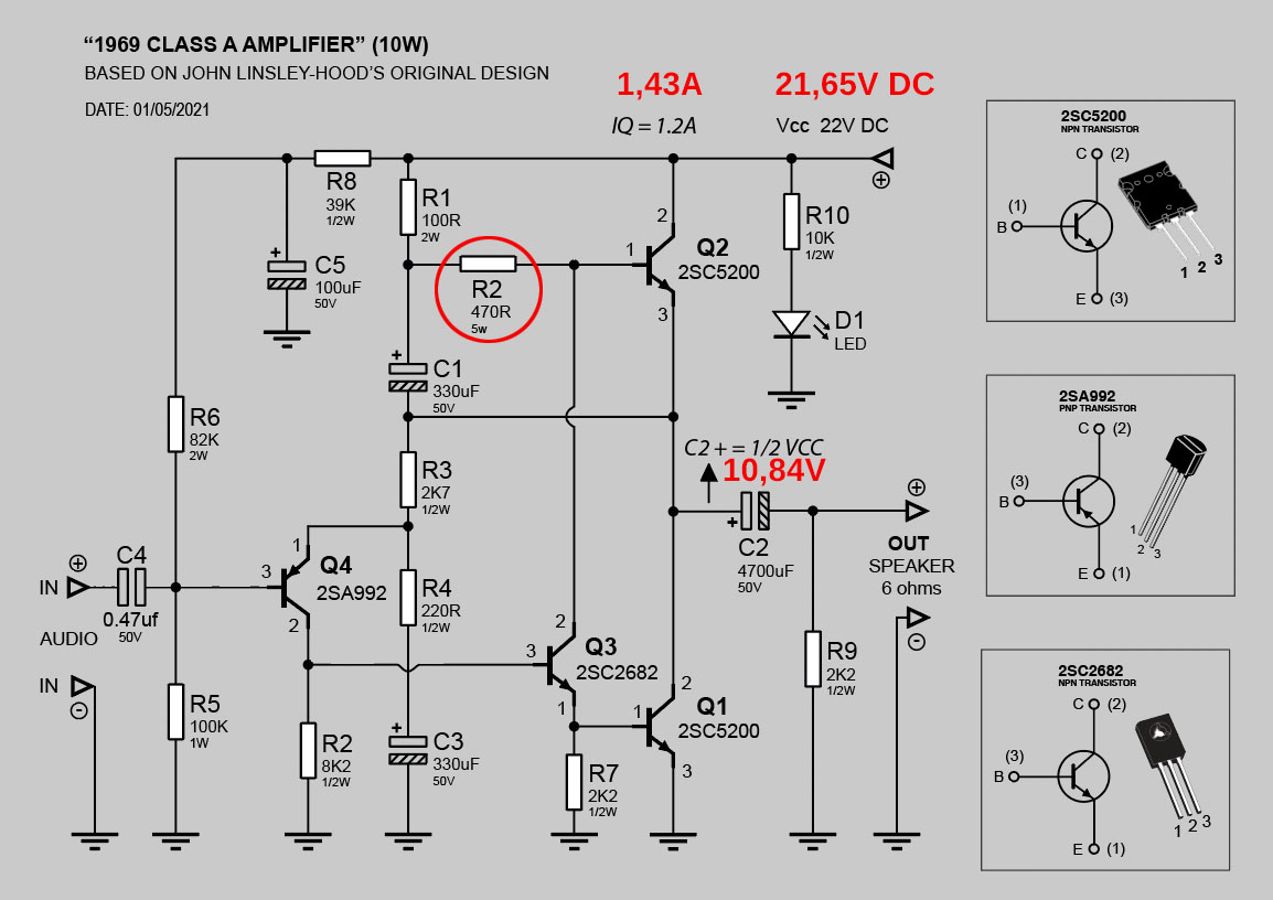

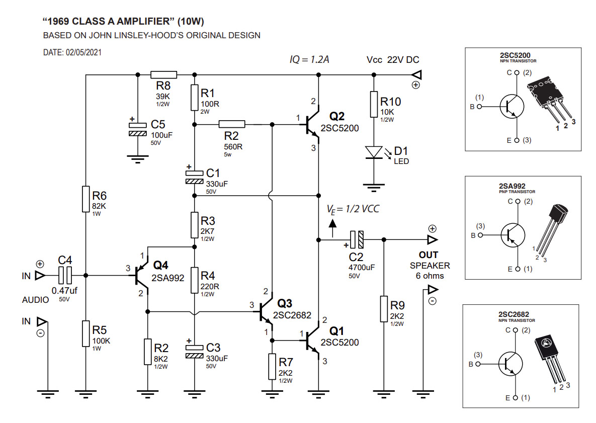

Hey guys,
I'm doing the last tests on my JLH 1969 10W (DC) before fixing the components on the board.
I removed the trimpots (KT1 and KT2) and put resistors in place.
My load is 6 ohms (speakers).
The current got high. 1.43A.
I will then increase the resistor R2 (470R).
I want to lower the current so that it is between 1.1A ~ 1.2A
Perhaps a 560R resistor? or 680R? in R2.
Sounds very good!!! Very crystalline
Att. Tiago Sierra.

Tiago! To reduce the current, increase the resistor R2. Check after heating for 30 minutes.
OK OldDIY, thanks! I will change.

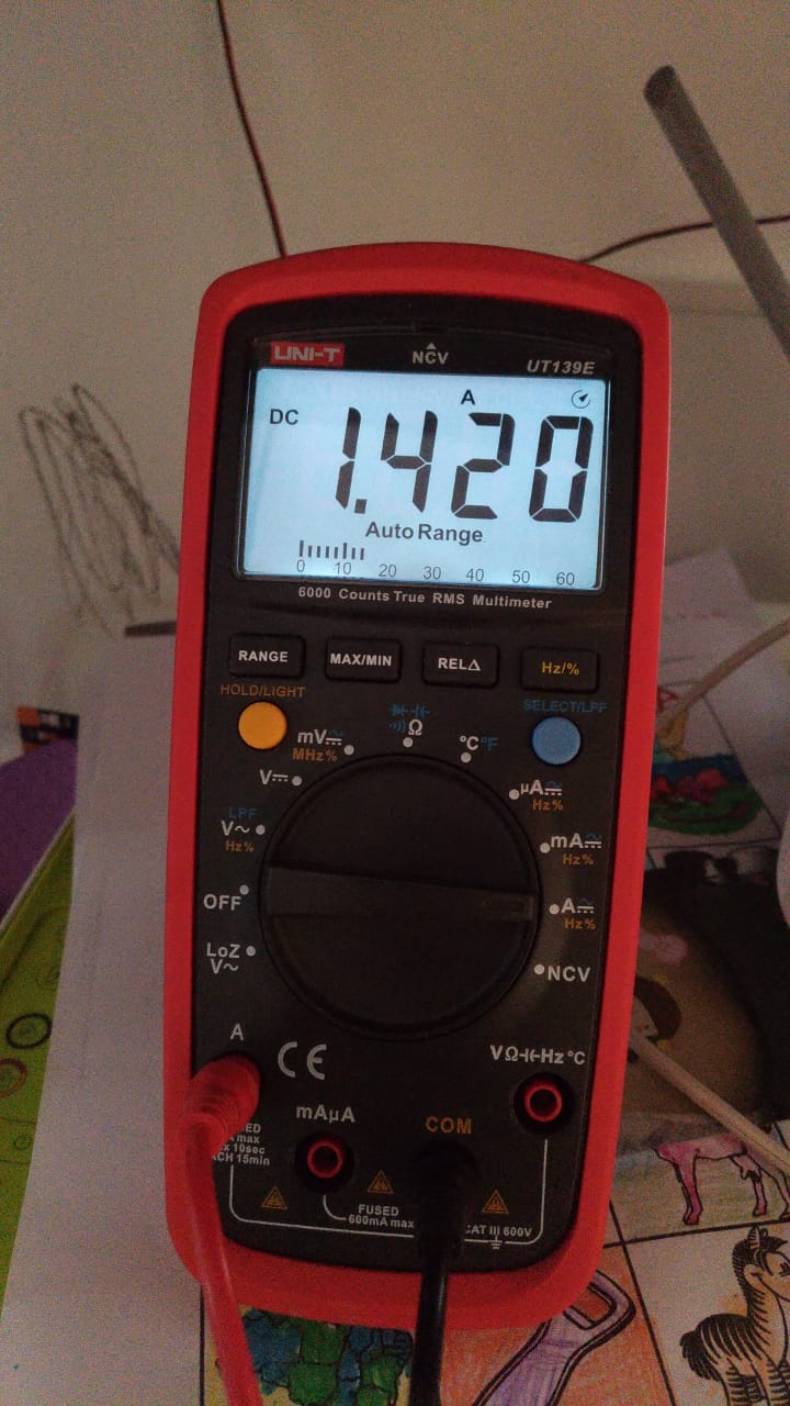

Amp ON (1h 30m)
Current: 1.42A
(still R2 = 470R).
Speaker 6 ohms.

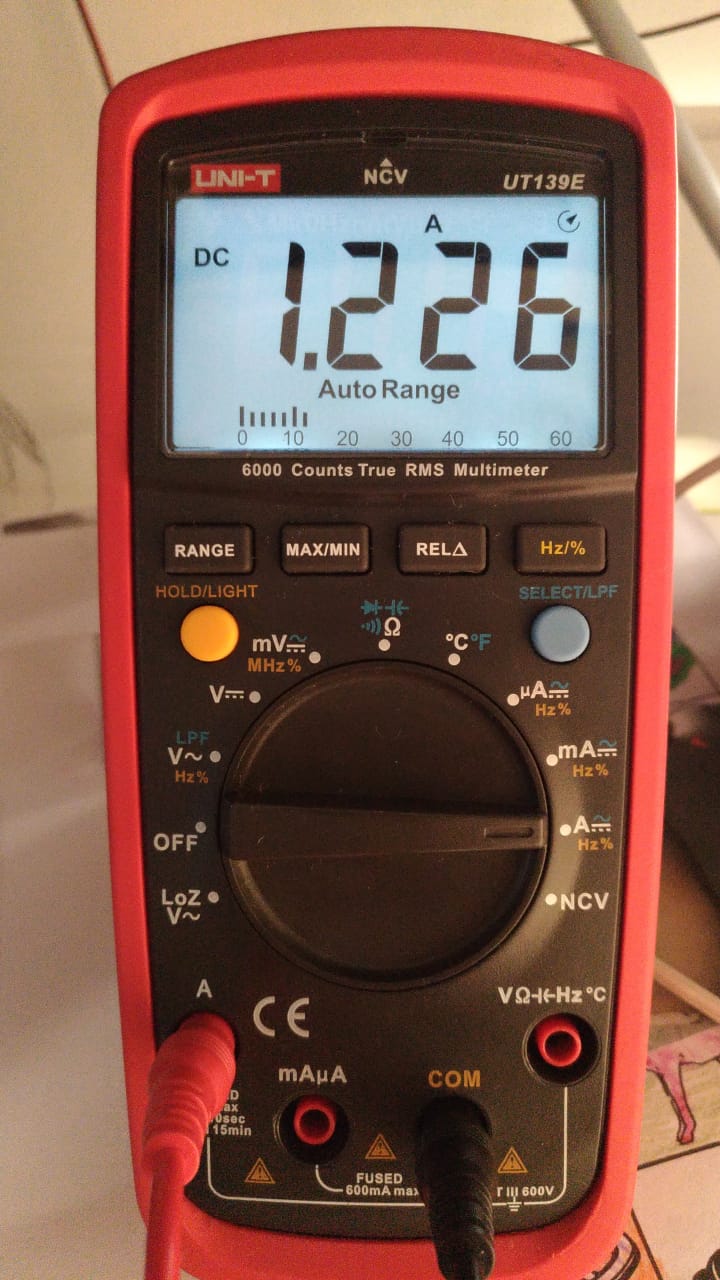

R2 = 560R
Hello oldDIY, I replaced the resistor R2.
I replaced the 470R with a 560R (5W)
IQ = 1.23A
I left the amplifier on for 1 hour.
Thanks for the tip.🙂

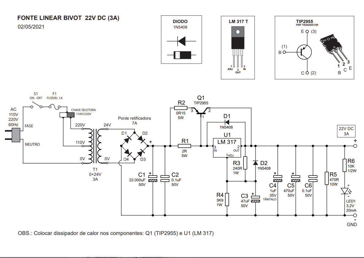

Hello Santiago44, I'm riding my 1969 JLH (10W) - Class A.
See my power supply and my amplifier circuit.
Transistors in the Q1 and Q2 amplifier circuit require large heat sinks.

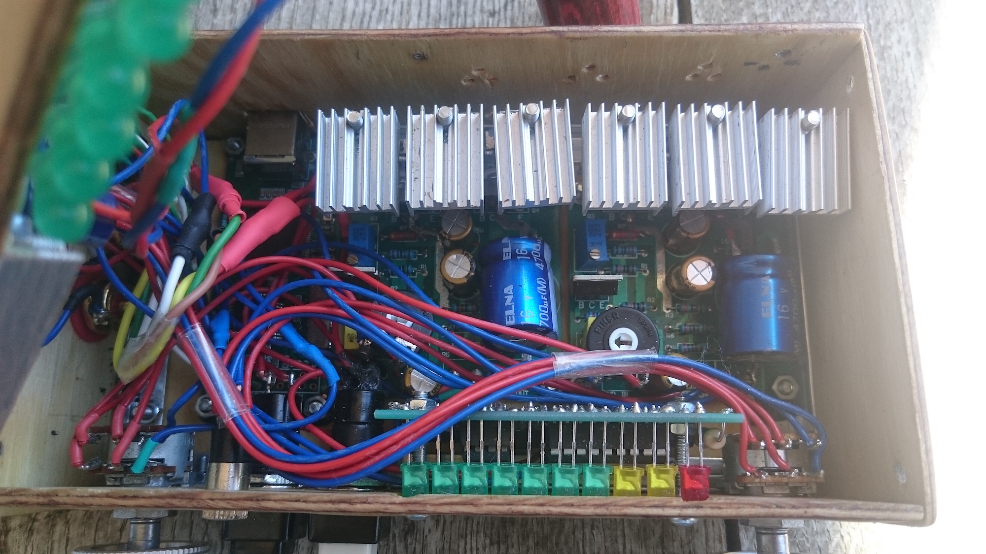

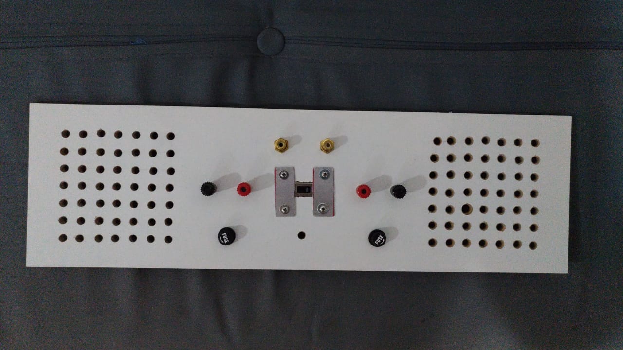

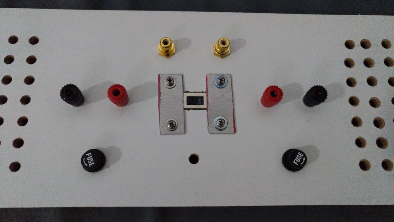

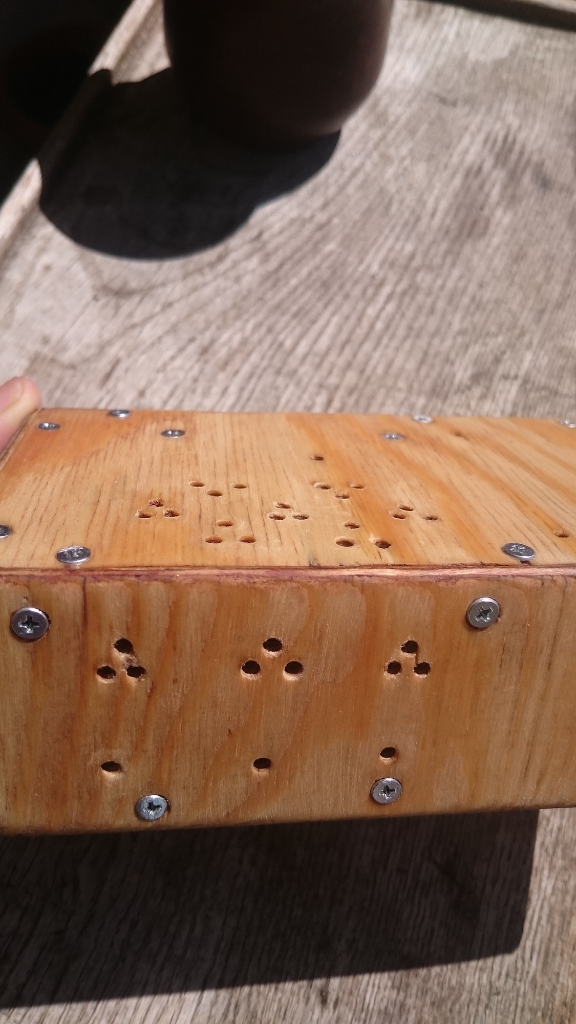

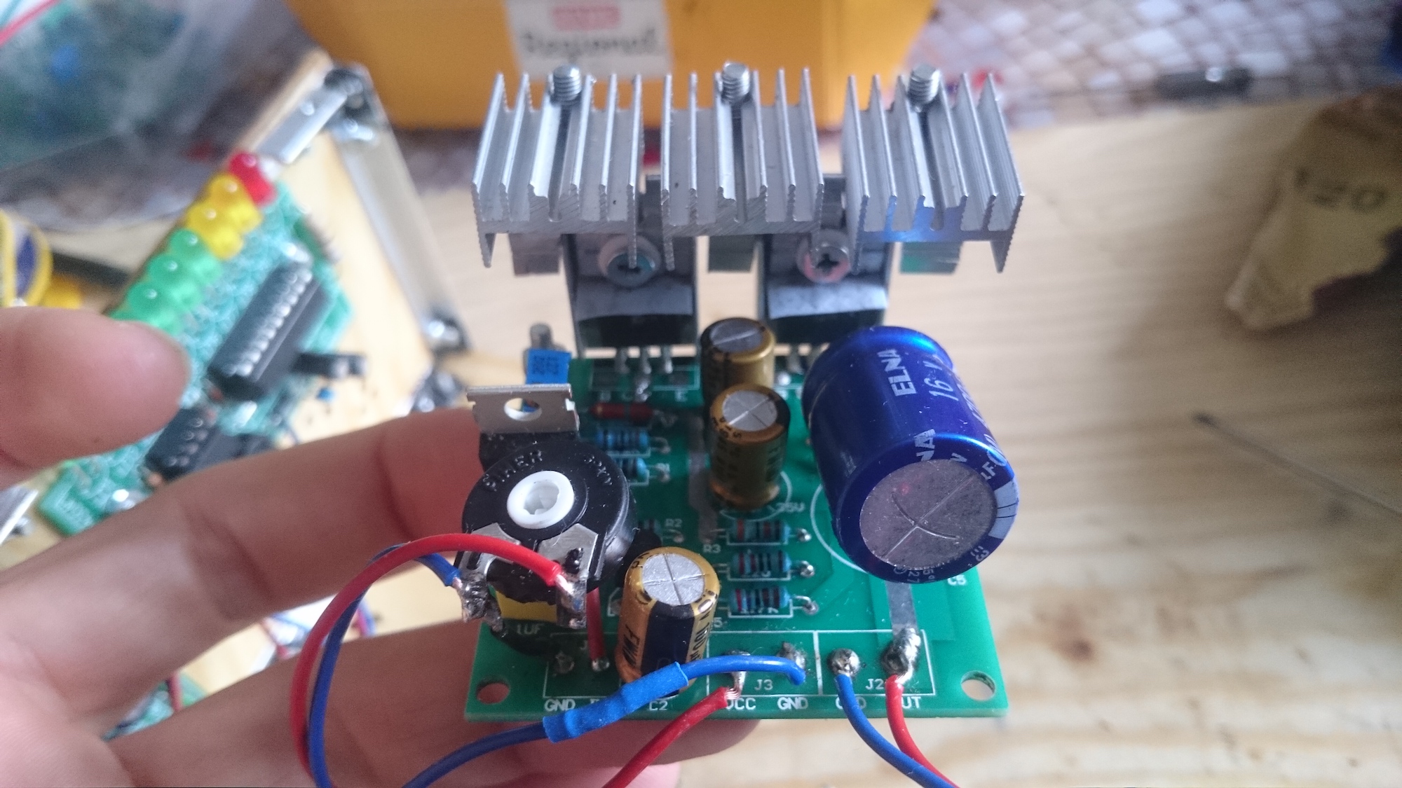

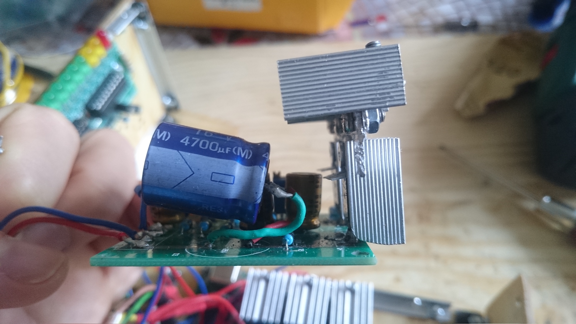

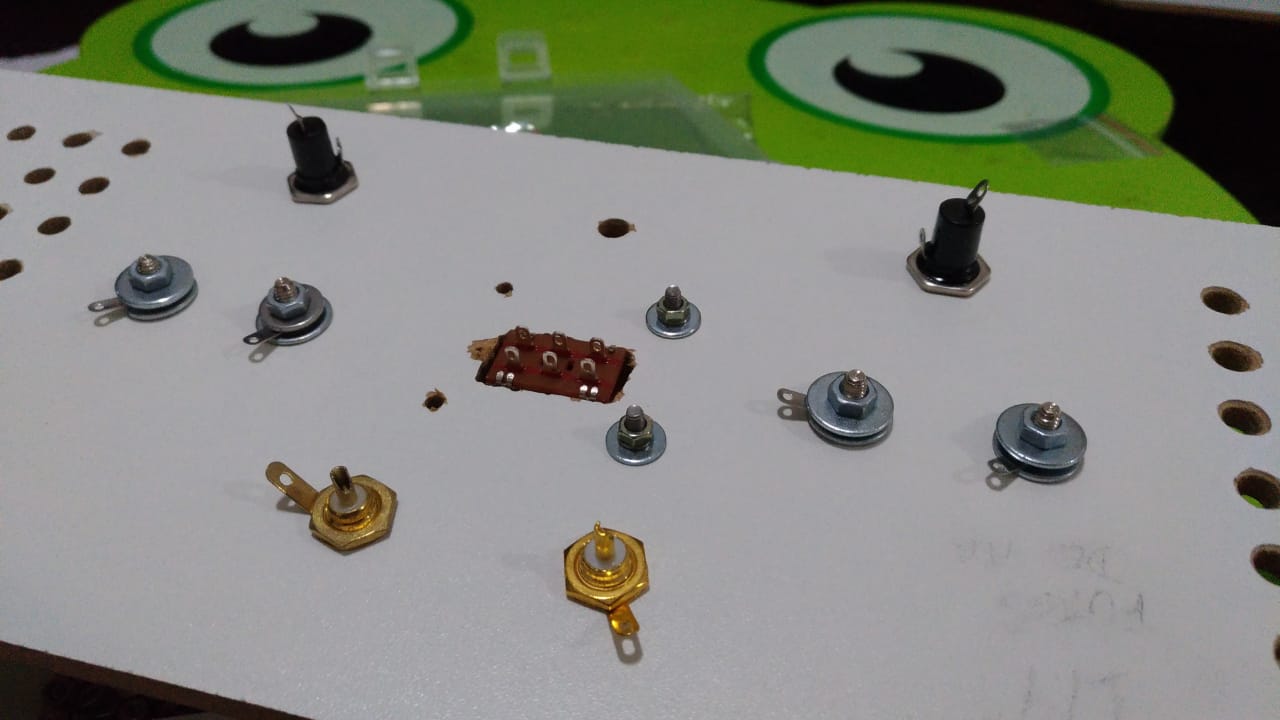

Dear Jbau and DIYers,
I'm quite happy to announce the birth of my new DAC/miniJLH, call it Gloria. That came to me in a moment were I found the sound to be just glorious 🙂
I guess I should had written before, but I was busy taking some definitions, testing and finalising the box. After burning out some resistor, I drilled more holes and now temperature seems mild and stable. Let's hope it lasts. Five heatsinks per board, bias current at 0.13A (+/-12 VDC).
Finally I solved the distortion problem soldering a 10K trimmer (0,25W) to the input of each board, bringing back the NFB resistors to their original values. These trimmers are also quite useful to correct the imbalance of the preceding input stereo pot (50K 0,1W currently, but I reckon that's too high, considering the extra 10K pots in each board). Of course, following @jbau observation and explanation, I removed the volume control after the amp's output. I wish attenuating at that stage would be possible, but frequency fluctuations is the least I want.
I replaced most Elcos with Nichicon gold, sound is much brighter than with the factory Chong-X. For the output cap I used the best I had at hand, an ELNA 4700uF 16V. It sounds correct to me, although the high capacitance compared to the schematic 2200uF might be cutting off low frequencies ?
Also increased the 220R before the VR to 1K, to bring down bias current to the actual point.
In the to-do list is to replace the film plastic input cap to something better. I tried some 2,2uF Nichicon Muse bipolar I had, quite sharp and detailed results but bass was gone. I read good things about Metallic Polypropylene. I might try some Wima MKP that are sold here but not cheap. Would be 1uF appropriate or will I need something higher? I've read people using up to 4,7uF for MKP input caps.
All in all, there are only details to be solved and a lot already learned. I'm quite surprised of the sound quality that ended up in a small box, although it was not my intention to have everything so tight at the beginning. Things just came in and the box remained the same.
All my gratitude to everyone else who helped me with their invaluable thoughts: OldDIY
