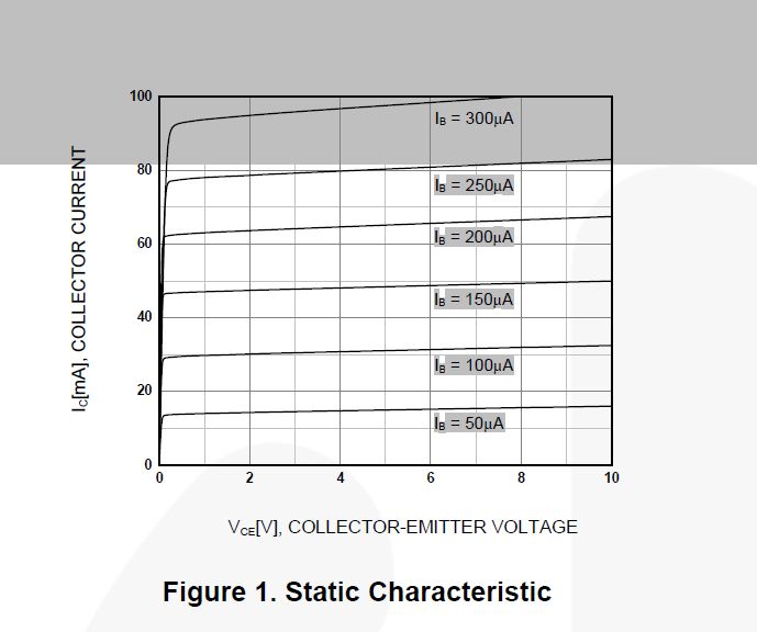

The graph shows the current gain 1616 starting at 10 ma collector current
Ah, got it. That graph is for Vce=2V. This chart more tells the story for line-level input, IMO.

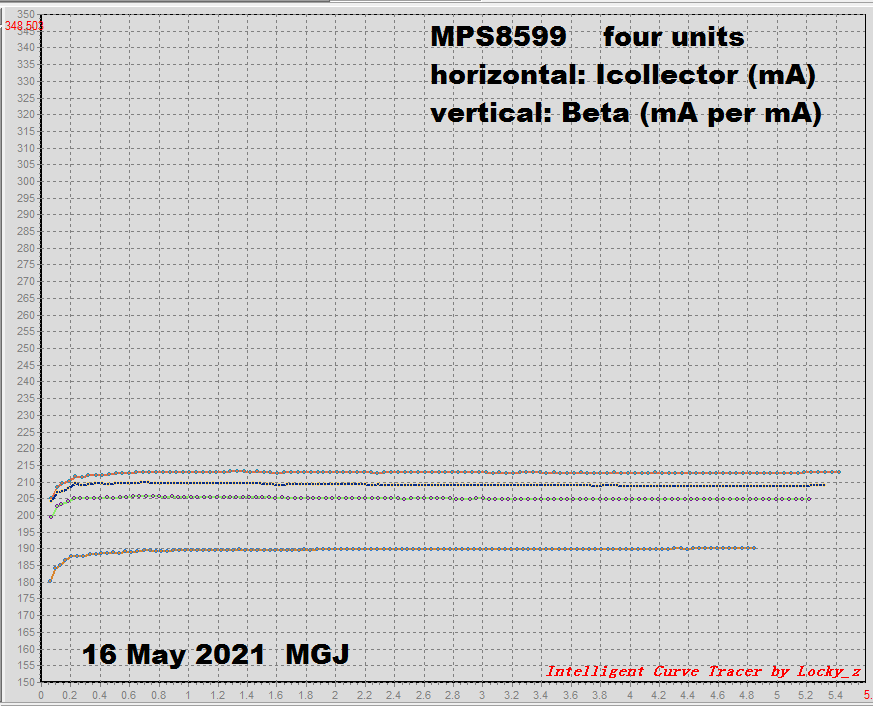

I measured Ic versus Beta this morning, on a few PNP small signal transistors. The plots are in the following Forum thread, if anyone is interested:
and here is one of them, to give you a taste without having to click over to the other thread. Click on the image to see it full size and undistorted:

That's very interesting, Mark. At what Vbe? Back in the day, the guys at PS Audio loved the 8099/8599's.
It's interesting that it doesn't "linearize" until say 300uA.

Answered in post #4 but I have a feeling what you REALLY want, is to gaze at the first attachment to post #2. Like most of the other plots, that one measures out better than the manufacturer's datasheet promises. Customer expectation management (?)

Wow, exceptional. And in EOL last-time-buy status. Will be in my next order, thanks.
