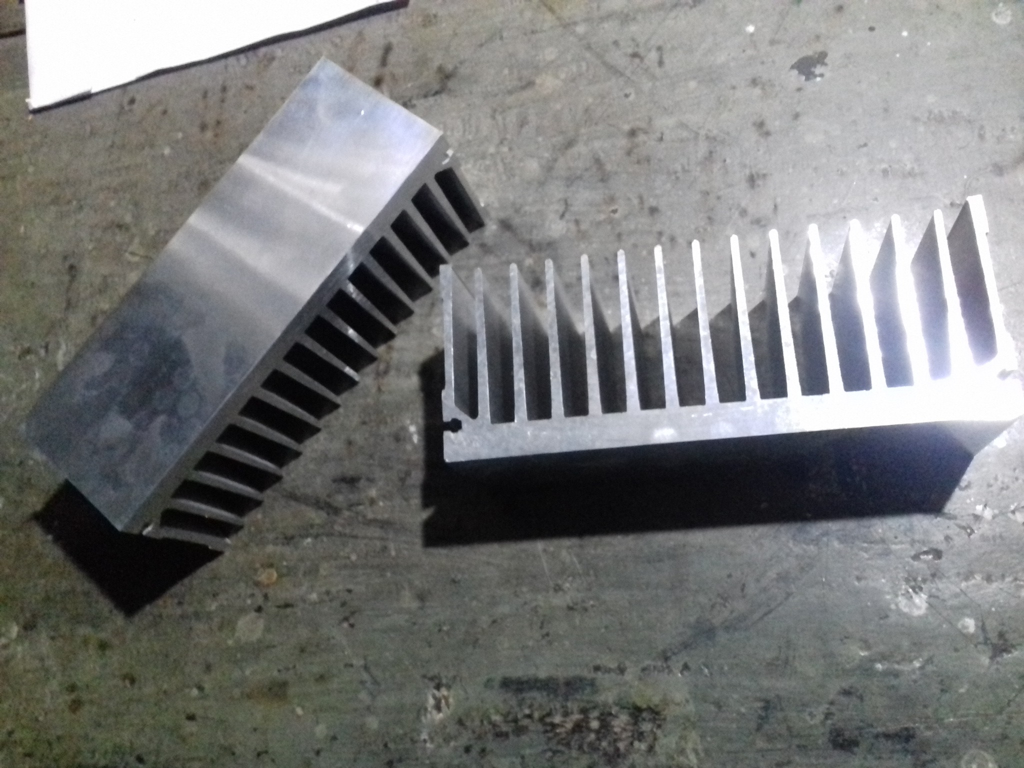

Back to my heatsink suggestion for the front panel - Quad seemed to like the idea of front panel 'sinks but large heatsinks aren't something stocked by many distributors. We have a local maufacturer here in Oz, who casts and finishes a wide range of custom heatsink products, sells direct and the quality is excellent, considering the necessary techniques. Fine for me, but I'm sure UK and other global members would prefer your own local source though I've not seen many in advertising.
Most heatsinks sold by distributors are small, extruded forms with low thermal capacity or occasionally, chunky custom shapes that look like props for a Sci-Fi movie. Here's what I think will suit, from the Conrad heatsinks range. It's type MF20, Height 75mm with a thermal resistance of 0.55 K/Watt, which is a little tight for John Ellis' 0.5 spec. suggestion: https://www.conradheatsinks.com/products/flat100_350.html
The UK suppliers I mentioned hold stacks of them but a search may skip some and there are rather a lot to scroll through,
I missed suitable ones when I searched so finished up buying something dubious really. 150mm square, loads of serrated fins. Sometimes it may be easier to find something via searching a size on google.
Heatsinks on the front with class A?? How hot? Front or back 2 could be used for stereo with a panel jointing them. They could also be mounted on the back panel of a bought case.
Audio power transsitors. RSWW are likely to stock a few in small packs - 2 for stereo. CPC are Farnell's smaller order supplier but don't offer as large a range. Small packs? I haven't looked.
John Ellis gave an estimated heatsink rating requirement for the 4 power transistors plus the "regulator", as 0.5K/W . If you check the link I posted, my choice was a simple flat-backed 'sink rated at 0.55K/W . That should serve to say that with a supply of 27VDC and a total 2A current, it translates to 54W and a rise of the suggested size heatsink temperature by 27C to 47C, during typical UK summer weather. That's certainly warm but not dangerous until someone tries to make it so.Heatsinks on the front with class A?? How hot? Front or back 2 could be used for stereo with a panel jointing them. They could also be mounted on the back panel of a bought case.
I prefer a low profile box for the efficiency. With a tall box and correspondingly tall heatsinks, you lose efficiency according to a sqrt 2 factor. In simpler terms, you get less than 50% extra cooling for a 100% heatsink height increase and that's rather disappointing) I plan to fit the sink to a front panel, approx. 75mm high x 230 wide, allowing an extra 30mm width for the power switch and indicator. The plan being to wind up with low profile case not only for efficiency but so that fits with room to spare in typical Hi-Fi furniture shelving.
BTW, when you check most heatsink suppliers wares, you find many of them are flimsy little lengths of extruded alloy with low efficiency - they really only suit PCB mounting of one or two semis. The larger area types may look big with plenty of room but looks don't deliver the "Coolth". Thick, heavy sections and well spaced fins can.
Insulating washers have considerable thermal resistance. If you mount each transistor directly to its own sink without insulation (and don't ground them, obviously), you can get much better performance. You'd have to be wary of the sink now connected to output (collector of lower transistor) capacitively coupling to the output.
+1 for the Conrad sinks btw, they also do a range incorporating a flange for TO3 devices, much more efficient than a bolted-on bit of aluminium angle
Good question. Think of the supply chain and the limited number, sizes and types of components available from local component sellers and agents in the 1960s. As I recall that far back, you couldn't easily buy from industrial suppliers without a business account. Practically, it came down to what retail shops stocked and that was usually a minimal range of small, low power and universal type bits and pieces.Is there any reason for which JLH proposed dedicated heatsink for each transistor? Practically i don't see any advantage of doing so.
The heatsinks JLH chose were a universal type, probably about the cheapest finned type available for TO3 transistors and it was common amateur practice then, to have each transistor on its own heatsink. In his example, they were mounted in a short duct which enhanced the air flow by convection - clever I think, making best use of the thin extrusion but not so pretty in your listening room.

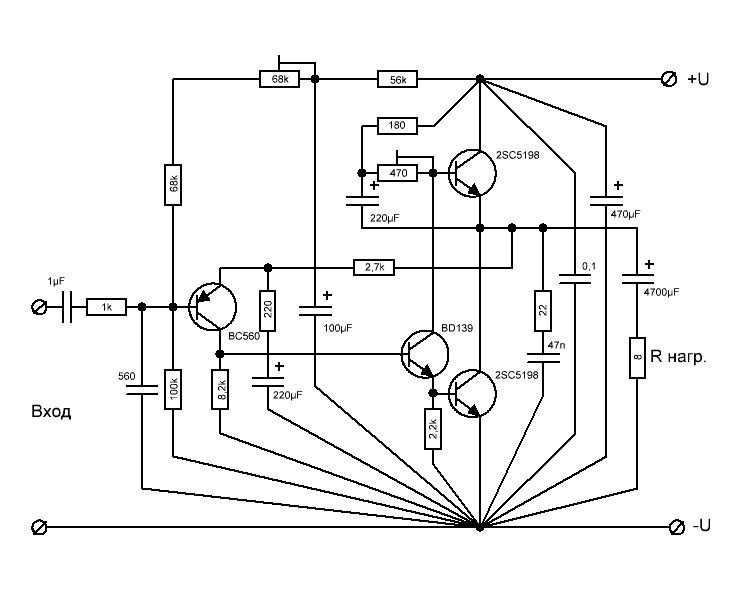

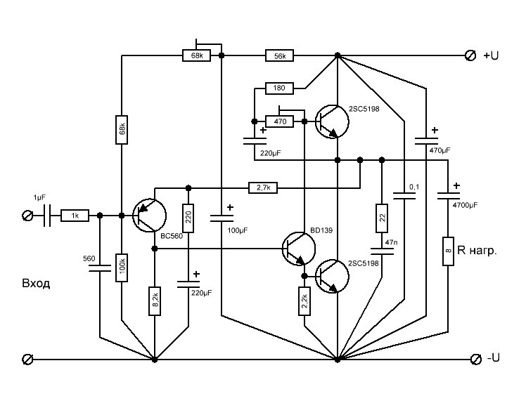

Some people suggest connecting negative to the emitter of the lower output bipolar transistor. This is where the main current flows.заземление питания
The minus of the second electrolytic capacitor and minus the speaker are also connected there.
In the figure, a different connection point is selected, but this depends on the topology of the board. Helps to avoid main current flow in a weak signal circuit.
- JLH 10 Watt class A amplifier
