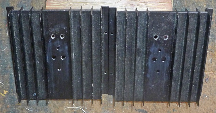

Hello there,
My heatsinks arrived
They'd got holes for just one transistor so I started to file out the other holes, there were a couple of plastic bungs with wire in each of them. I can drill the rest of them out.
They are 125 square a little larger than the ones JLH used, otherwise very similar. Somewhere I've got an alloy sheet that I can cut to make a chimney. Many thanks to Ian for explaining what it was for.
More eventually.
Cheers - J

Without wishing to spoil your fun, how do you plan to fit 2 transistors to (apparently) the same mounting bolt? Perhaps you're going to shift the second transistor down to another position as well? good luck with that, because you should be using an accurate drill size and hole location for that work.
Note that the "bung" is probably a flanged insulator bush (buy from any components seller) and one should fit neatly in each of the transistors mounting holes, providing insulation for the bolts which would otherwise short the transistor collector to the heatsink (likely ground) and probably kill the power supply. Aternatively, if they are plain bushes, located in the same holes as base and emitter leads, theyre just insulation or aids to fitting them. One of the bolts will also require a small solder tag in order to make a a connection to the collector.

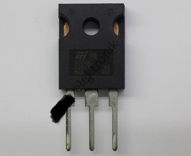

Hi.What about BD249C.Are they better than TIP35C ? I can supply for my JLH projects 8pcs.It is hard to supply TIP3055 here.
I also love TO3 but it is hard to drill for me. Plastic ones only needs one drilling. TO3 needs 4-5 drilling per transistor.

From a datasheet, BD249C looks OK and handles 10 times the current you need. In most respects other than gain (hFE), it is adequate but they will be Multicomp products (several sources and specs, including ISC) and TIP35 is usually to an ST Micro spec. We have discussed these recently and they are probably your best option. These may also be somewhat variable but they can be bought from many distributors at fair prices
The datasheets for your sources may not match with original specs and whilst not necessarily fakes, it is difficult to know what you have available and whether they are genuine to any spec. at all or just their own manufacturers spec. It's difficult to say at this distance, what your options really are.

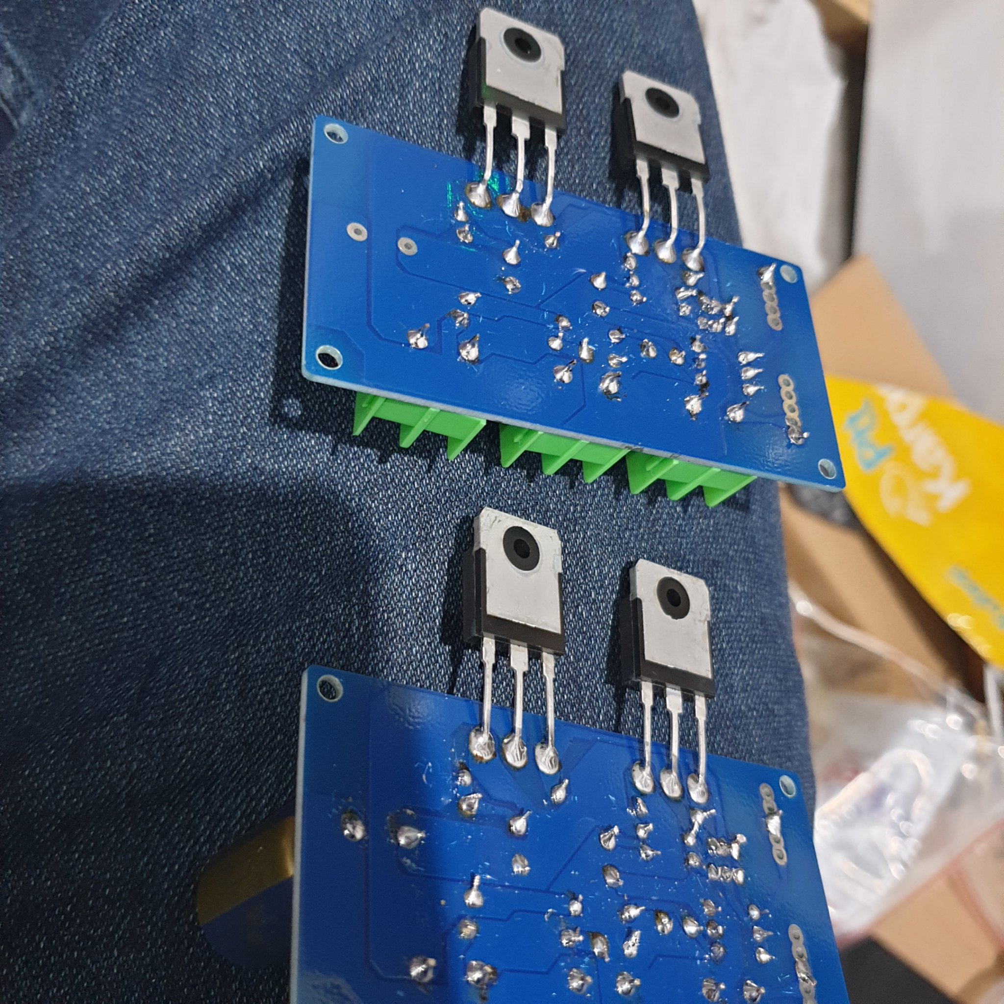

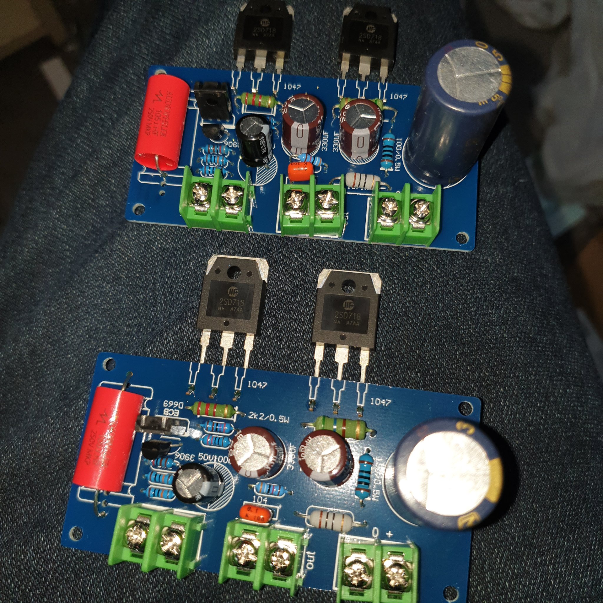

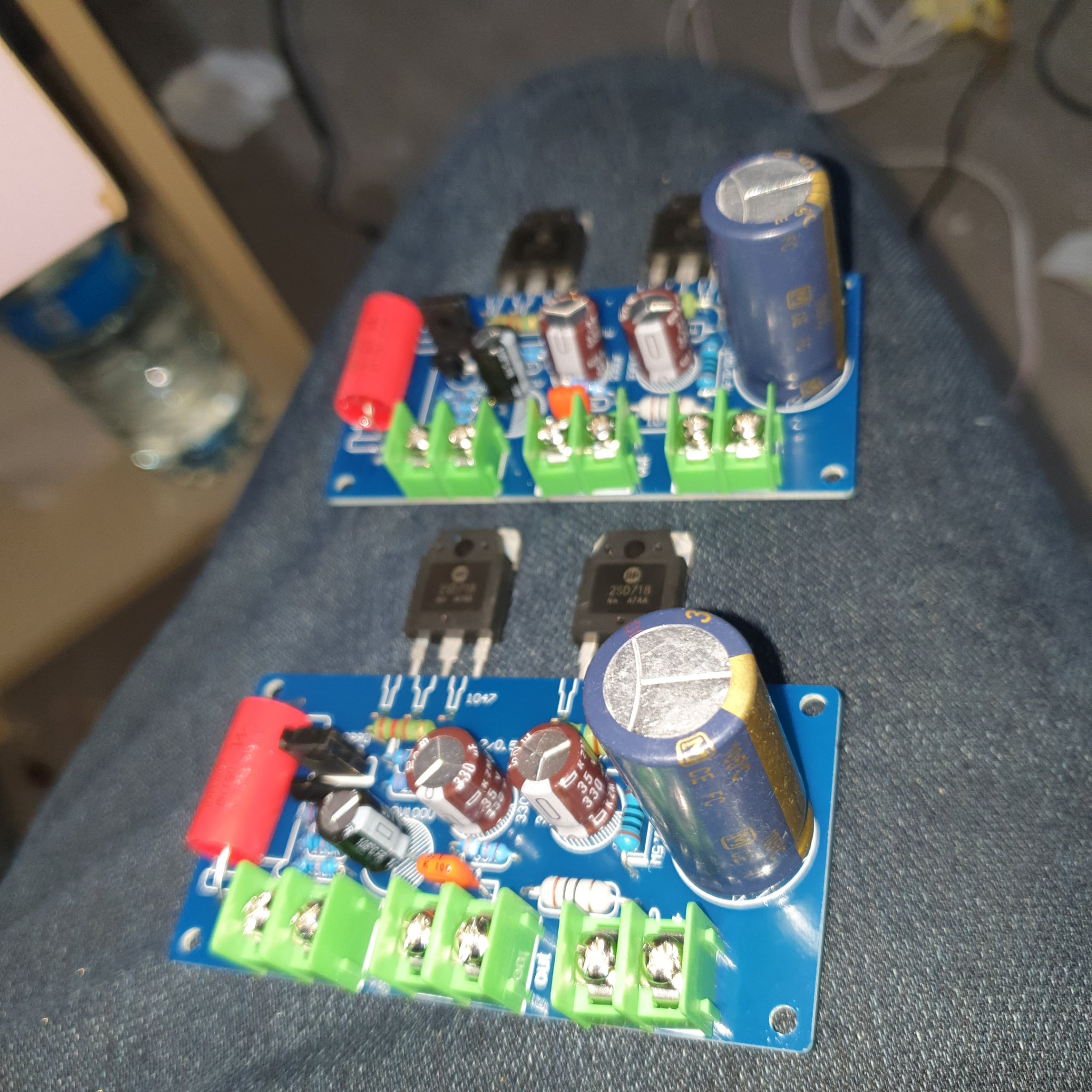

I have soldered the kit. There was 2 caps which i did not like 100uf 50v sam young ( i put panasonic fr ) and output capacitor Decon brand 3300uf 50v i have used Panasonic Fc 3300uf 35v. I have soldered output transistors like that. I hope there wont be any problems. It works at 24v. I also bought meanwell lrs150-24 . Maybe i can lower it to 21v for my 4ohm speakers.
Veysel - I take it that you used your BD249's?
They seem to be much the same as TIP35 - essentially a European registration of the TIPs.
One minor difference is that the 15A current gain is lower - so it also allowed the manufacturers (not sure if TI registered the BD249 or a company that bought the manufacturing line (Power Innovations (is this the same Power Innovations still going?) as the transistor dept went to Bourns next)) to sell some TIP35 chips that didn't meet the TIP spec., I guess.

Hi. I used 2sd718 of the kits. I will use bd249c instead of mini jlh circuit which has tip41c.Veysel - I take it that you used your BD249's?

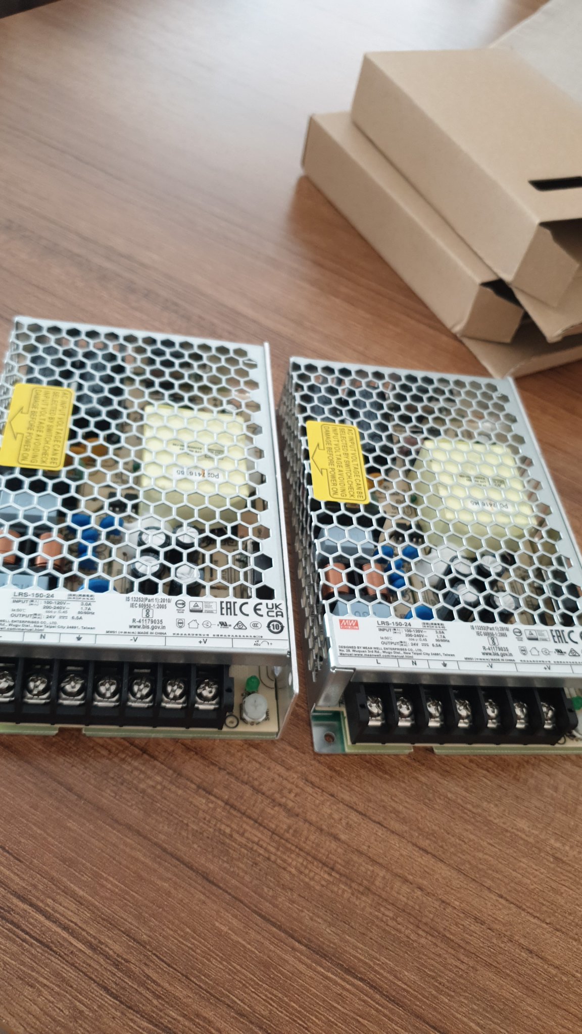

Good work, glad you like the sound, with SMPS too! So, did you try both channels on the same supply to see if you could hear any difference? I have tried that with many transformer power amps - sometimes I can't pick any significant difference to separate supplies. Other comparisons show some obviously different stereo effects for reasons we may not have realised.
