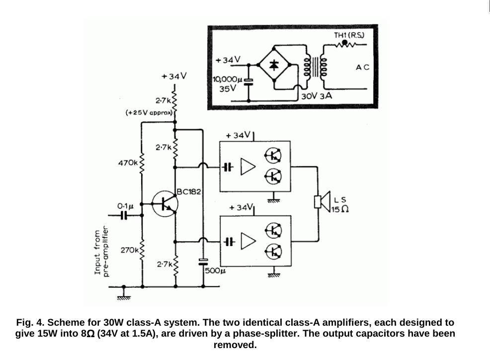

I am just curious if using symmetrical suplly jlh sounds better for bass amp because of lack of output capacitor.
For pretty obvious reasons the output caps are not needed. There is a bit of a WW missprint in this but 2x15w = 30w versions have been built.
The later designs over the original are refinements really. The route to perfection on all is still mostly matched power transistors.
A lot of people seem to miss one of JLH's main points - measure how much power you actually need. 15w is mostly mentioned due to a rather famous 15w high quality valve amp. As he was using one of those previously he measured how much power he was actually using. When HiFi kicked off and every man and his dog wanted it power was a status symbol not what was actually needed.

One valid reason for omitting the output capacitor is capacitor distortion. I suspect that modern SMPS high capacitance high current units with low ESR and ESL would have less distortion than the older types, but I've not attempted to measure any. One reason they are omitted in higher power designs is that it is actually simpler to use a split rail - and cheaper as lower voltage capacitors can be used.
But there are other effects. Each capacitor which is added in an amplifier chain will give rise to potential overshoots in a response to a signal. For n capacitors there are n-1 swings past zero (-consider a single RC filter - that never crosses zero in response to a step transient, only decaying exponentially) and the size and frequency of those crossings may give rise to some effects on the bass notes.
OldDIY has also mentioned the effect of capacitor-speaker interactions. That would depend on the speaker behaviour at lower frequencies, so there are several opportunities for "capacitor effects" which actually aren't specifically distortion related.
This does not mean that capacitor outputs should be avoided. I'm sure one or two on here will have measured modern capacitors for distortion, but I 've not searched for any reports. What does seem to be important is that the PSU should not droop either, as Ian discusses, or at least not on the centre rail if a capacitor is used. Generally I have found the best results with stabilised PSU's when using capacitors. At least that will avoid power supply ripple effects from a varying DC supply voltage from creating unwanted "bass" signals.

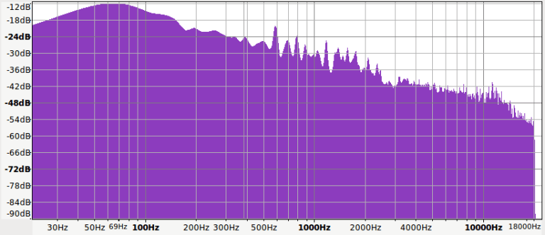

The post (#9307) was some days ago, but It could need some clarification for the power needed to reproduce audio generally. JLH is only 10W in an 8R system so it is soon compromised by bass demands with typically low-sensitivity hi-fi speakers in medium to large rooms. Conversely, that makes it quite popular as a tweeter driver for electronic crossover speakers, where 10W of high frequencies can be plenty but matching to midrange and bass speakers might then require 30W and 100W power respectively.Assuming the same load and efficiency: 10 - 20 Hertz = 10 kHz - 20 kHz.
I thought;-)
Simply, the energy to shift the volume of air necessary for the same SPL at all audio frequencies increases as the frequency falls from 20kHz to 20Hz.
Correspondingly, when we look at the energy spectrum of well recorded songs, we find SPL typically falls from around -12dB at 50Hz to -55dB at 20 kHz.
