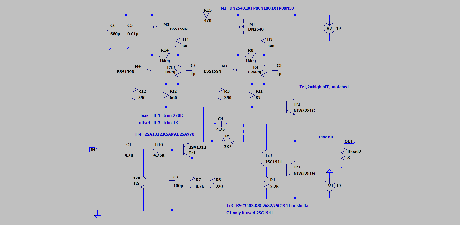

For a PCB design I am thinking about making C4 1mF and C5 10mF with a 10mF PSU capacitor on board. C4 needs to be a tenth of the output cap to drive the bootstrap resistor but maybe 22mF is not really required if people are not likely to need extended bass.
As for the resistor setting the current, this was 639 ohms (470+100+47+22) and the target was 1.2A. But the point is it may need a different setting in a different build depending on the transistor gain.

To stir up this topic again, one copy has already been made according to this scheme, the owner is very satisfied with the sound.
Depletion mosfets were deliberately used because of their advantages over classic bipolar CCS

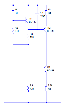

With the observation that my C5200 JLH exhibits quite a high change of current with temperature, I considered the heatsink requirements in a little more detail.
The datasheet I have shows a rather alarming change of gain between 100 at 25C and 180 at 100C. This gives a dG/dT of 1.8/75.
If the power at room temperature (say 25C) is Po, the change of power with temperature will be 1.8Po/75. Therefore to ensure that thermal runaway does not occur, the total thermal resistance should be less than 75/(1.8Po).
If you are running your JLH at 27V, 1.2A the power is 32.4W. That makes the total thermal resistance (max) of 1.3K/W. For transistors such as the 2SC5200 the thermal resistance is 0.83K/W. Allowing 0.4K/W for an insulator gives a total of 1.25K/W (approx). Two together make 0.625K/W. So the remaining thermal resistance, which the heatsink must be lower than, is 1.3-0.625=0.675K/W. That means my 0.7K/W is marginal!
If you run your JLH at 32V and 1.2A as my variant would like, that's 40W dissipation and needs 0.4K/W.

I now offer a simple solution to the 2SC5200 current control whether or not it runs away. This is my first pass at this simple solution but has not yet been tested.
Tr1 is a simple "amplified diode" just like that used in many Class AB amplifiers. It sets a voltage governed by the ratio of R1 to R2. But most of the voltage is dropped across R3 so that the CCS transistor Tr2 operates at a base voltage of about 1.2V. Therefore, if this bias circuit is fed from a constant current (approximately a high value resistor running from the supply rail) the3Vbe's or about -6mV/C is applied to the base of the transistor Tr2. That provides compensation for Tr2 and a further 4mV/C reduction across the emitter resistor.
Values for the resistors may all need optimisation. In this circuit, the simulated standing current actually reduced when included in the JLH-C5200 circuit I posted earlier. This will permit either a smaller heatsink to be used or to control the current, full stop.
Tr1 should of course be mounted on the output transistor heatsink. The circuit may overcompensate if Tr2 does not warm up by adjusting the resistors should permit optimisation. I assume that Tr2 would eventually warm to some degree due to heat from the heatsink raising the temperature of the whole amplifier enclosure. The simulation applies the same temperature change to all transistors currently.
