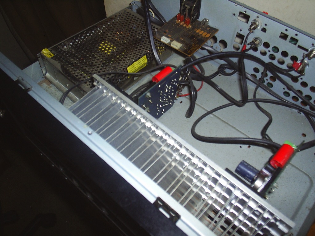

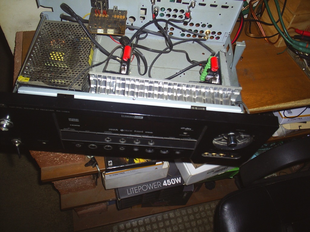

My JLH 1969 amp build before the pandemic
PSU: SMPS 24v 10A

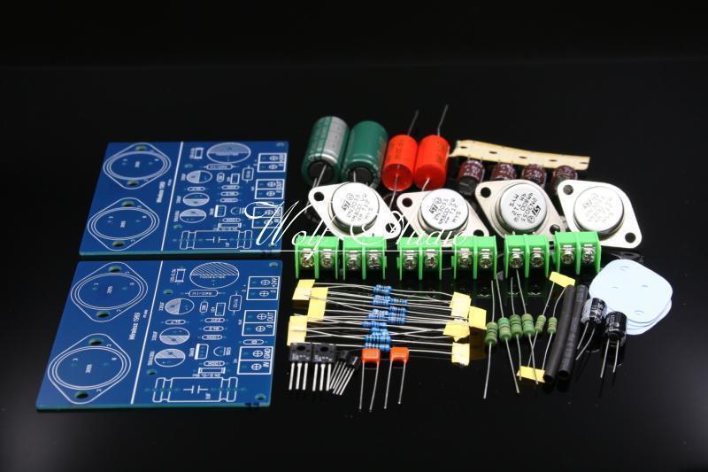

Board: SC HOOD JLH 1969 Gold seal ST2N3055 10W+10W Class A Stereo Amplifier Kit (Ebay)
Chasis: (A Gift) A Old yamaha receiver RX-V 463 great heatsink
