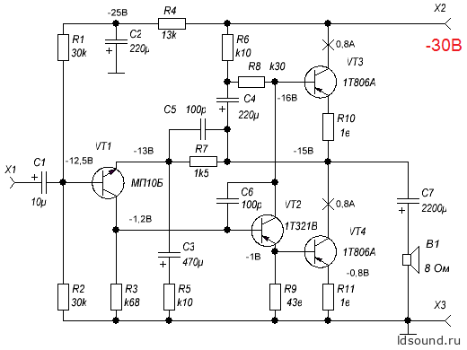

mjona- I assume by 500uF base modulation cap you mean a bootstrap? Unless the JLH circuit you referred to (page608) has a different configuration to the 1969 version. Which month was that?
In any case, the Calvert circuit is not a push-pull as you say and probably does not match the JLH distortion figures as a result.

Re your first message, the Wireless World issue for page 608 from December 1970, reference Fig 3, shows the voltage drop across the 0.5R resistor arranged to pass a.c. signal through the 500uF capacitor to
Tr2 base.
I have simulated this arrangement in The JLH1996 amp with some changes to align with Calvert's design - supply rails reduced to +/- 14V. The peak current and output voltage is slightly higher in this when the 500uF cap is in circuit than when it is out.
I did not go as far as reducing the values of the bias network resistors for Tr1 in my simulation re the Calvert circuit. It is what it is.

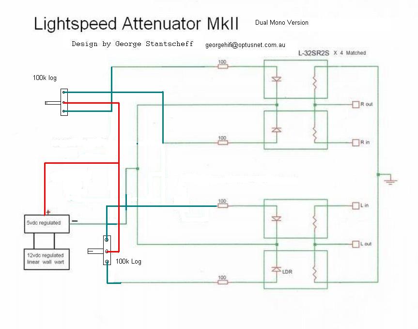

A solution could be build my own stereo ladder stepped attenuator, using for instance Elma 4 pole 47 way switch, A47-SERB4-THT with well chosen resistor values….. fixing the problem with making levels hard to set when volume control cranked right down.

Sound wise, between the two buffers (gain=1) I prefer to use the lightspeed attenuator (a series/ shunt LDR arrangement) over the standard potentiometer. IMHO the lightspeed attenuator excels in transparency and dynamics of sound.

mjona- thanks for the circuit reference. The 500uF holds the PNP BE voltage (more or less) constant and ensures it is mostly constant current. Not a bootstrap.
Though I was surprised that JLH recommended a transistor like the 2N4919 which is a slow epibase device. The 2N2905(A) was rated at 3W so a better choice may have been (back then) a 40362, 2N4033, or 2N4036 or today, a BD140.

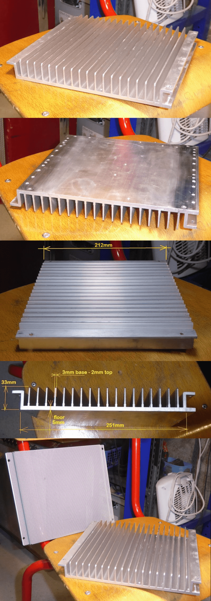

My question is : would the radiator below be convenient for such a project ? The idea is to use it as the top of the amp, and install the four power transistors flat in contact (plus conductive paste) underneath, on the bottom of the radiator.
Here it is :
I am a noob about designing-building Solid State amps :confused:... So thanks to let me know ! ;)

The main difference in the cicuit submitted by A.H.Cavert is the omission of a 500uF base modulation cap between Tr2 emitter and base. The omission converts a push pull system into one that is single ended,
Hood's own comments on the 220uf and his reasons for doing it also why he changed it in the 2023 circuit

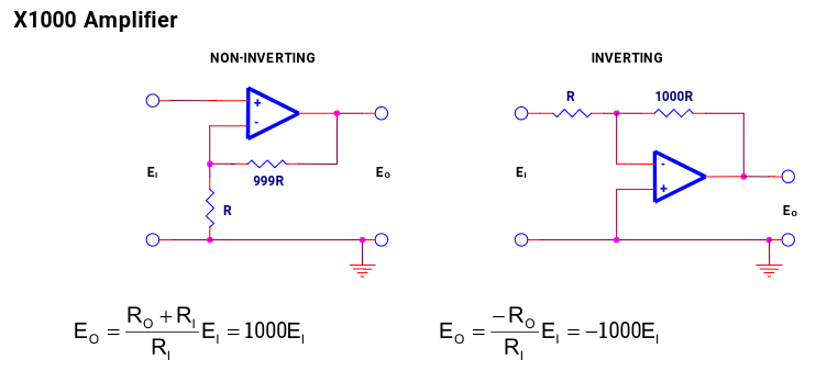

AjohnL - you seem to be confused between op-amp gains. In the non-inverting configuration the gain is set by (Rf+Rg)/Rg where Rf is the feedback resistor and Rg the one which goes to ground. In the inverting configuration the gain is (-)Rf/Rin.
In some ways yes as generally I would choose inverting. ;) In fact I can't recollect using a none inverting at work or at home with gain. From https://www.ti.com/lit/an/sboa092b/sboa092b.pdf
;) Slap my legs. However I do realise that these sums are only correct in high gain op amp type situations.
