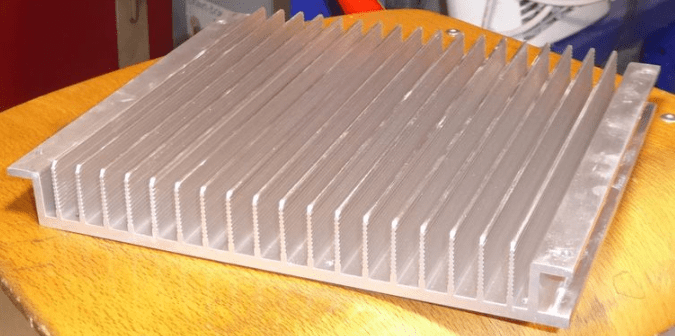

Area 3400 sq. cm is enough. It is advisable to arrange the fins vertically for better cooling.
You will need insulated thermal pads under each transistor.
Use racks to mount the PСB.

Yes, my intention was to use the radiator horizontally as the top of the casing of the amp, just like in this position below, so the fins are vertical :
The circuit and the transistors would be installed underneath the radiator itself, with insulated thermal pads - you are right to remind that crucial point to me...

re tubelectron's heatsink plan:
As OldDIY hints, to better use that heatsink, I'd consider slicing it into 2 pieces, 100 x 251mm and use them for the sides of the box, such that you have vertically oriented fins instead. This would approximately double the available cooling by convection, which is most likely necessary for home use, since a heatsink mounted on top of the box is likely to stay hot and painful to touch, since it lacks convectional airflow and that's what vertical fins are for. Also, others in your home would probably require repeated warnings about touching it and of course, not placing anything heat sensitive like LPs, CDs, plastics, papers, books etc. on top of the amp in any event.

Ah, OK - I undestand now what you really mean (as @OldDIY also, I guess) by vertical fins, that is to say this arrangement below :

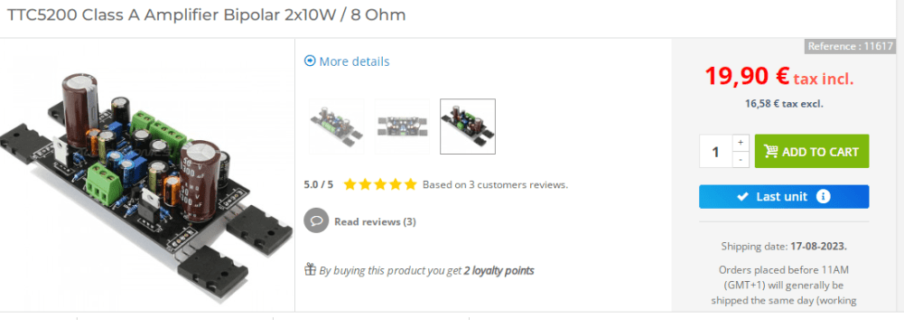

Yes, @huggygood : that's the circuit I was thinking about... To use that leftover heatsink !

Tubelectron, just substituting a very cheap pair of small PCBs (around 2UKP) will be better than trying to split that existing board or run leads to both pairs of output transistors. e.g. https://ae01.alicdn.com/kf/H84284d6...mplifier-Bare-PCB-Board.jpg_220x220.jpg_.webp
So let's go on that then.
the pcbs are great, there are already bias and midpoint potentiometers and nothing prevents them from being converted into TOP3 or to247.

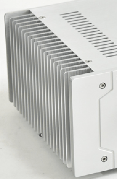

The photo of JLH's build in Wireless World showed the heat sink fins face to face within flat sides column forming a square shape chimney. That wasto create an cooling updraft and keep hands off. There are no rules that diy cases have to conform to suit entertainment unit appearance. l have one of those rotatable CD 4 sided furniture pieces on a shelf, it is roughly 30 cm high incidently coincident with vinyl album diameter. JLH engaged a cabinet maker to build a radiogram cabinet to house his various pieces of audio equipment. One could also look around to find some form of furniture to serve a similar purpose. These days a lot of people have well equiped home workshops for multiple trade uses. Of late there has been a growth in community workshops where people can share their skills and know how.re tubelectron's heatsink plan:

I think we all have to experience the thermal design of class A amplifiers to find what works best at keeping the electronics inside and the exterior surfaces of the box cool enough for domestic use. Otherwise, I find that casual contact with undersized, exposed heatsinks at 60C+, is a painful experience, resulting in much profanity and oaths, I can assure you. Dust accumulation and corrosion over time, is also a PITA with top mounting heatsinks. Its not something I'd like to revisit anyway.
I also commented, along with others here, on Linsley Hood's chimney form of heatsink construction of his prototype, back around # 9276. It really is worth considering the merits of optimum airflow over the largest heatsinks you can fit because rebuilding an ineffective design is a cost of time, materials and regrets that could be avoided.

Given the cost of the Audiophonics kit, I'll give it a go with the horizontal top heatsink, as originally intended, just as a test...

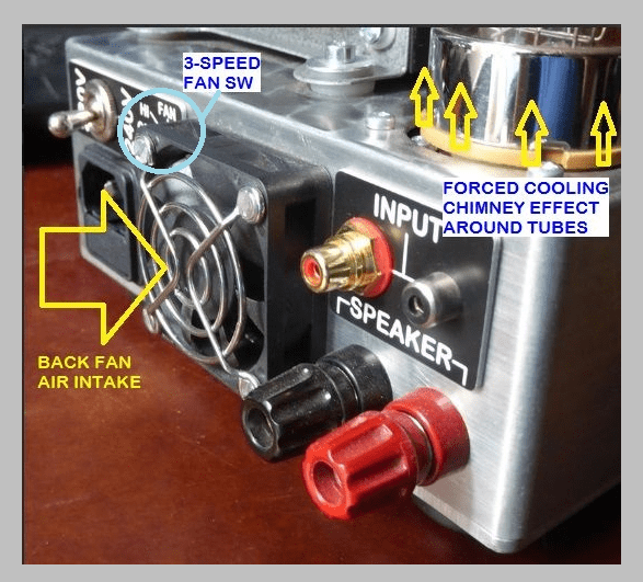

To be honest, I am very biased by my 40-year old experience about tubes, where heat is a common point...
![xQBDMb-P1130322.jpg](https://nsm09.casimages.com/img/2021/10/21//xQBDMb-P1130322.jpg)
![PvcdOb-temp-6080-19-06-2022-1.jpg](https://nsm09.casimages.com/img/2022/06/19//PvcdOb-temp-6080-19-06-2022-1.jpg)
Translation : temperature at the top of a 6080WA tube, stabilized after 5mn of idle operation at 190°C.
On this amp, I also use a some kind of forced chimney cooling :

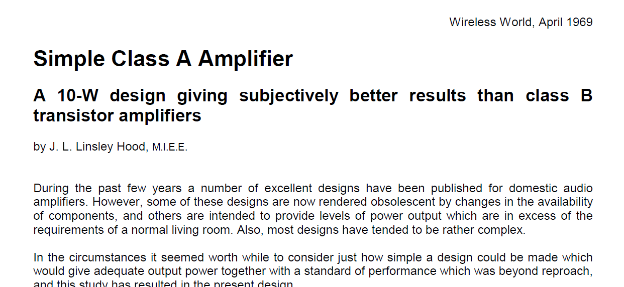

You seem to be a technical and meticulous person, I recommend that you read the original article by Mr hood, the article of 69.
I've probably said it many times but it's all in this article.![]()
You mean this one @huggygood ?
T
- JLH 10 Watt class A amplifier
