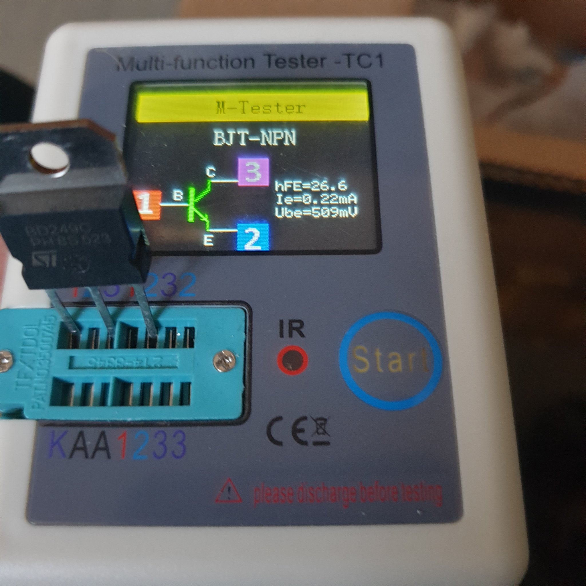

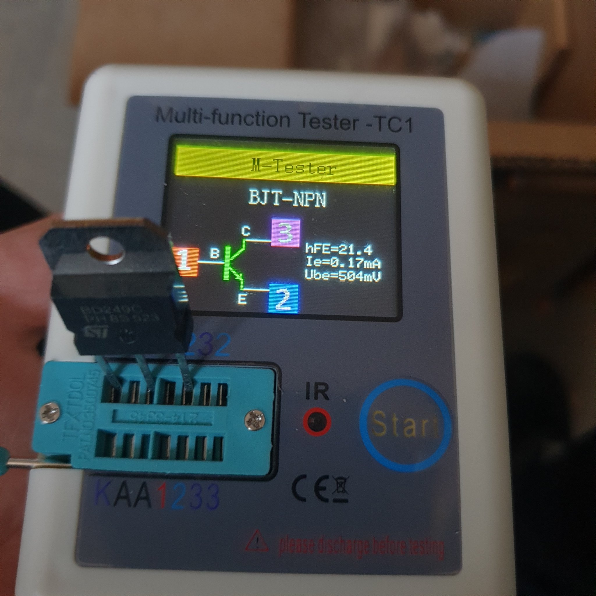

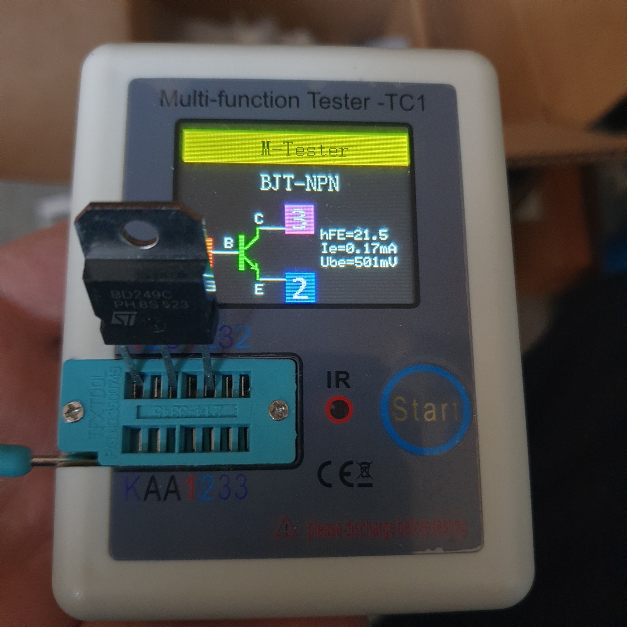

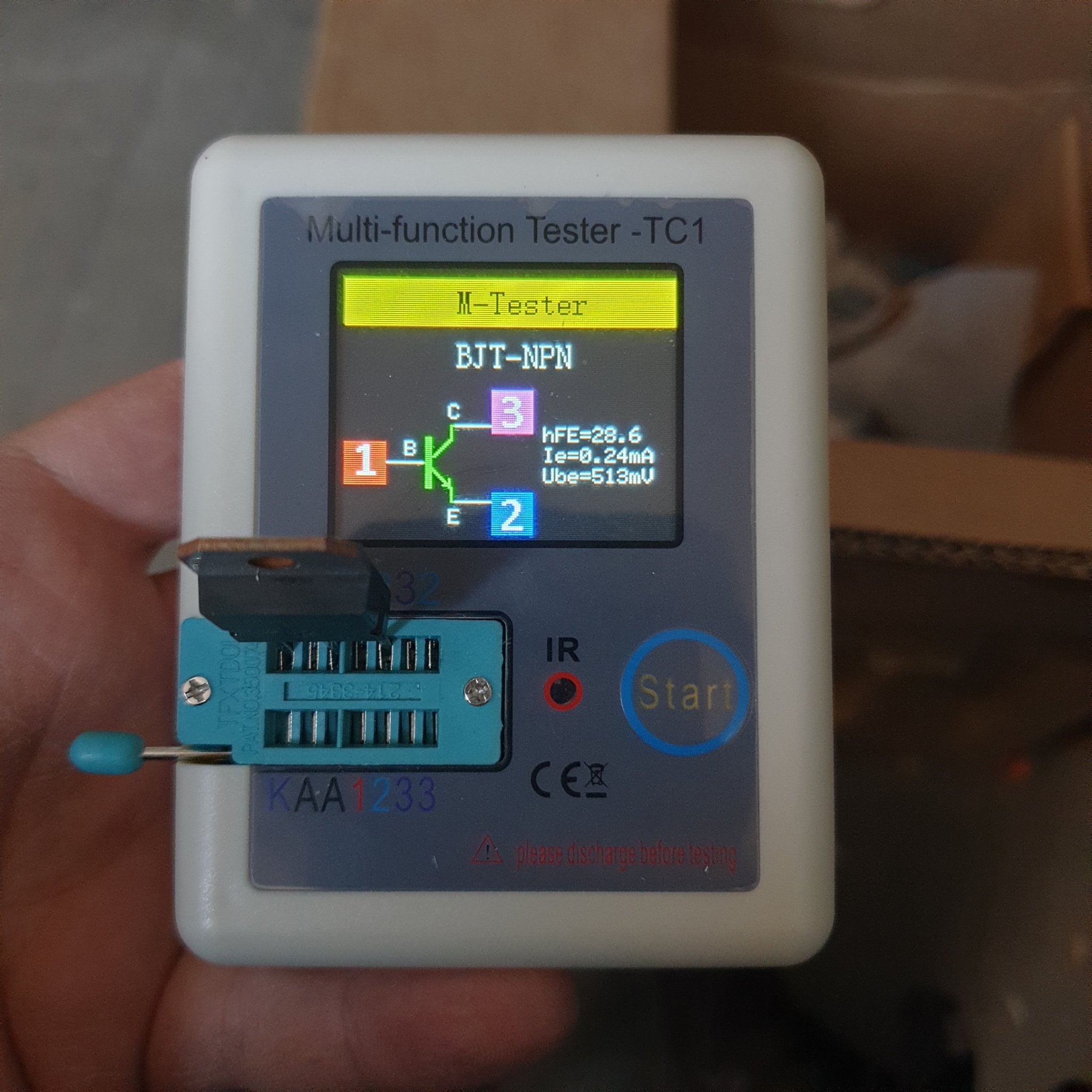

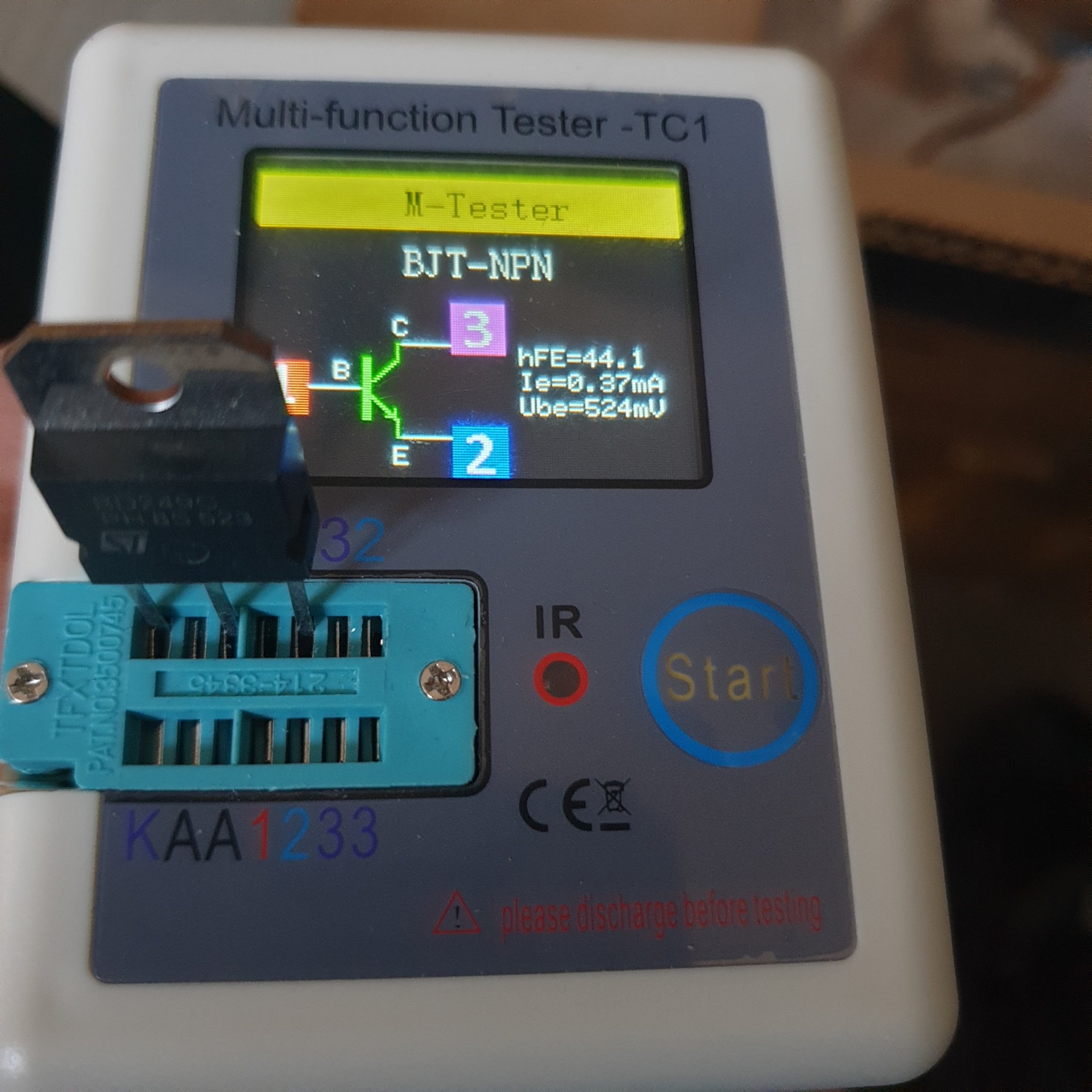

Hi. I found these bjts. But not sure they are genuine. Should output transistors be hfe matched? Please check pictures

Veysel -
hard to tell. Can't quite make out the device type number. Seems to say BD240C is that right?
BD240 is PNP, but it might be a BD243?
Anyway the tester is testing them at low current, which is not much use for a power stage.
What are you planning to do with them? Output power level?
(Not good for driver, fT too low).
