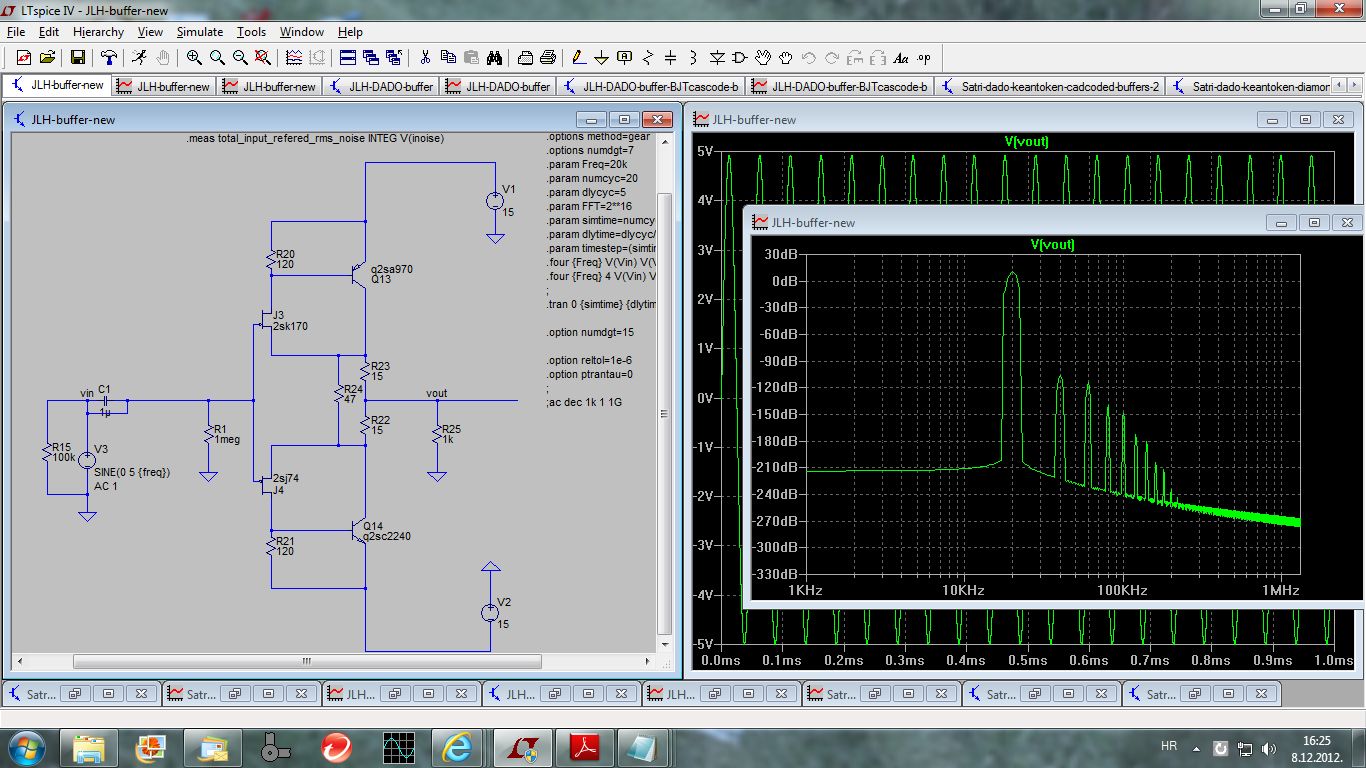

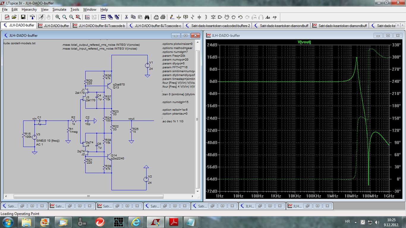

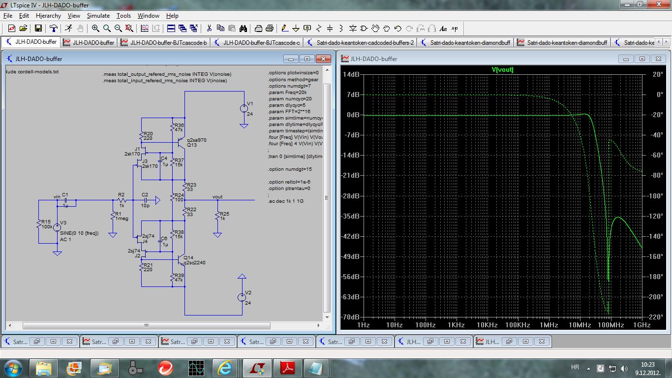

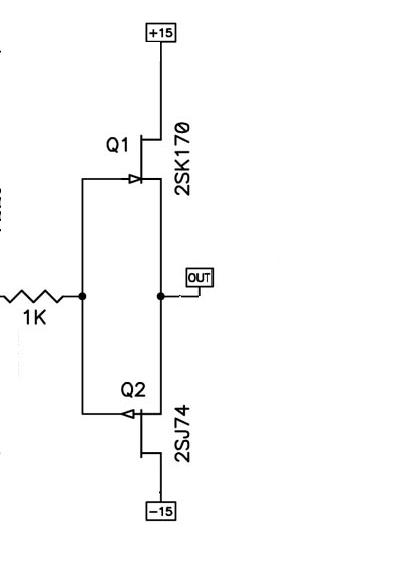

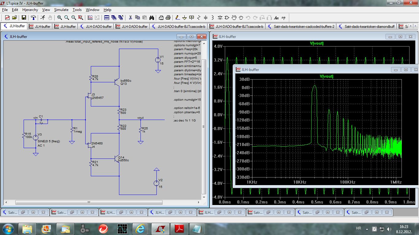

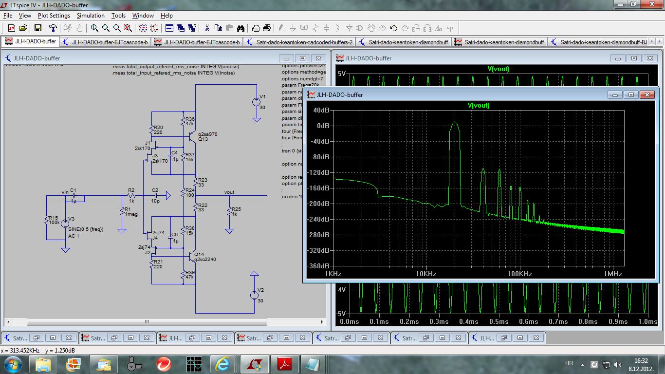

I`ve simulated the circuit with Cordell models and it does have very nice harmonic profile, but CFP driver goes out of class A when output stage goes out of class a ( for 4 Ohm load at higher output voltages), if you want the driver to stay in class A all the time you must disconnect it from the output node as in my schematic:
I simulated what you suggested, and with CCS as Valery suggested and in both cases distortion doubled. This buffer as it is stays in Class A at full power on 8 ohm and goes in class AB on 4 ohm load with not to much of distortion increase. It could be possible to force the drivers to stay in Class A on 4 ohm load with bias increase, but then BD139/140 are not powerful enough. I think that the buffer is good enough as it is.
Damir
Try to simulate this variant for distortion ;)
It does not help(normally that capacitor lowers crossover distortion and is of no use in Class A, but strangely it did not help here when working in Class AB for full power on 4 ohm load) distortion was even higher then without capacitor on 4 ohm load.
Borko thanks for help, if you like to play with it I can load .asc file, maybe you can make it better?
Damir

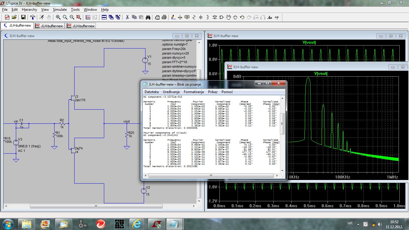

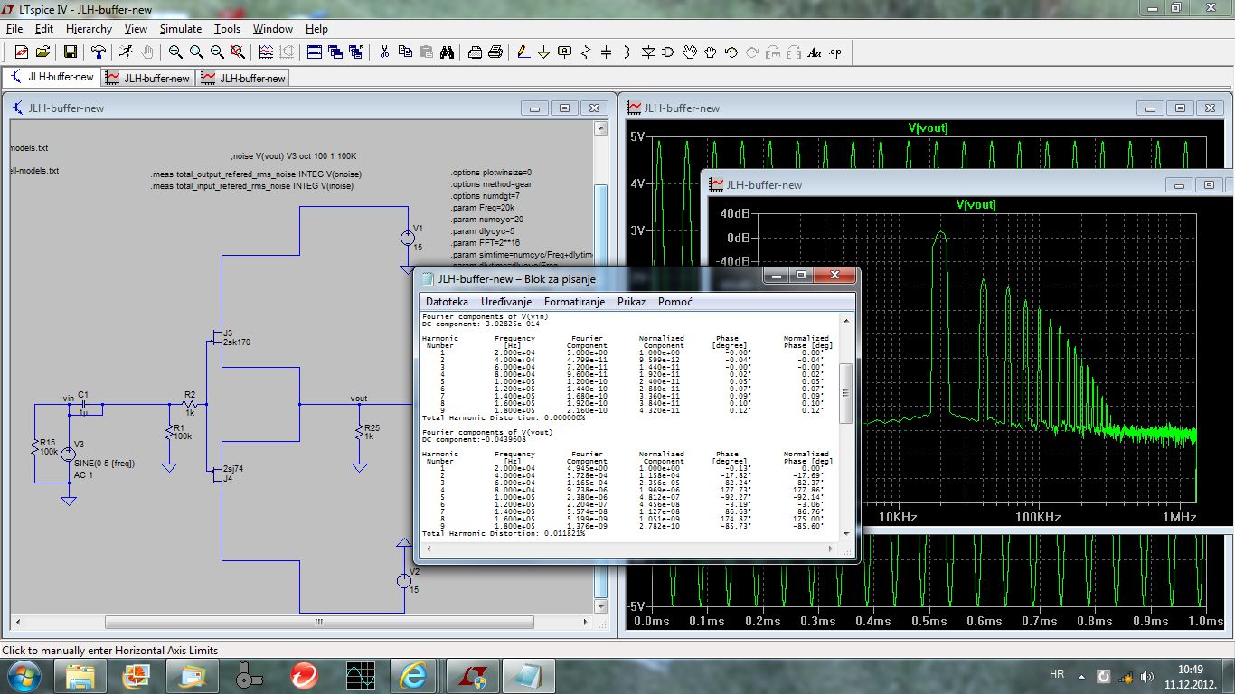

Yes it doubles second harmonic from 0.0005 to 0.001% at 1W, and harmonic structure stays as it is. I don`t think that`s the problem.
With the schematic distortion is reduced and the driver stays in class A all the time, give it a try.
Anyway, listening tests could say much more !
