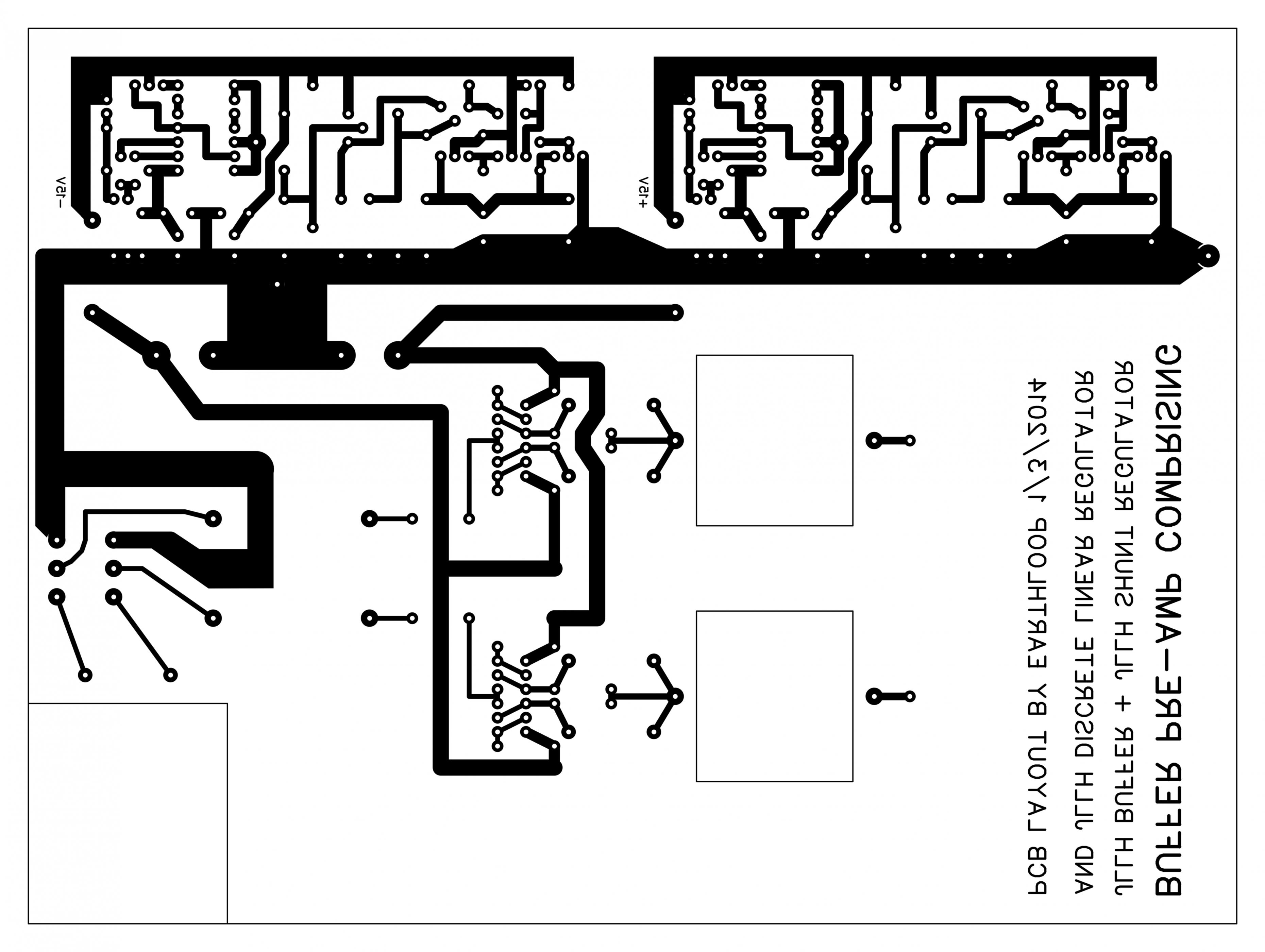

PCB Layout
Here is PCB layout as png file created in "Free PCB" program. You could, perhaps, figure out component positions from my earlier posts. Don't have a diagram because it took me so long to figure out the layout that I sort of had the component positions embedded into my brain! Sorry for taking so long to reply!
Hi Earthloop, like your PCB layout, would you be prepared to share it?
Many thanks,
James
