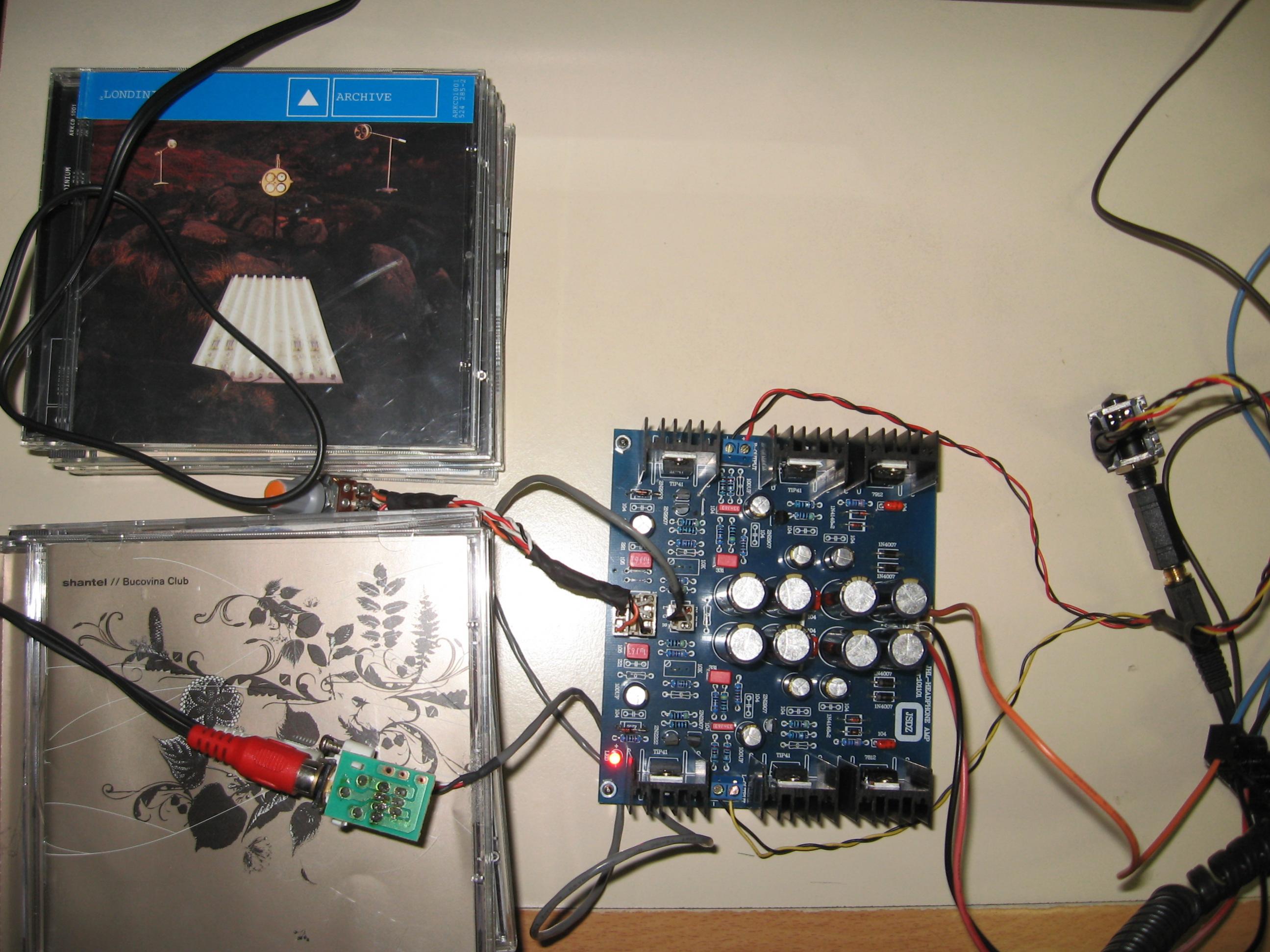

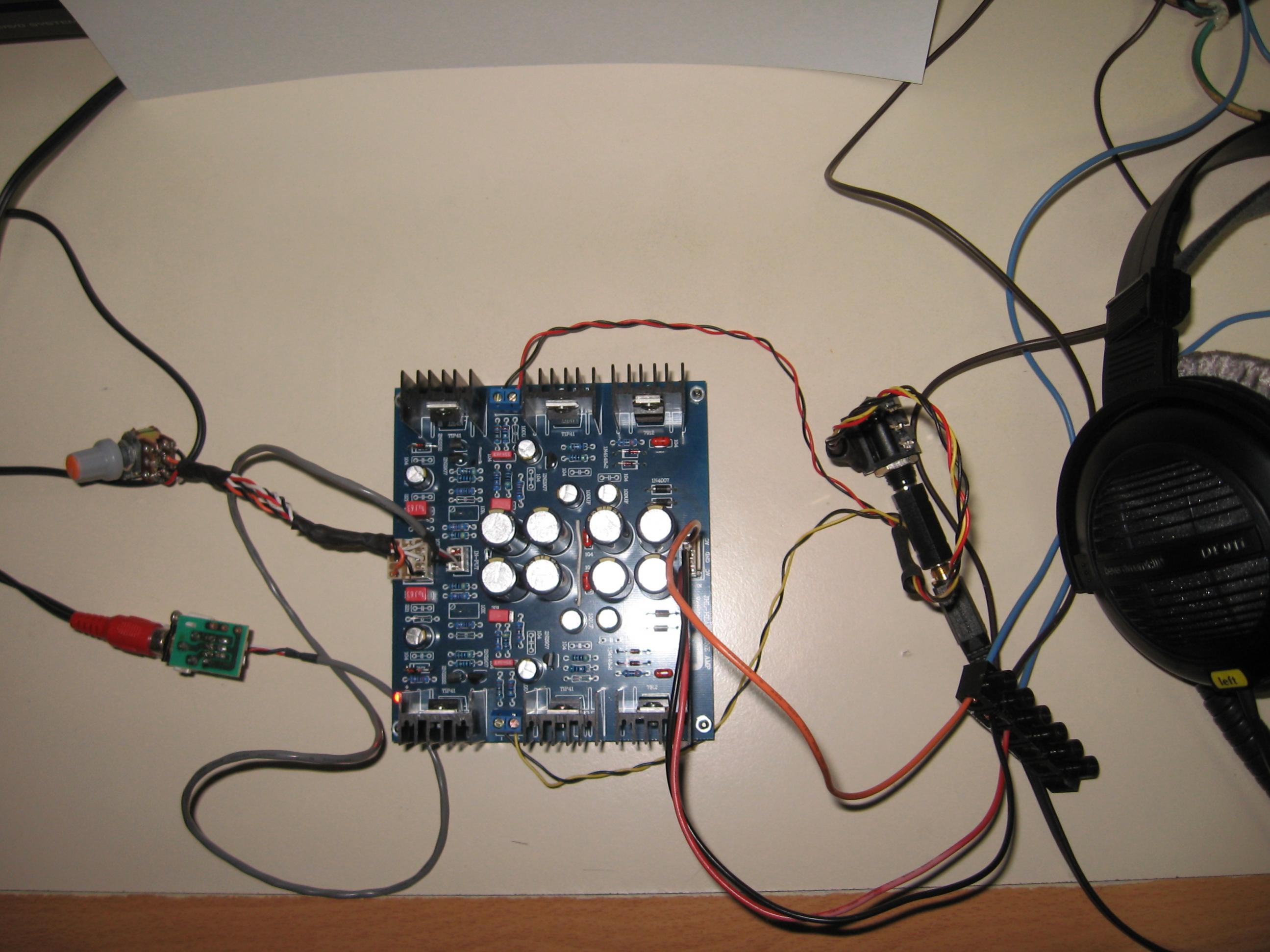

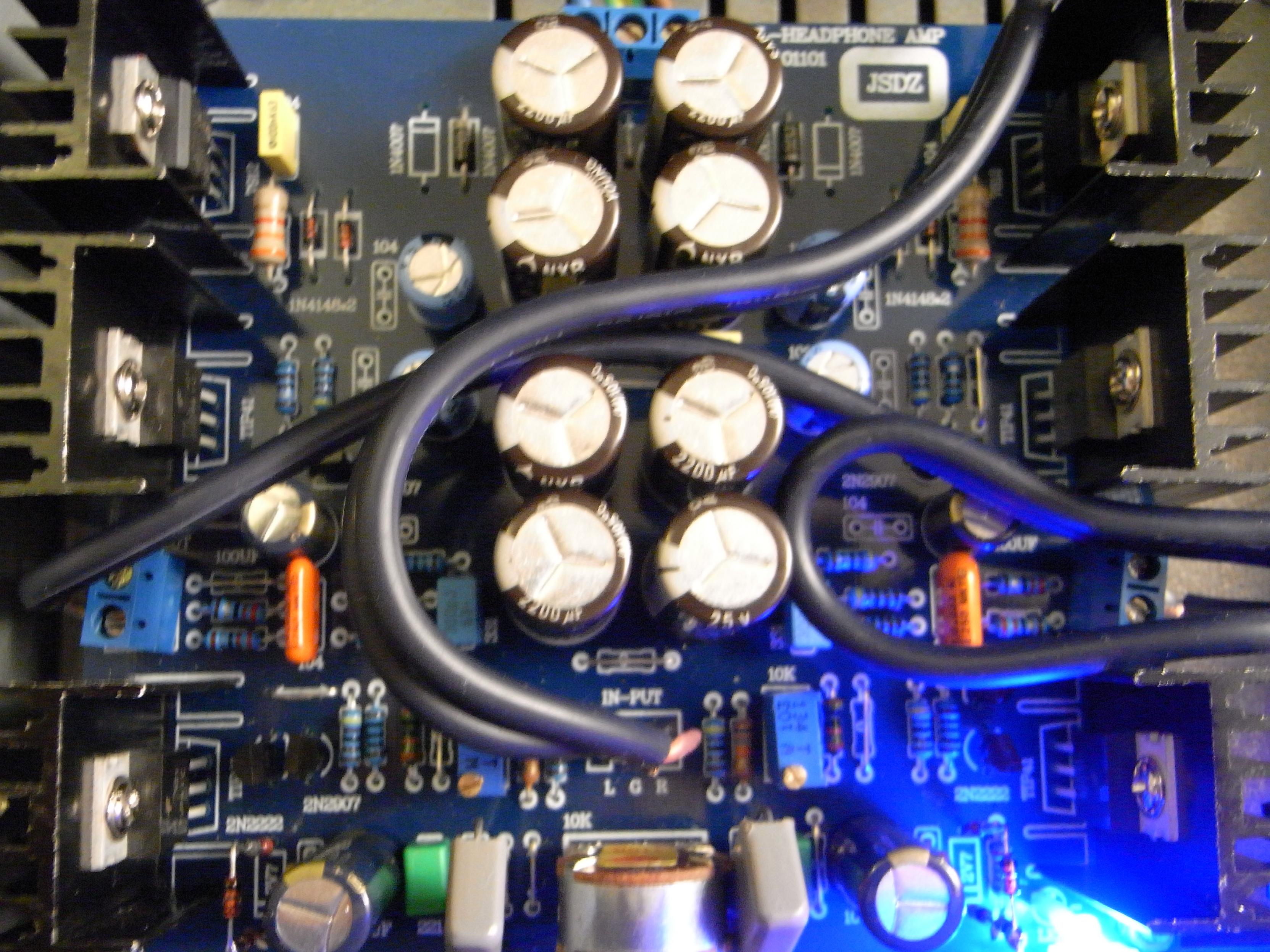

My first post in this forum.
Hello to all.
Ordert the kit weeks ago.
Build with changes testet by MilesCampbell.
Great thanks to him.
All el-capacitors Panasonic FC other wima MKT.
Input 1UF wima MKT bypassed with 0,022UF on the solderside.
The pot will be changed to an alps.
Now i'am looking for a nice case.
Sounds great from the beginning.
Tested first with cheap earphone.
Later with DT911 250 Ohm.
This is my first diskret headamp after
some cmoy.
Now some pic.
More will follow if the amp is boxed.
Thank you all for your very helpful comments.
So I:
Bypassed the rectifier diodes with 47nF
replaced power supply caps after regs with Nichicon FG
Replaced the zeners with 3 1n4148
changed 220pF to 47pF
Bypassed the input cap with another .47uF to make 1uF
Changed 470R to 2k2
Changed the 100uF caps to cerafines
Removed the 100nF caps Miles recommended
removed the 330pF cap
added 10R dropper resistors
changed 4k7 to carbon film
Some made a bigger difference than others. Now the sound is smoother, crisper, tone is better. (all subjective of course)

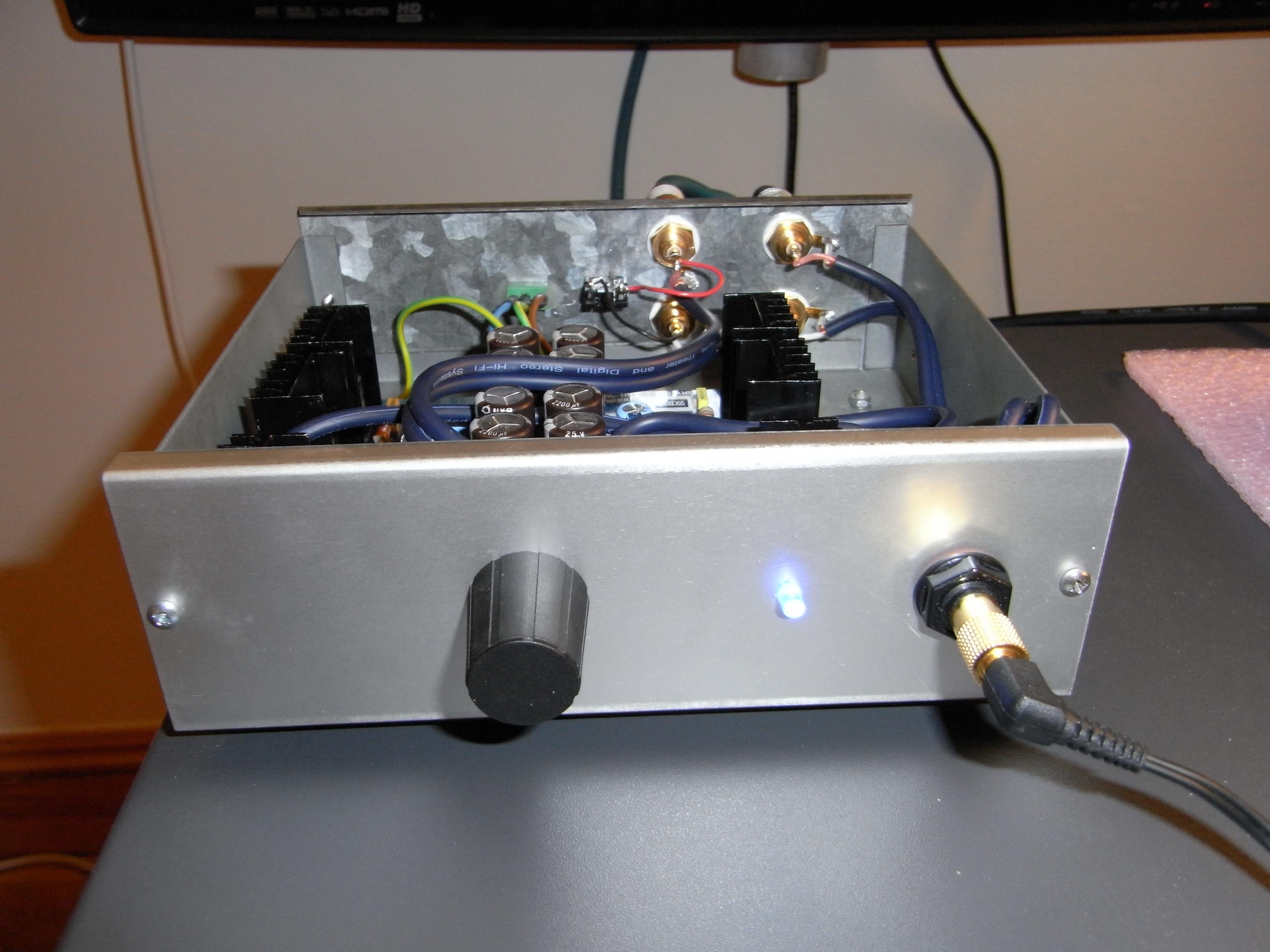

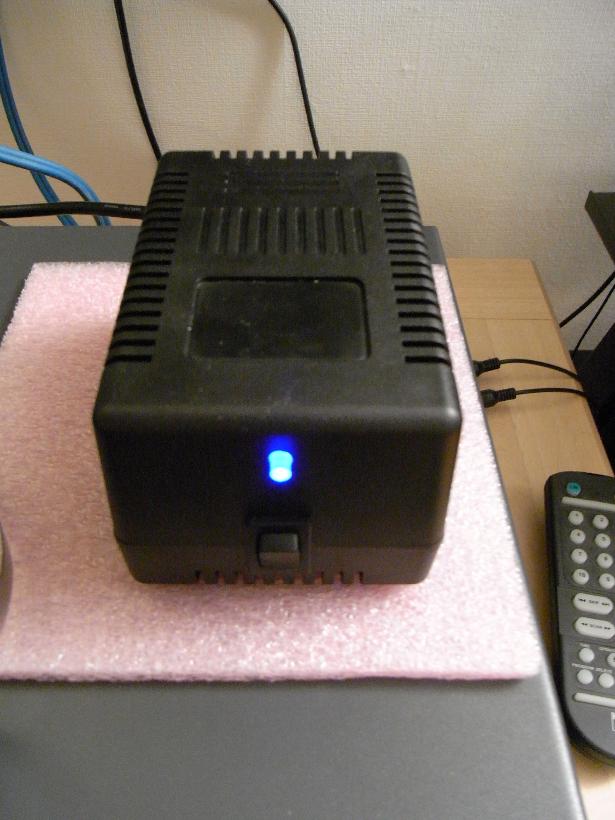

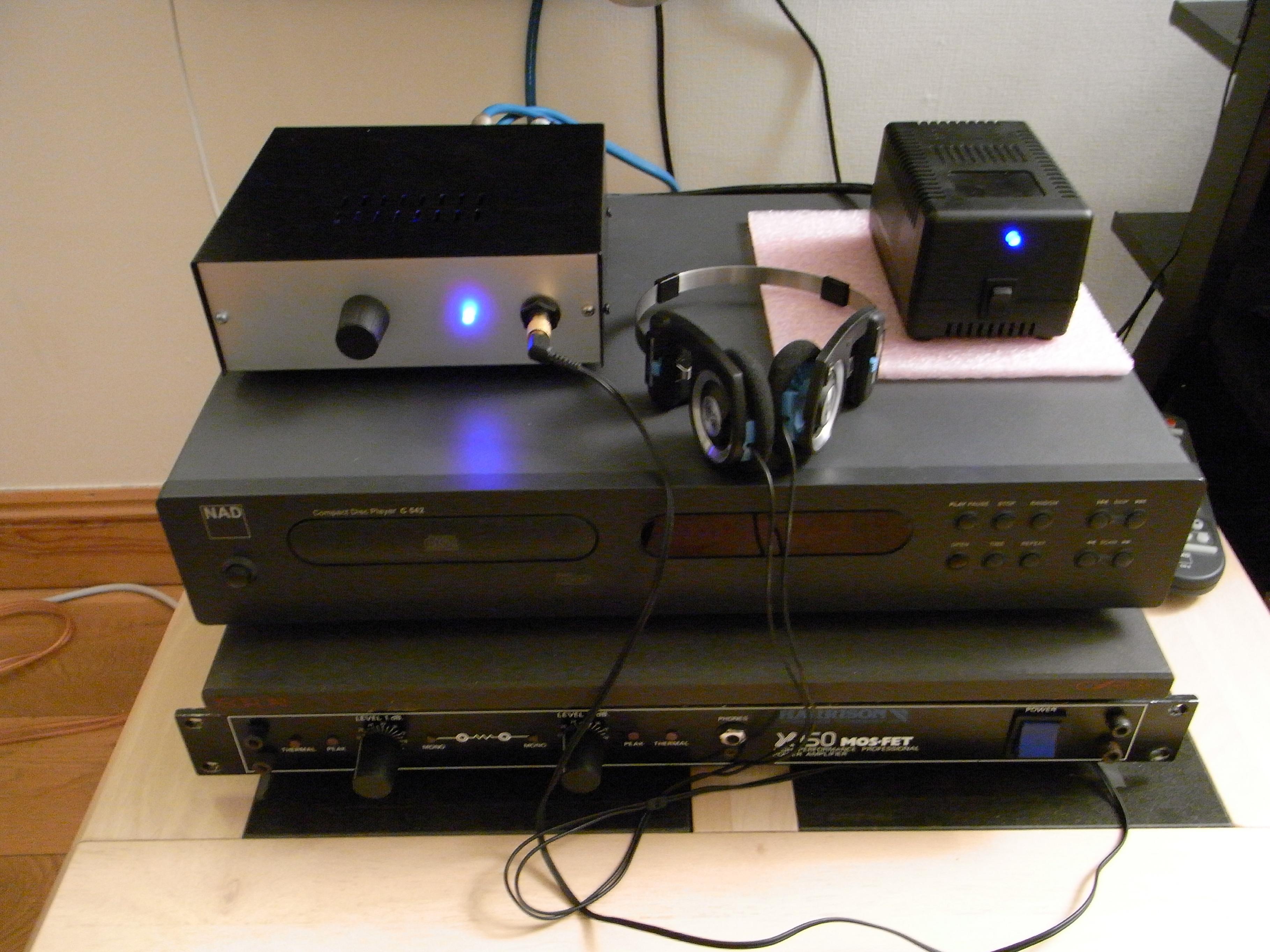

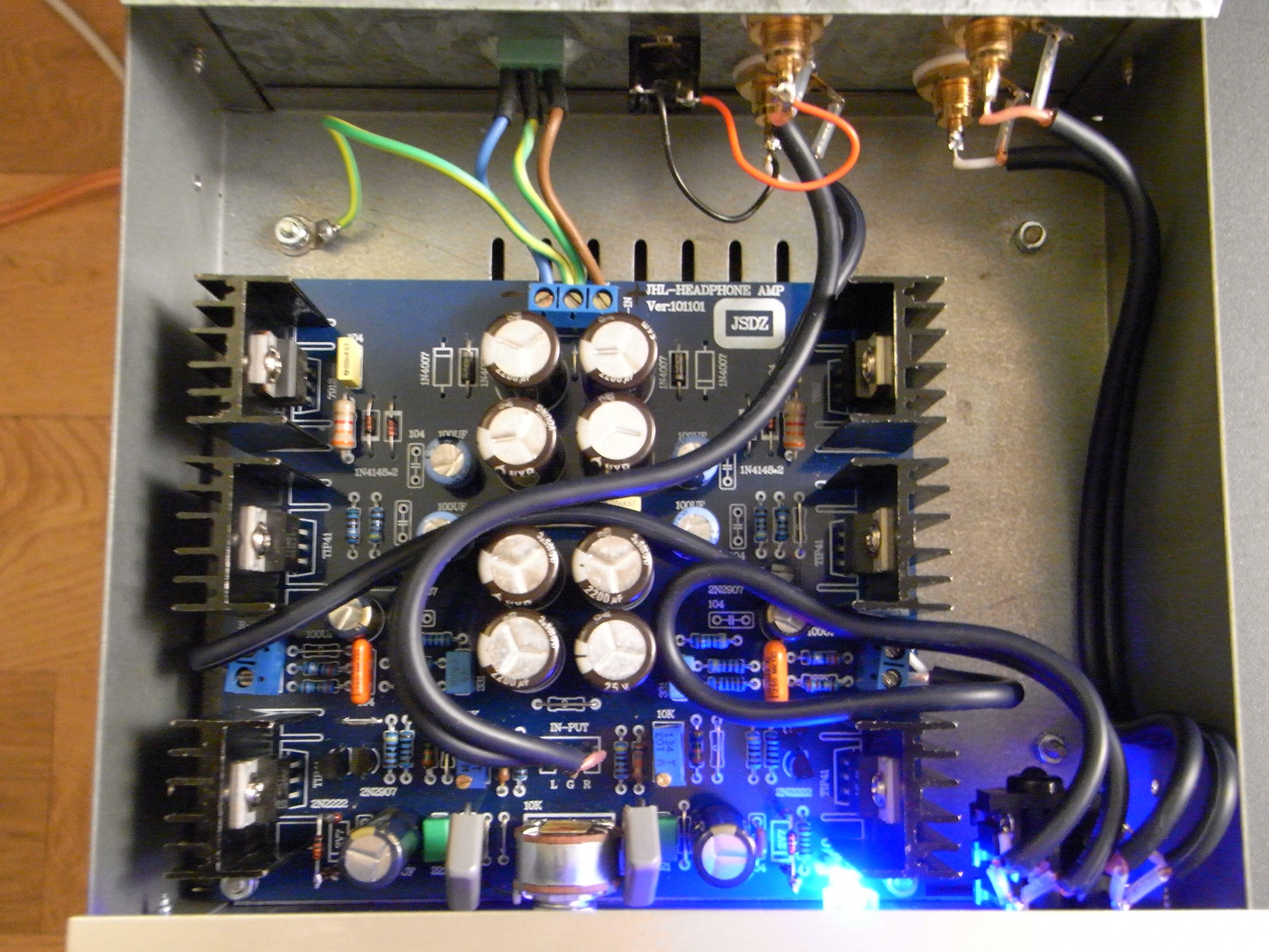

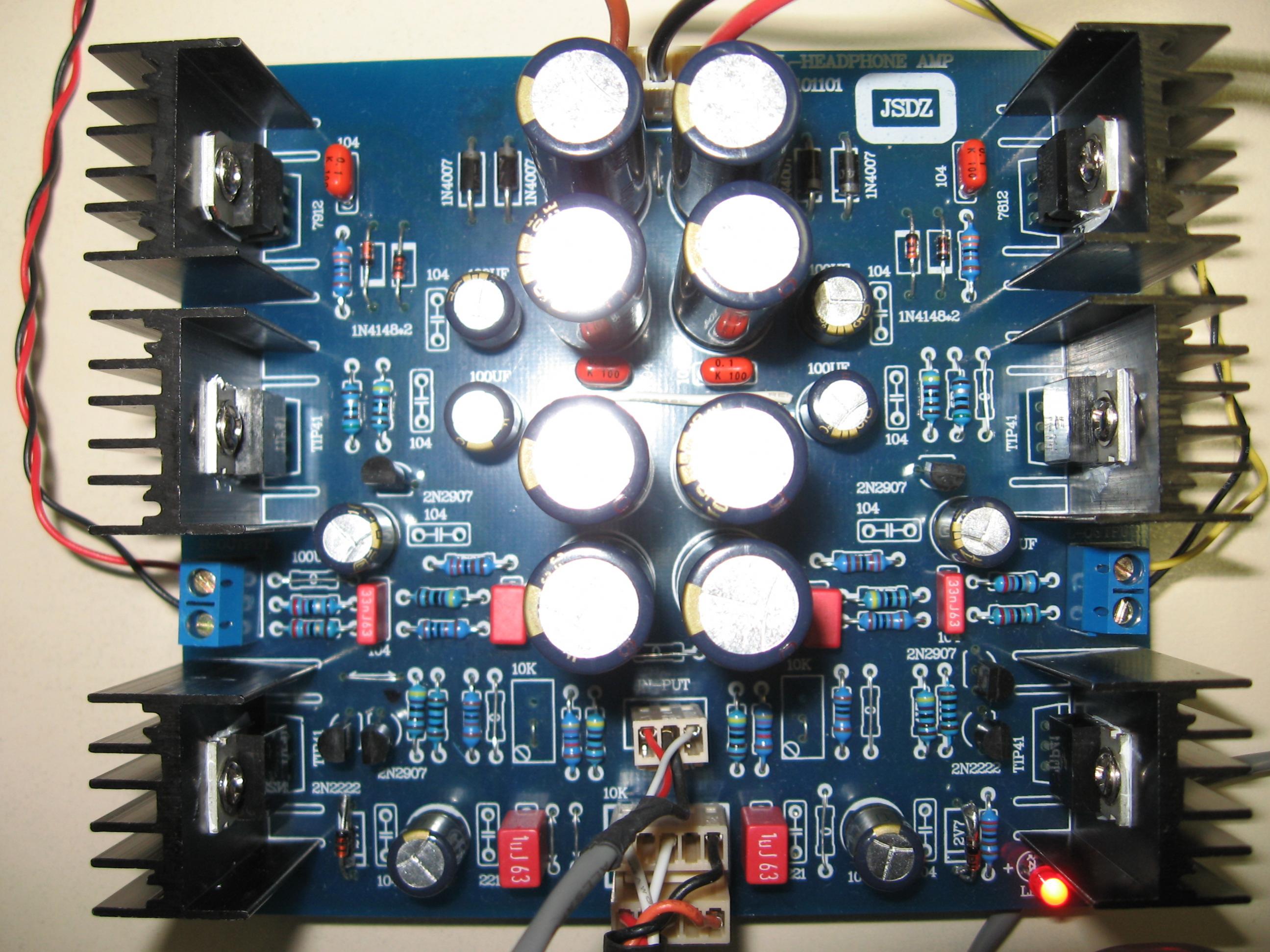

Hi everyone,
Looks like this thread has now pretty much dried up now but i will add to it just to thank milescampbell, hotiron, badgerboy and others for their previous very informative postings. I also bought the Chinese JHL Headphone Amp fully assembled kit around xmas 2012 and have just got round to setting it up. However, i did this before i read this thread and although the amp sounded OK, it was dull and flat sounding. Armed with all the info on this thread, i stripped out all the bad/duff components and turned it into the JLH version that sounds far far better. I dont have any specialist audio test equipment but it sounds pretty good to me, i can listen to it as a headphone amp for my Sansa Clip+ MP3 player and also use it as a pretty decent Class A Pre-amp. I incorporated most of the changes but used replacement components that i had available, as near to the recommended values as possible. I did not change the feedback gain setting because i want to also use the headphone amp as a pre-amp and the existing 20dB gain was fine for that. Besides, the original reason for buying the kit was although the Sansa is a pretty decent multi-format music player, it struggled to drive my 32 Ohm Koss PortaPro headphones to a decent listening level.
I cant really add anything instructive to the original thread but at least i can share my pics of the headphone amp and the seperate PSU. I built the seperate PSU because i like to re-use parts for other audio equipment i might build in future and it seemed strange to take a very high quality, low noise headphone amplifier and stick it in a box with a humming mains transformer. OK, the real reason was the case i bought was too small 😱 Everything bought cheap from Ebay and Maplin (the case was only £13 inc post) Enjoy!
