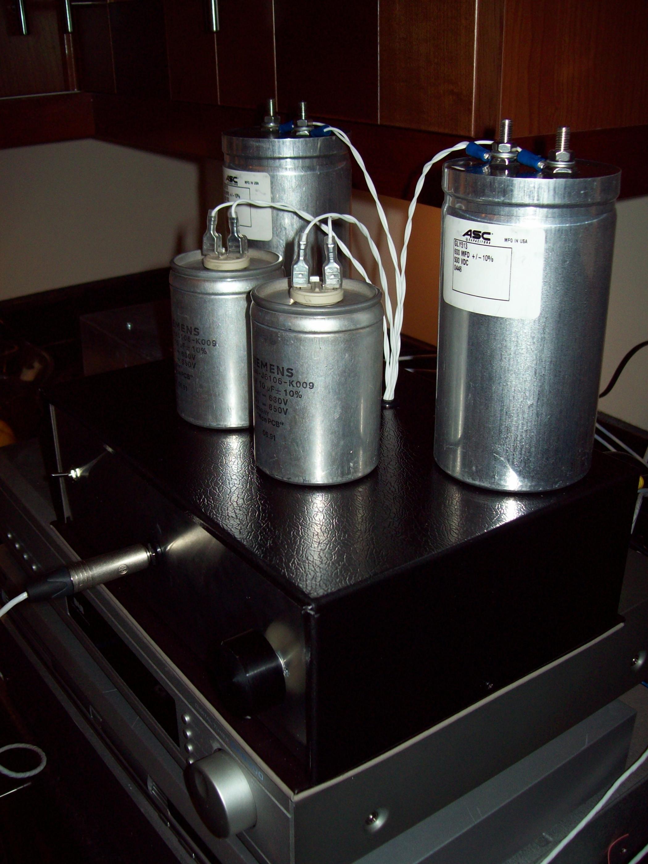

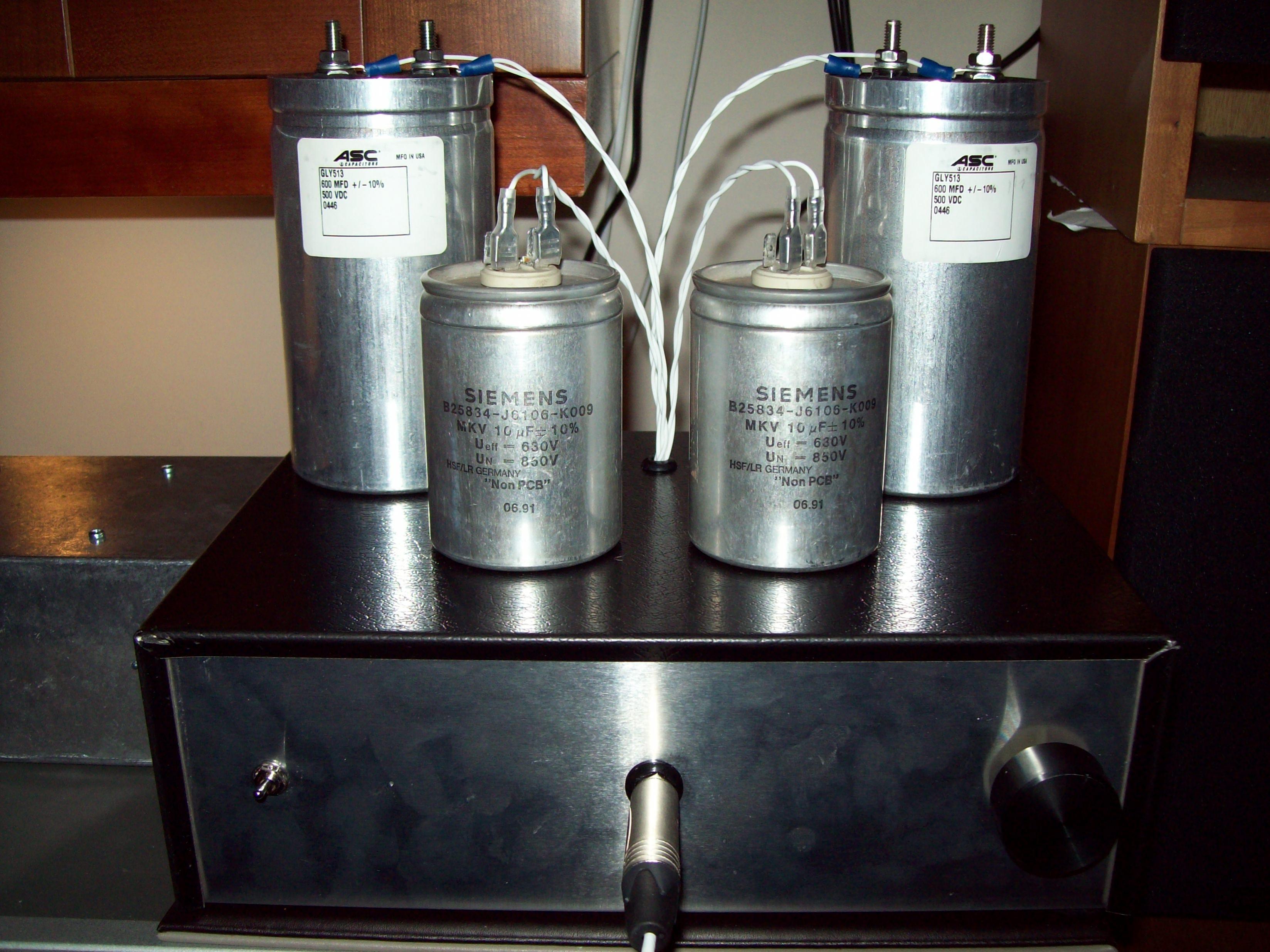

Finished mine - very nice so far, but a bit of 100Hz mains noise to deal with (suspect it's no more than ground routing inside the amp).
Didn't want to take any risks with my headphones, and had some 600uF polypropelene caps so went cap coupled on the output.
DC offset on output varied all over the place when the amp was first turned on. After a couple of rounds of adjustment the two channels are still varying with temperature (but now follow each other to a large extent).
Given that I have output coupling caps, is it best to adjust the DC offset to zero, or would it be advantageous to deliberately choose a few hundred millivolts?
