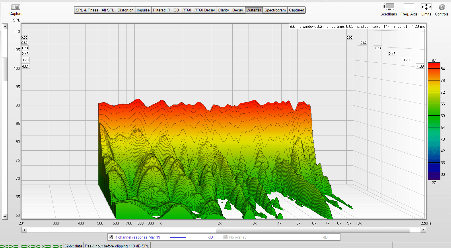

You might want to check out the Burst Decay option in the spectrogram, as it is presented in periods. All of these displays suffer somewhat from the time frequency trade off and are hard to interpret without being able to change the options and see the effect.
Delighted to hear your insights, this is largely new to me, and interpreting the results is difficult for me. For the TD-4001 there is amazingly little information (I mean measurements) I am hoping to remedy that by sharing what I have measured when I am least partially confident I know what I am doing. (Definitely not always the case!!)

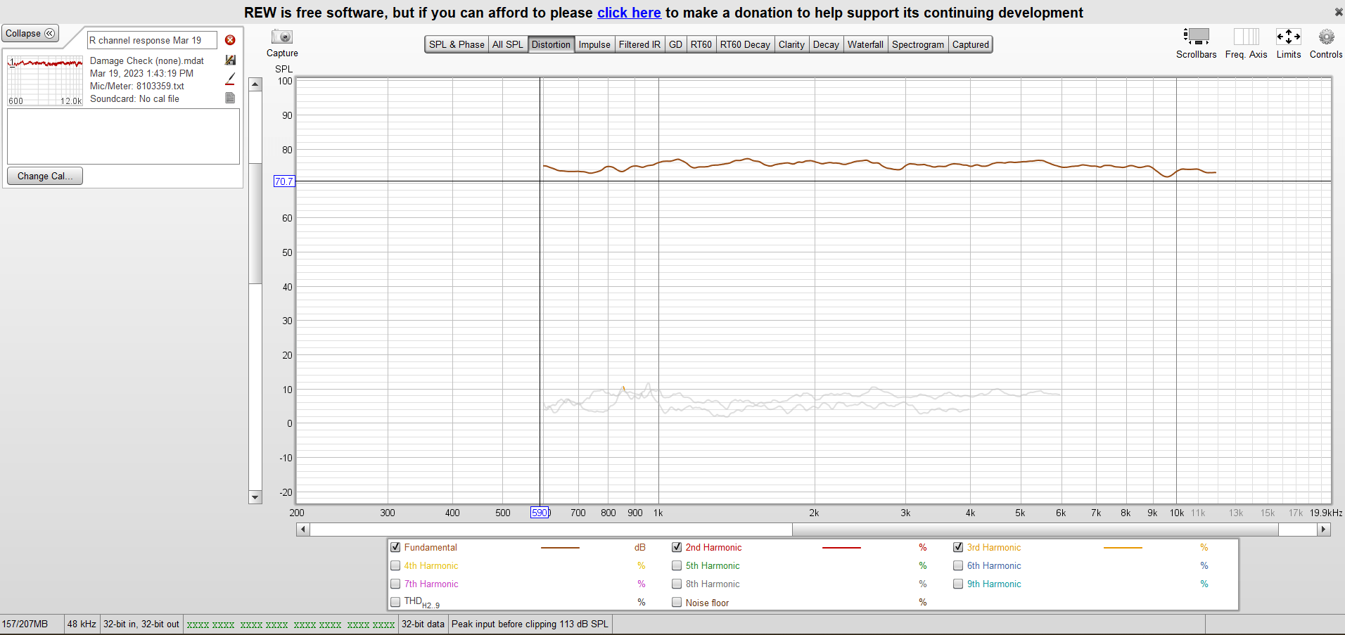

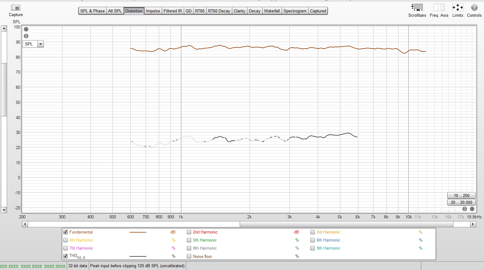

imo a superior method for distortion analysis is stepped sine with RTA in REW. Also use a good quality audio interface, a low distortion amp and a very high quality microphone like M23. Otherwise results are questionable.So some good news.. The diaphragm is not damaged.
Distortion measurement 600Hz - 12kHz
I think you can see one of the reasons why I really like the TD-4001 in the distortion plot below
This is through the system electronics, and I did not disable the XO, which I can do safely in this configuration. So I will try again at some point. This measurement is restricted to 600Hz - 12kHx which is the operating range of the horn and driver.
