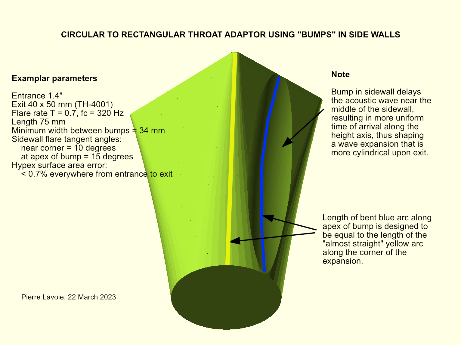

Here is a first concept for a throat adaptor expansion aiming to produce a more "cylindrical" shaped wavefront at its rectangular output, as it seems that this would be beneficial to the TAD TH-4001 and Yuichi A-290 bi-radial horns. It is nice that a 1.4" size driver provides ample length for phase transition. The use of "bumps" as shown is not quite optimal (e.g. small diffraction at the edge of the "bumps"). Still I would expect this expansion to work well, better than my Custom prototype #1, which is already better than the off-the-shelf options I have tried.
There is obvious similarity to some transitioning waveguides that are out there. I wonder if anyone has seen this concept applied in throat adaptors before?

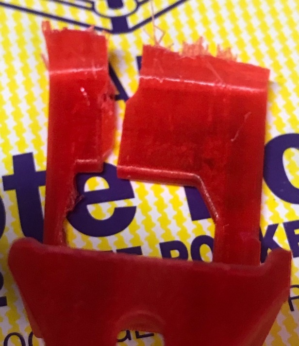

It looks like your layers have simply not bonded properly during the printing process. This is not the material’s fault but a printer adjustment issue.
PETG can be a pain to print (stinky, stringy, sticky and all) but after appropriate adjustment of printer parameters it is very high strength and durable. It is known to be much better than PLA for parts submitted to physical stress.
A local mechanical engineering firm print these for me. What I know is the temperature is high for layer bonding (which is critical as you showed) and it must print slow. They print half scale versions to validate their adjustments for the specific PETG material used and the adapter shape.
Makes sense, thankstemperature is high for layer bonding (which is critical as you showed) and it must print slow.
did you make simulations to design this?Here is a first concept for a throat adaptor expansion aiming to produce a more "cylindrical" shaped wavefront at its rectangular output, as it seems that this would be beneficial to the TAD TH-4001 and Yuichi A-290 bi-radial horns. It is nice that a 1.4" size driver provides ample length for phase transition. The use of "bumps" as shown is not quite optimal (e.g. small diffraction at the edge of the "bumps"). Still I would expect this expansion to work well, better than my Custom prototype #1, which is already better than the off-the-shelf options I have tried.
Thank you for asking. It depends what you mean by simulation. If you mean something like computational flow dynamics, then the answer is no. (not my field)
The shape is mathematically-computed from a model derived from simple logic. For instance the drawing explains the key principle for spherical to cylindrical transformation. Once the throat expansion has been generated by my software, it calculates the surface area every few mm from entrance to exit, and compares these areas to the target hypex areas. I look at the errors and decide if I want to make changes to the model.
As an example, Prototype #2 that is currently printing does not have a flat roof. The height profile from entry to exit is elliptic, starts at 4 degrees (same as the driver exit half angle) and finishes at 0 degrees (same as entrance of the wood horn). This smooth transition also happens to increase a bit the volume in the middle of the adapter which yields a better fit to the series of objective hypex areas.
In the end, I trust measurements and listening results, and since this is DIY, an iterative improvement process (improve, build, measure, repeat) keeps me happy
