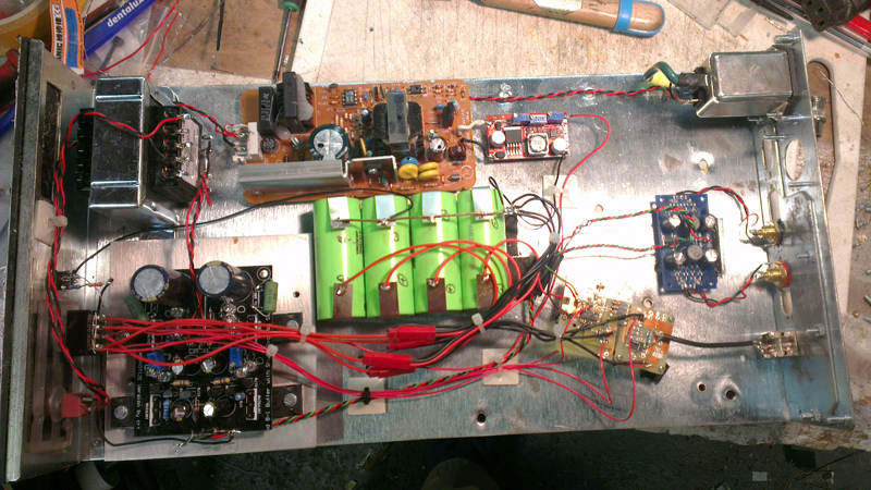

I thought I'd throw up a pic of my almost finished build. I'm using EUVLs 9022 dac (run on batteries) and the filter run from the salas shunt (the old hypnotise B1 boards butchered a bit). The other bits are for charging the batteries.
I had a bad mistake. When I reassembled everything I had no sound and DC offset from the DAC. I fried the 9022 - easier to do than you think with the batteries. After some advice and instructions from EUVL (thanks again!) I managed to remove the dead 9022 and replace it.
All is good, and I can tell you it sounds great with a shigaclone transport.
