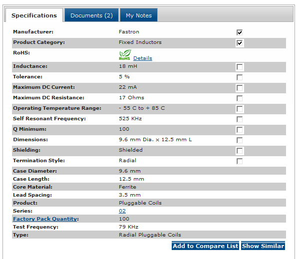

18mH coil DCR seems higher on this but it shows stock and would be priced well, CAN it be used in this circuit?
AIUR-04-183J-ND Digikey
AIUR-04-183J Abracon Corporation | AIUR-04-183J-ND | DigiKey
60 ohm max DCR is WAY higher than the stock on in this design
It is inferior to the Fastron P09 as proposed here, which in turn is also inferior to the 07MFG we specified :

SRF
So SRF is pretty important. The below would also then be ? too far below spec? I could change out the coils in Summer. BUT if they will cause distortion... maybe I just wait. I can try a few...they would ship in just days, but I'm not ready with a board.

RL181S-183J-RC
Inductance: 18 mH Tolerance: 5 % Maximum DC Current: 21 mA Maximum DC Resistance: 17 Ohms Operating Temperature Range: - 55 C to + 105 C Self Resonant Frequency: 0.19 MHz Q Minimum: 100
Here a screenshot of the data summary of the 07MFG 18mH as listed by Mouser.
The SRF is at 525kHZ, almost double that of the others.
Patrick

The buffer is near unity gain. High self resonance of the coil helps to make the filter work
( drop aliasing products ) up to very high high frequencies where is not much energy any more. A low self resonance of the coil will change the slope of the filter. The coil looses inductance there, first there is a minumum ( actually an inductance maximum ) and then the coil gets capacitive so there is a rise in frequency. It simply does not work like a theoretically perfect coil any more over the resonance frequency.
First i had objections to use a ferrite coil but i testet the sound of the Faston compared to a very expensive Sowter coil and got a very satifying result. It sure does not sound hard or distorted. Quite the contrary, smooth and liquid and that was what i wanted.
I found the "untreated" ESS DAC a bit on the brittle side and that effect disapeared with my filter-buffer.
