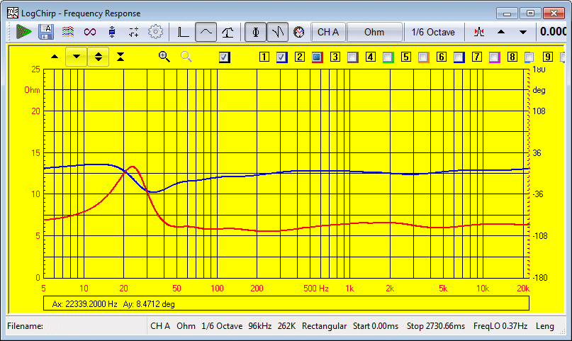

I use SoundEasy, measure the Z plot and import, then play around with the values that gets the best result. You ideally should end up with a single peak way below Fb. There will be other software equally capable. The only way to demonstrate completely would be a video.
Example Elsinore Mk6:
There are no commercial speakers that gets anywhere close to this kind of result.![]()
Indeed, hard to find something commercial which challenges this graph.
This is total (i.e. system) current phase superposition, right? To complete the graph would be necessary to show individual contributions too, e.g. the current phase for each driver. In my opinion, would this be indeed a statement of ultimate system clarity. Or am I wrong?

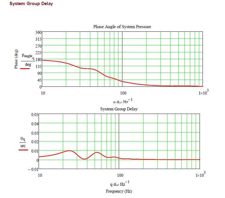

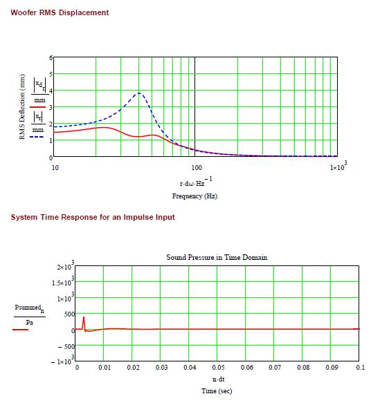

So below is my take on on it.
Bear in mind that this is just a preliminary design can benefit from optimization.
The enclosure details are as follows:
Type: Sealed box enclosure
Length: 400cm
Driver offset from the top: 24cm
Cross sectional area: 3xSd = 264 cm2
The above can be packaged into an enclosure 20cm wide by 40 cm deep and 110cm high, including two internal folds.
The dashed blue traces show the driver's infinite baffle response and behavior while the red traces show the the whole system's behavior.

Just a couple of comments about the graphs above:
-3db point is 42hz
-10db point is 24hz
What's also interesting is the fact that the driver's excursion is well controlled by the enclosure.
Let me know if there is any additional data one might want to look at...

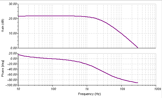

Hi Joe,
I have made only few steps ahead. I tested your circuit in both LTSpice and TinaTi (here using exactly the LM3875 model). I am not 100% through, but till now I can confirm tons of details in this thread, including good operation point, the transconductance mode and linearity (though dependent of R_sense and input voltage, some risk of Xoverdist, other risks if not properly done), etc.
However, I have for you a couple of remarks and questions on some points that I do not understand yet. All are, maybe, not so important for functionality but they are essential for my understanding. If you have time to look again through some posts here would be very kind.
About DC-trim pot:
Indeed simulations do not show any DC-Trim effect, but you experienced a sensitive behavior. What could be the explanation?
About bandpass filter on the input:
Indeed the values of shown schematic produce a strong BP filter, strongly rolling off above 1KHz, phase attention too! What is the purpose for this BP? Why not using a 10uF/4.7ohm set for series RC and obtain a bit of roll-off at 20-30KHz? Moreover, why this BP-filtering matter would be Chip amp dependent, I do not really understand.

Hi Joe,
thanks for useful details and thoughts.
DC-zero: meanwhile I observed that the TinaTi model of LM3875 needs best a 1K series with 500 trimpot. The 10K trimpot was way too-sensitive (for simulation parameters).
Low inductance(!?) wow... to flatten Z at trebles... means deep performance sacrifices and good above-average engineering to not loosing everything. This, yet again, speaks for full range drivers, where lowZ is a must to have compromise on many more counts.
I guess with 1,5uF/4.7Kohm (see attachment) you compensate Z increase at trebles to obtain linear power vs. freq. for a given fullrange driver, much like an active pre-Xover? Also, the slewing argument makes sense for full range driver.Keep in mind that the LM3875 is very popular as a 'Gainclone' chip - about 12 years ago I pointed out that putting a BP on the input had a marked affect on the sound and that it can only be adjusted by the ear. The LP part is clearly limiting max rise time and hence some kind of slewing is going on. I simply copied over the same values I've used before and they seem to work as before. By all means, try different values, but really this should be done by ear only.

Now back on topic. Many have eyed the relatively inexpensive Usher S520 speakers:
I have developed a new Crossover for this little speaker that means to can be driven by a transconductance/current amplifier, and I am thinking about posting it as DIY project. I am very pleased by the result so far. It's only a change in Crossover plus a small addition of acoustic damping materiel added internally. The old Crossover is removed and the drivers are wired straight to the existing terminals on the back (four) and the new Crossover is external and four wires connects it.
The impedance plot and current phase angle plots below.
My first guess is that the local combined effects of mass-load plus your 2-long-spots choice geometry are more effective in damping resonances. The larger the cone-diameter you put them on, the lower the frequency modes affected. A good theoretical example is given in Fostex NF1 Application Note. I thought you found your inspiration there, since you modify so many Fostex-s. According to them the Trebles MUST be confined only around the dust-cap (or Phase Plug). The MIDs should not extend to the sicken. etc. To me it seems correct. Though a FEM simulation would prove it better, I agree on this too.No one knows yet why it works...
