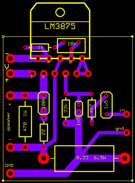

Hi, Joe
Nice to see you are working with the concept.
I just wanted to bring to your attention some notes on your schematics that may also have to do with the bass issues mentioned in the link above.
The usual supply bypass capacitors for the IC have been omitted. Is this deliberate? I also find the reservoir capacitors fairly small for this power level; as the offset cancellation current is also taken directly from the supply, this can cause some distortion (as you have measured).
As I see it, the output impedance at 20 kHz should be about 80 ohm due to the 0.1uF capacitor.
In the Elsinore, the lower impedance peak seems to be uncompensated (post #143) which is understandable as it requires large component values. This may, however, lead to large excursions on current feed if the signal has still some content at 20 Hz.

Hi Esa
A few things, I made this amplifier mainly to prove a point. It was really more about the Elsinore speakers than the amp. I needed to physically prove that the concept not only worked on paper, but by making this amp I was able to prove and demonstrate it works in the real world.
The lack of by-pass caps? The compactness of the circuit does not really come across in the diagram, the reservoir caps are very close to the power supply pins and low ESR.
Yes I can see you thinking that, but as I remember it, and I would need to redo it again to confirm, it didn't measure that way when you calculated the difference in current versus voltage. I aimed for 100mVAC in for 250mA output and when you track the error it comes out like that. As I said, I really need to revisit it, but it would be an academic exercise more than anything else.
Not in practice.
In reality the peak (lower F) is much higher than the sub-20 Hertz shown. The LCR has a Q that can be varied and can be surprisingly accurately modeled (would need to do a workshop and demonstrate it rather than as a topic here), and carefully varying the LCR, the lower F peak is suppressed both in frequency and amplitude. In other words, the upper F EQ/Q affects and suppresses the lower F, but without actually eliminating it.
The real question is, how does it work in practice? Actually amazingly well. This quick bit of modeling shows why:
Note the vertical scale here is 10dB and we are looking at the 'effect' and it is down about -20dB, and note there is barely a hint of it lipping upwards, rather it looks more like a small plateau.
Trust me, there are no excessive excursions from the drivers, and this speaker is remarkably easy to drive (I would say more so than any commercial multi-way loudspeaker). It will go very loud indeed and sounds totally in control and not the slightest signs of discomfort. (Anybody near here is happy to come around for a demo.)
I also did a smaller speaker that was 4 Ohm and less sensitive, here the lower F was 21 Hertz and 19 Ohm (around -15 to 17dB down). Again a plateau formed from around 30 Hertz and a tiny lip at 21 Hertz before dropping off quickly. This time, playing loud, the only problem is that the amp was quicker to clip. No erratic excursions.
What is remarkable though is the quality of the bass with both speakers. It just completely shatters the idea of Damping Factor - something that Richard Small dismissed way back 1975 in a conversation I had with him. To him it was nonsense and all that mattered was where the alignment ended up. And here the modeling (based on T-S driven software) is very accurate and revealing - and the results confirm it.

A suggestion of pcb. Surely (very) bad layout, any advice welcomed.
What about the one developed by JPS1964 in the "Layouting for free" thread?
It seemed to look really well thought out. Only thing I would have changed is the position of the LM3875 chip to make it protrude outside the board so it can more easily be attached to a heatsink...
