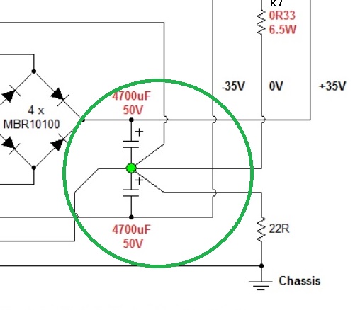

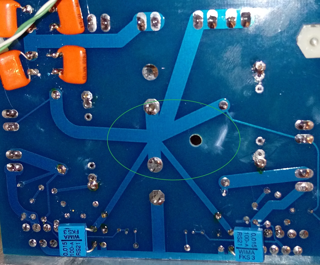

On the other photo (post #311) above, I can't quite see where the ground tracks are running but from the design of the double chip version that Mak sent, the capacitors are where the central, or 'star' ground is located - I would assume your pcb would have a similar ground scheme - so yes, this is your amplifiers central ground point.
So, as Mark mentioned, if we examine Joe's diagram a little more closely, this central ground point is the equivalent of the green 'dot' between the pair of 4700/50v electros, and this corresponds to the points on the pcb between the power caps (the screw terminals on the edge of the pcb is probably close enough)
This means you have to feed these input power terminals on the pcb directly from the block bridge (ie. remove the external power caps veroboard assembly) by 2 rectified ac
Then you connect your secondary centre tap of the transformer (black wire) to the double ground terminal on the pcb, and from this same point, you run the white wire back to the floating components (the 22R) on the ac input socket's chassis/earth pin.
This will bring you back to Joe's diagram on the post#1.
Something else to consider - that red Wima cap looks like a 1.5uF MKP that is your input cap, yes? If so, I suggest you just extend it's stubby terminals and somehow mount it above the pcb and avoid the off board wires - not sure if it'll fix anything but not good practice (you could position it underneath the pcb if clearance enough
Then, move the input phono plug to where you had the Wima capacitor - keeping the wires as short as possible, including the wires to the speakers, especially the ground return wire that goes 'in' with the other 2 ground wires

the green circle on the PCB is corresponding to the ground point (greed dot) on Joe's schematic. if you want to use off board DC power supply then just tab into left side of (D2/D4) for V- and Right side of (D1/D3) for V+ and leave out the AC1/AC2 input. Don't forget the GND as well.

As a fellow up, I follow the advice of Mark , JH and redo the power wiring. This improves the hum to low levels that is audible about 10 cm from the 92 db MA12P. I will try shielded input cables and interconnect later.

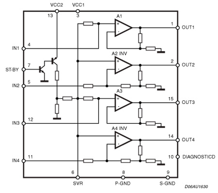

Hi, can this STA540 little chip be converted to work as Trans-amp?
Alas no. Gain is set internally, so not possible as the load has to be inserted in the feedback loop - the voltage gain then changes with load value and that makes it behave as having extreme output impedance of a "current" amplifier. Not possible with your chip choice.
