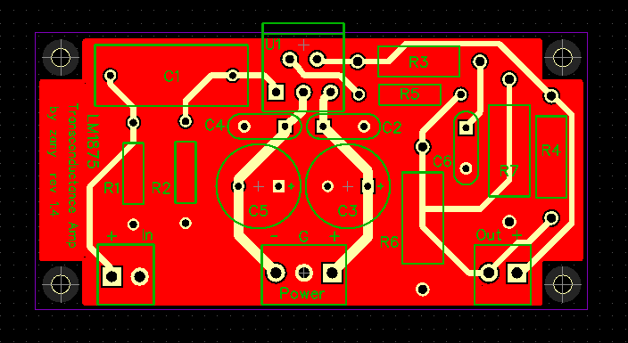

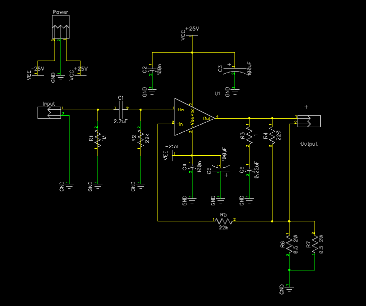

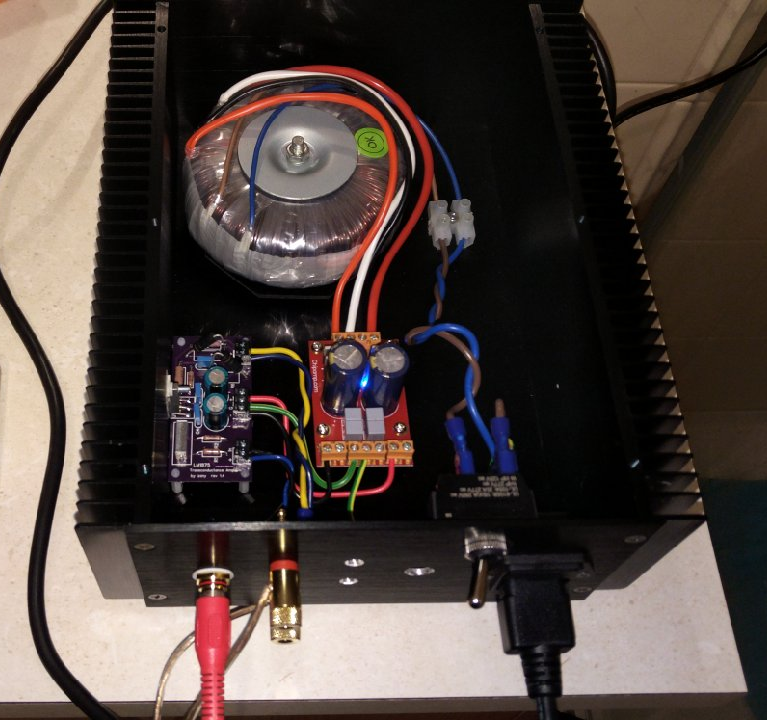

I too have been interested since reading about Nelson Pass' F2. I decided to make a pcb to try the concept before building a class A living room heater.
I too have been interested since reading about Nelson Pass' F2. I decided to make a pcb to try the concept before building a class A living room heater.Below are the schematic and pcb layout. Being a noob at all this electronics theory and pcb routing, there has been a lot of back and forth with design of the pcb to get to a decent layout and routing. This iteration of the board has a ground plane on the bottom side. The dc offset connected to a cheap full range driver is 37 mV. The amp sounds very easy on the ear driving a prototype hybrid active minidsp/passive crossover open baffle speaker + subwoofer system - one channel at this stage. The only thing that I need to correct is the buzz coming from the speaker which I can hear from the listening position during quiet passages (4 meters away). Wondering whether the buzz is coming from the layout of my pcb or from elsewhere? All ideas welcome.
Hi Zany: I built the same schematic for TDA2050 with excellent result. Also had hum elevated. I changed values from R3 to 10R (or 15R) and C6 to 47 nF. I also removed ground from this filter and connected it directly to R6+R7 (by Mr. Rasmussen). Congratulations on the amp, well organized and your audio has a big difference compared to standard amplifiers. I do not understand how the industry and enthusiasts build so few transconductance devices.
Thank you for the kind words augustoriodosul. Your comments regarding transconductance amps are interesting - the open baffle dipole speaker has been up and running for about a month now using an old Rotel 30W integrated amplifier temporarily to tune the active crossover. It took a good amount of work to get it to sound reasonable. This trans amp just sounds so much better - it just sounds right. A big step up in quality. I will test your suggestions. Thanks again.
It's surprising just how good a sound you can get from these little packages if you get it right - I read on the Neurochrome site that connecting the components related to the speaker return and specific pcb layout with regard to ground points can produce quite significant benefits
So, looking at the pcb from this 'point-of-view' I would put the R6 and R7 together either on top of each other or one on the other side of the board (or simply just use one 5W resistor instead) and connect C6 directly to the junction of R5, R6//R7 (as mentioned) and this could be called the new 'ground point 1'.
I would then move the ground connection of both R1 and R2 to this new 'ground point 1' (a wire link, or just use the resistor leads) so these resistors don't have a top layer connection anymore
Then, I'd reverse the bypass caps C2, C4 so they have a common ground point between the electro caps C3 and C5- this keeps all the high currents circulating only around this group of caps and the Chip pins
Now, the overall ground point?
If we are to follow on from Tom Christianson's ideas (see the Neurochrome website), the speaker return would be connected to this new 'ground point 1' (not to the centre pin of the 3 way terminal) and then this point would be linked to the middle pin of the 3 way terminal that's connected to the external power supply 0 volt.
It sounds like a lot of 'nit picking' but separating the ground return currents can be extremely effective for improving performance
... just my 2 cents

would you mind sending picture with detailed connections? This will be helpful for many people.
I'm still trying to work out how to add photos and things on this site but all isn't lost as the guys in the HK Audio Club did a really well-organised pcb design and I'll see where I stored the information and/or a copy of that - that's probably a lot easier than me mumbling around about which goes where
The way I look at it isn't very different to Joe setup diagram except for the speaker connections and how the ground connections are grouped together - it's the pcb layout where you can lose a lot of the performance - IMO, I hasten to add
Also, it's quite reasonable that someone else has found a better way of doing this as following the Neurochrome design ideas for a voltage gain circuit may not work in the same way as Joe's current gain/transconductance arrangement - I think it will, but it's good to keep an open mind about this rather different way of doing things.
