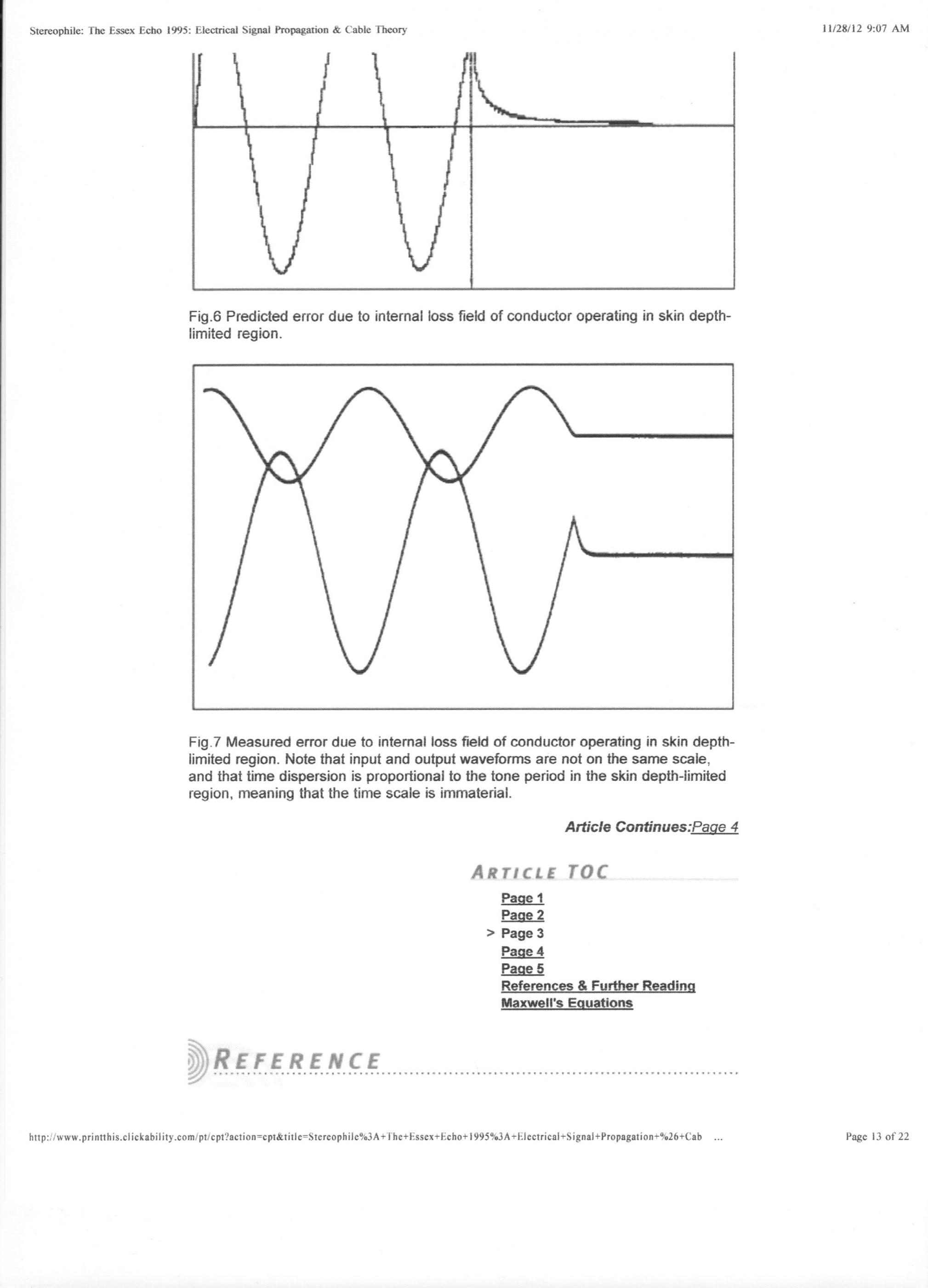

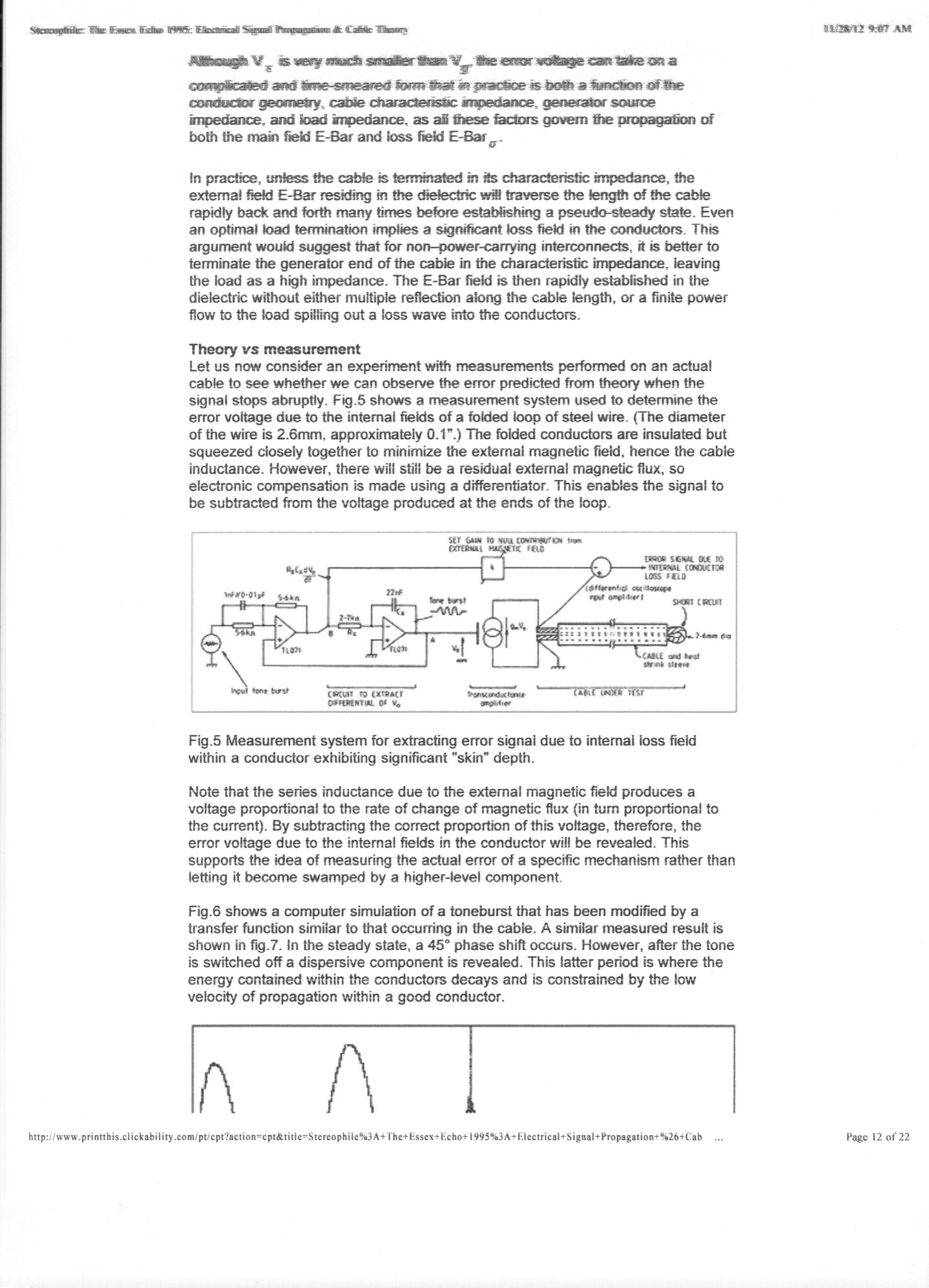

the scope measurement was more than suspicious, without any descriptions of X and Y axis
Were you aware that the test wire was magnetic steel and not copper?
edit: Page 63, first two paragraphs after "theory vs measurements". Note also that there is no mention of the internal inductance of the magnetic wire nor it's mu (JC informed me it was 100), so no consideration of the wire permeability's effect on the per length inductance. That would be 100 times 15 nH per foot, or 1.5 uH per foot. Skinning would reduce that, however without knowing the precise mu nor the precise conductivity, calculation is not possible. Measurement certainly is.
jn
It was mentioned in the text, in order to 'bring out' the problem on a scope screen. Try that with moderate distortion sometime. '-)
Also, the Hawksford distortion was emulated in MathCad. Same approximate results.

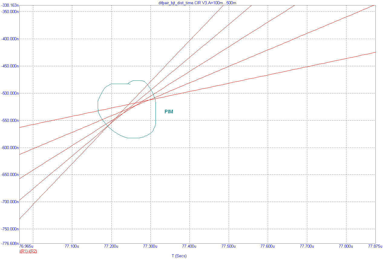

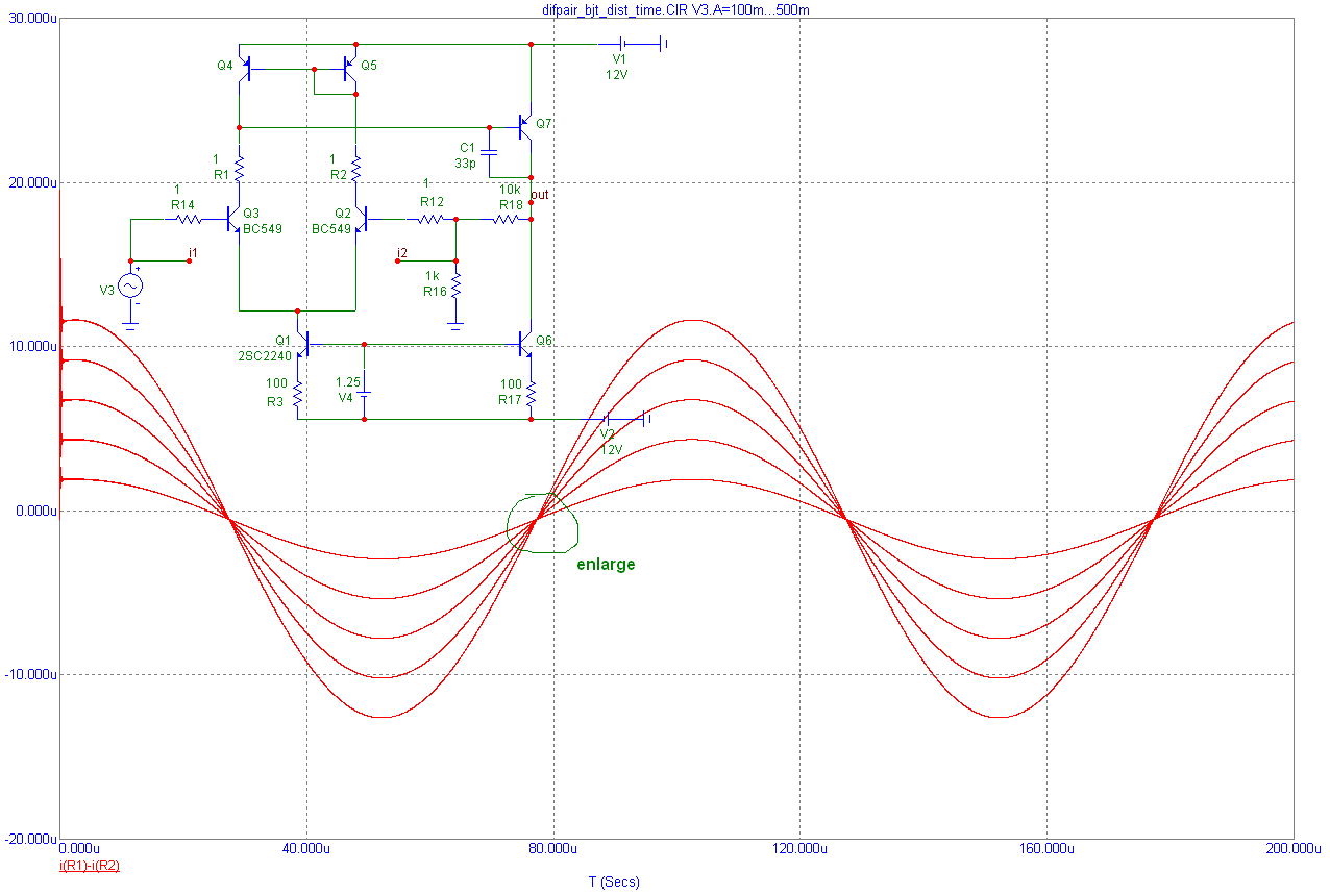

Though I am not an expert in PIM, I do not think that the CTC Blowtorch would be prone to this kind of distortion.
However, I have simulated the PIM in a very different circuit ....

PMA, here is some input for discussion of the Hawksford problem: Please note details, such as use of iron for the test, inductance cancellation circuit, emulation, etc.
When I worked in a High Power Testing Lab some 30 years ago, measuring technicians made a similar mistake. They put the coax cables into iron tube, hoping they would eliminate magnetic field interference. The opposite was truth, of course, especially due to intensity of magnetic field during high voltage circuit breakers short circuit tests. Very similar effect. I only hope M. H. had not done this intentionally to mystify the readers.
Cool. I only have scans of the article.
The most important note of all to the waveforms. The "error" is the classic error of ignoring the collapse of the magnetic field of the wire when a signal is abruptly changed. I see this error committed by many rather good test engineers who have years of experience. To see that Hawksford succumed to the same error just means he's human..
jn
