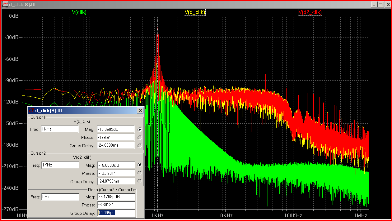

I was a too little quick, the delay sim could be considered "unfair" since the noise correlates in both channels
adding 2 different sequences to each of the delayed sine bursts you need to keep noise to < 10 mVpp to get low single digit us variance
of course even less than 1mVpp noise should be handily possible in electrical instrumentation at audio frequency
1 mVpp independent noise sequences, 1 kHz center 100 ms envelope
