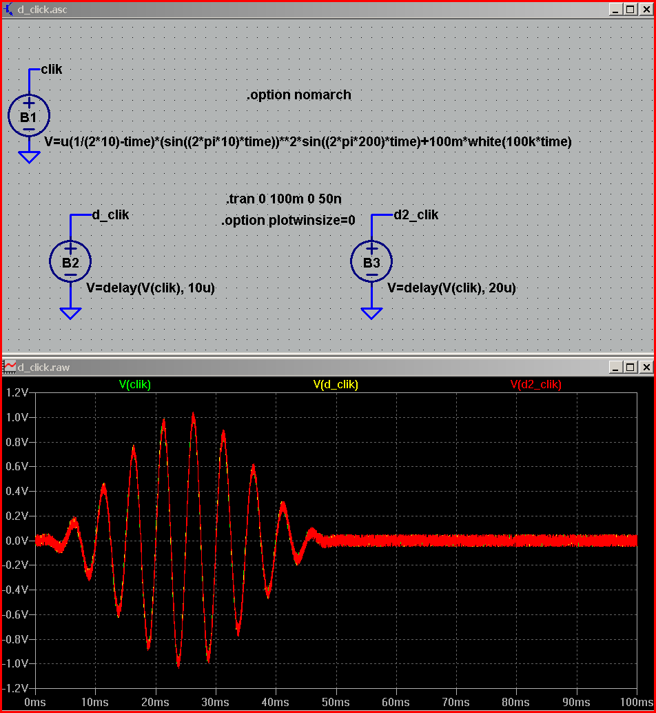

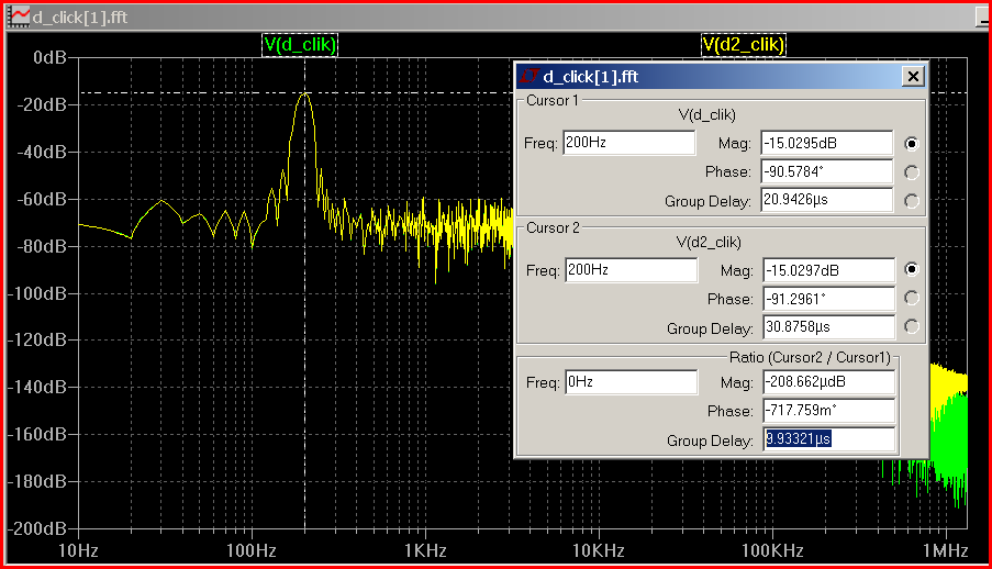

....A many element RLCG model will produce the correct results. This has already been hashed on this very thread, scott ran a ten element.
As I asked, have you ever tried to measure a 10 usec delay of a 1Khz sine into a 4 ohm load?
You will find it is not so easy..Yes, you can get some waveform result, but you will not be able to trust it..
Bingo.
jn
um - your EM may be good but your audio instrumentation seems weak
modded the interaural time delay signal demo http://www.diyaudio.com/forums/everything-else/223748-time-domain-distortion-2.html#post3245634
shows fft has no probelm resolving this - slowed to 200 Hz, added 100 mV white noise to sim with 1 V pk raised sine enveloped 200 Hz
I hope you can manage better S/N even in the real word, heck, even with a PC motherboard soundcard
