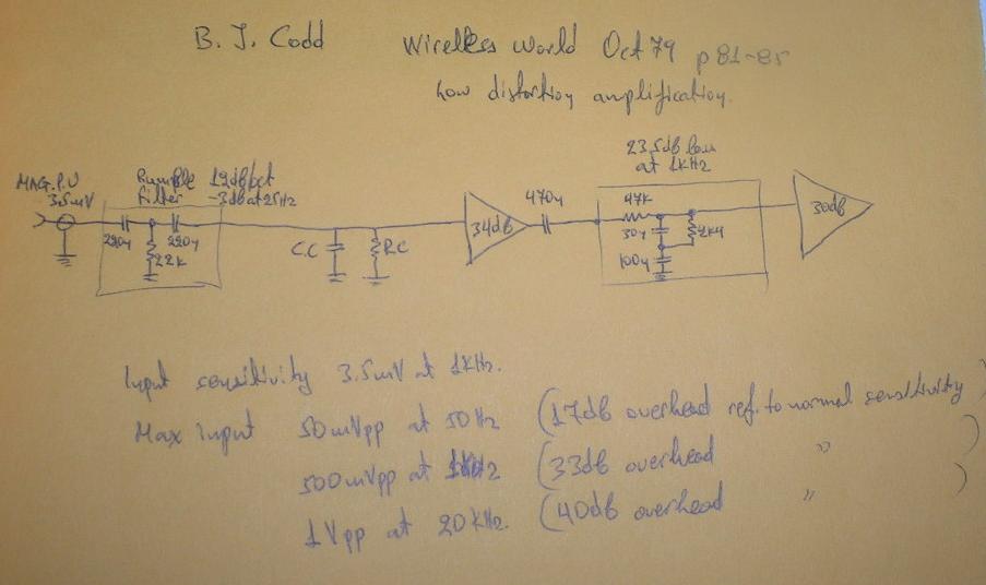

From my old notes:
http://www.diyaudio.com/forums/attachment.php?attachmentid=334809&stc=1&d=1362785172
Are there any drawbacks for placing this HP filter right at the MM pre input (or an MC pre input) ?

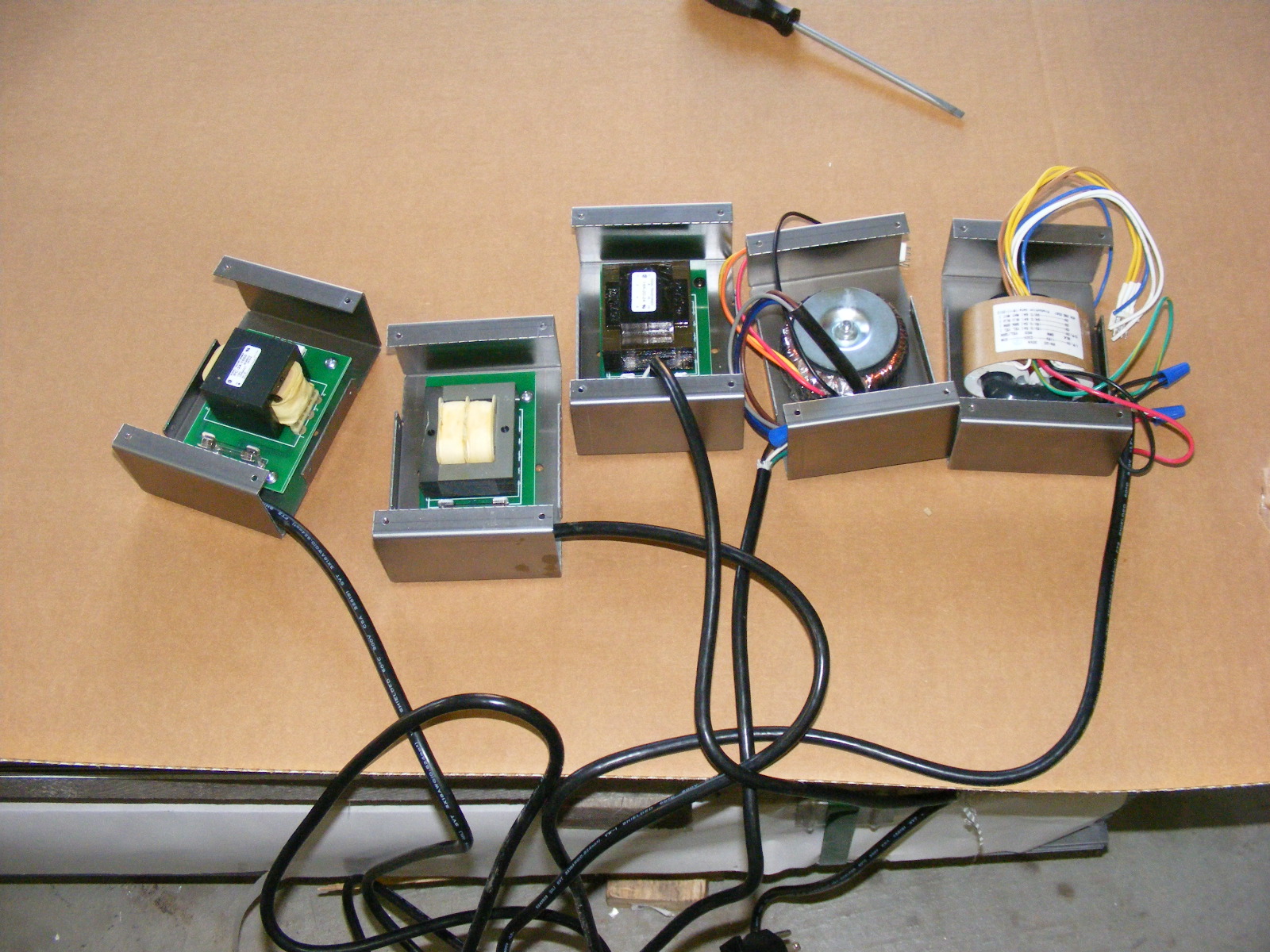

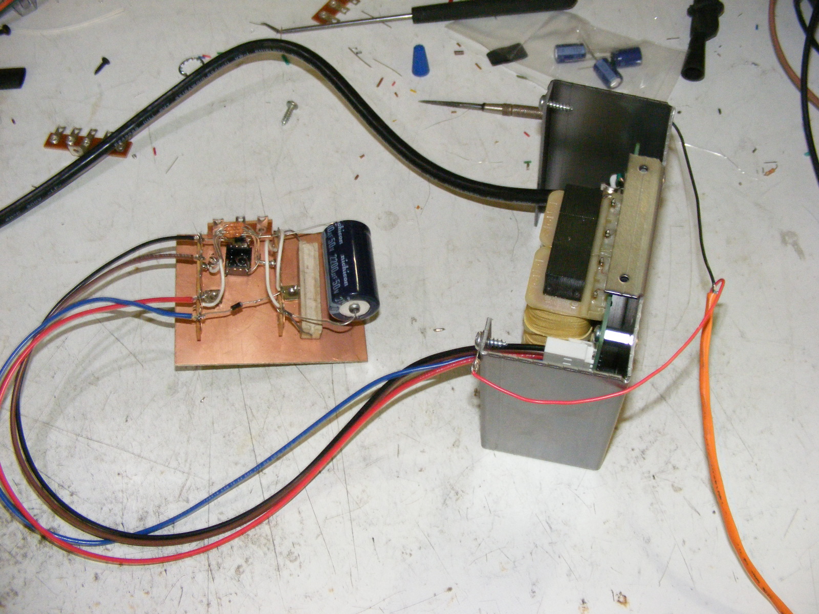

Here is what I was up to today. Measuring transformer leakage both loaded with a small power supply and unloaded.
And the winner is.... ?
George
Codd's piece (sorry couldn't resist) will misterminate a typical MM cartridge, for which the typical 47k has most of its effect at high frequencies. So you will already be well-below that resistance just due to the 22k shown.OK Ed. My mistake.
From my old notes:
George
George
George
So far I have only measured flux leakage. Still to be done is line noise pass through and AC balance.
The loser is the flatpak. The best may be r core and tortoid.
There is more than 2 millivolts across the chassis for the flatpak.
