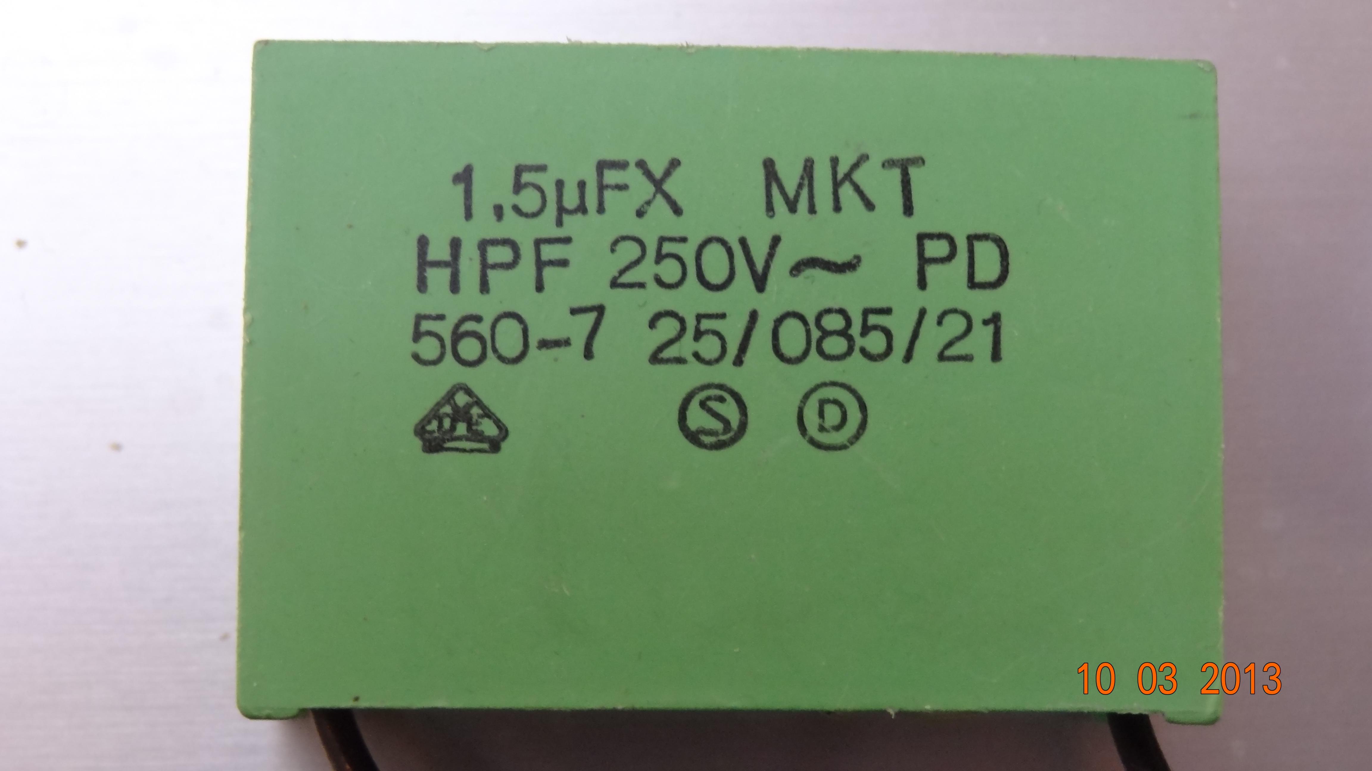

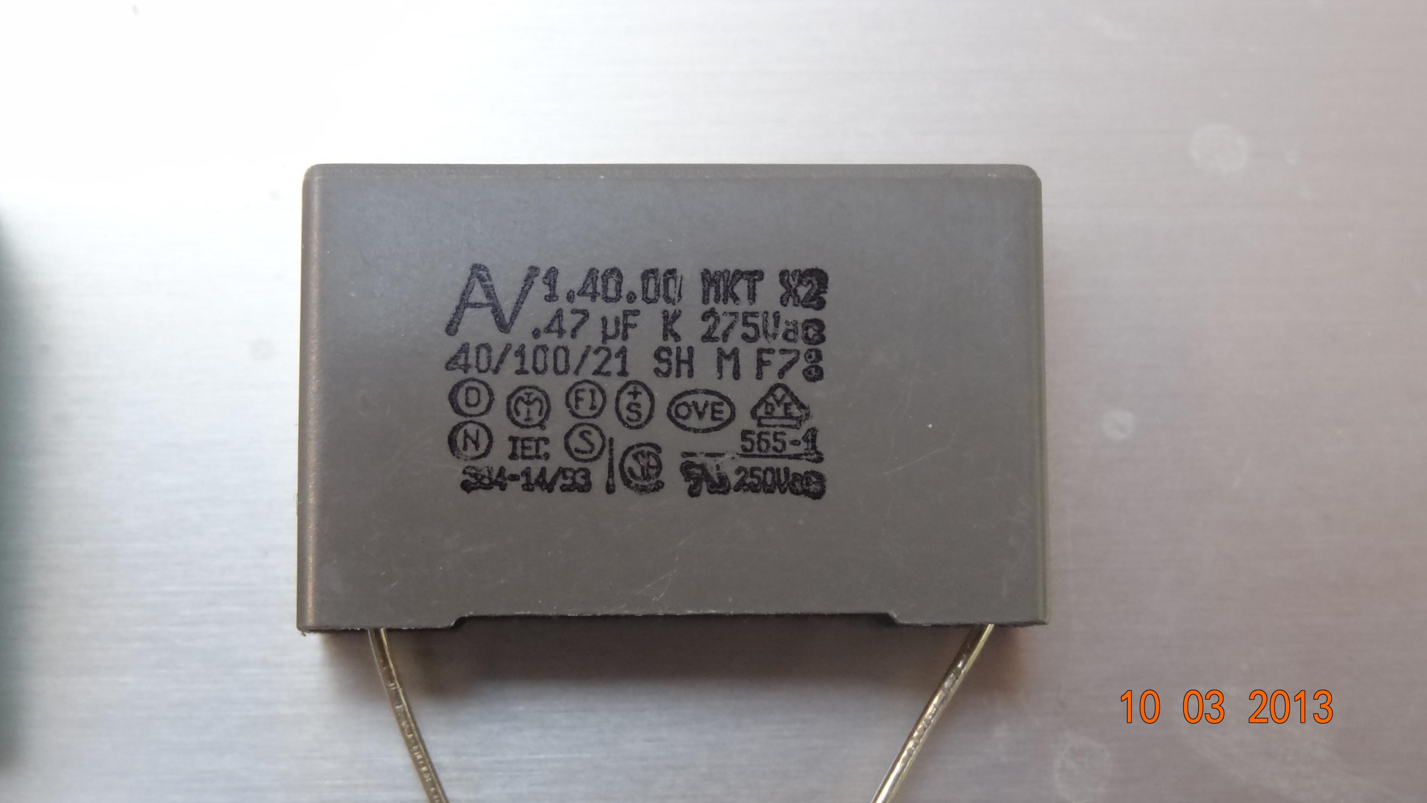

caps which are approved for ac line voltage duty have a stamp of the agency(s) that approved it ($$). All parts if the size allows will have a code number or stamp or molded into it some way to track it and proof of compliance...... they are also better made parts... so you get what you pay for.
![Approved cap 2.jpg Approved cap 2.jpg](https://www.diyaudio.com/community/data/attachments/314/314674-9378fe151477c2788a8f99f09e5799b4.jpg)
![Approved cap.jpg Approved cap.jpg](https://www.diyaudio.com/community/data/attachments/314/314688-de295f664b4882791741e1a8acb2b2f4.jpg)

Richard,
Thank you for the clarification on that. So as long as the specification sheet has the UL rating that is what is required, not that each individual part is marked with the UL logo. I can understand your concern and desire to keep safe, I wouldn't want to subject anyone to that kind of problem, I've gotten my share of zaps over my life and they are never pleasant! I have a piece of equipment that came with only German electrical standards and believe me it was a real pain to get the machinery certified so I could use it, that was the last piece of equipment that BASF shipped into this country without a UL cert on it. Same went for the fact I would not accept the pressure vessel cert for some chemical tanks for that same machine, my friend who was a mechanical engineer clued me into that before the machine was sent and I made them produce the tanks in the US to ASME standards. Same as the electrical problem they used nothing but American made and certified tanks after I clued them into this standard.

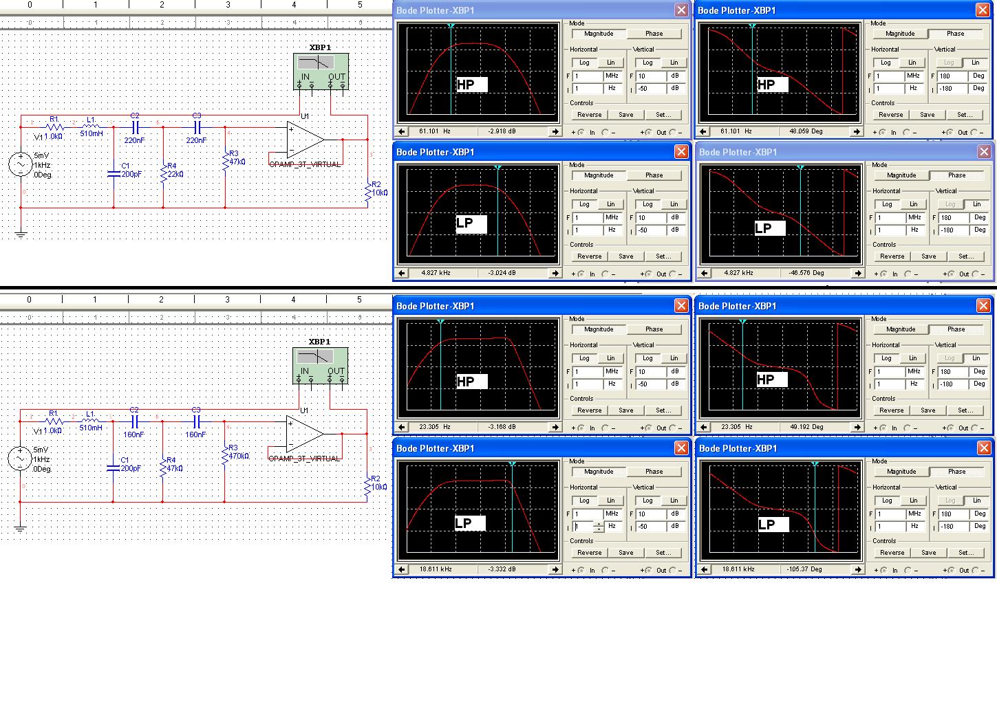

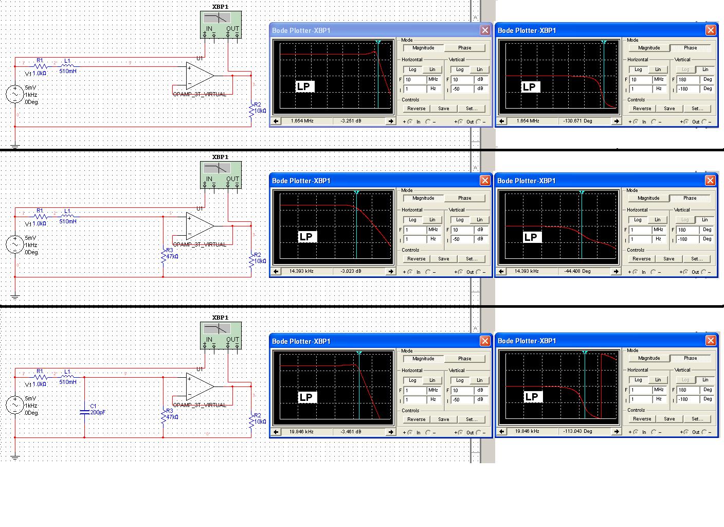

Codd's piece (sorry couldn't resist) will misterminate a typical MM cartridge, for which the typical 47k has most of its effect at high frequencies. So you will already be well-below that resistance just due to the 22k shown.
Brad
Thank you. Comments are welcome.
From the simulations I run, this HF roll off can be compensated for. See the two lower circuits of the two attachments.
(1kOhm and 500mH are the MM cartridge. 200pF capacitor represents the capacitance of the cable).
Do you see any other issues with this HP filter there?

Spec sheet is a minimum.... but with parts made all over the planet, you cant always count on the spec sheet and what distributor is selling you is same version. In most cases UL requires the labelling. And, you would want the label on your part to help explain why your competitor without the approval mark is so much cheaper than your part. And, that you are assured it will pass the required tests if you use the cap marked as such in your product.
many people on this forum are not as aware as professionals in the field are of these saefty issues and requirements of manufacturing and built home made things which wont be safe unknowingly. So just use "approved" parts and be safe and the reliablity is built in. yes, it will cost more.

Transients? Any affect on cartridge tracking or damping?

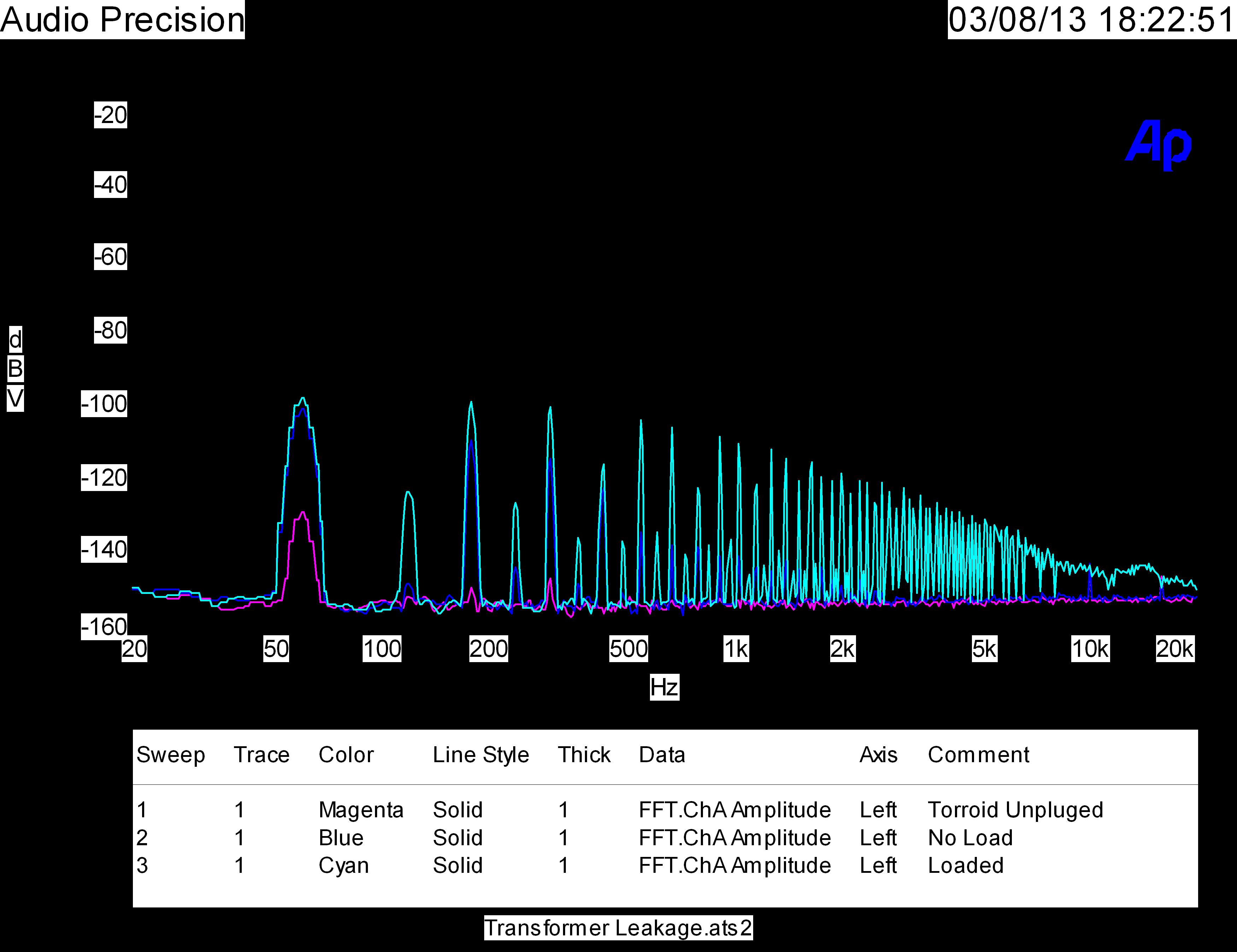

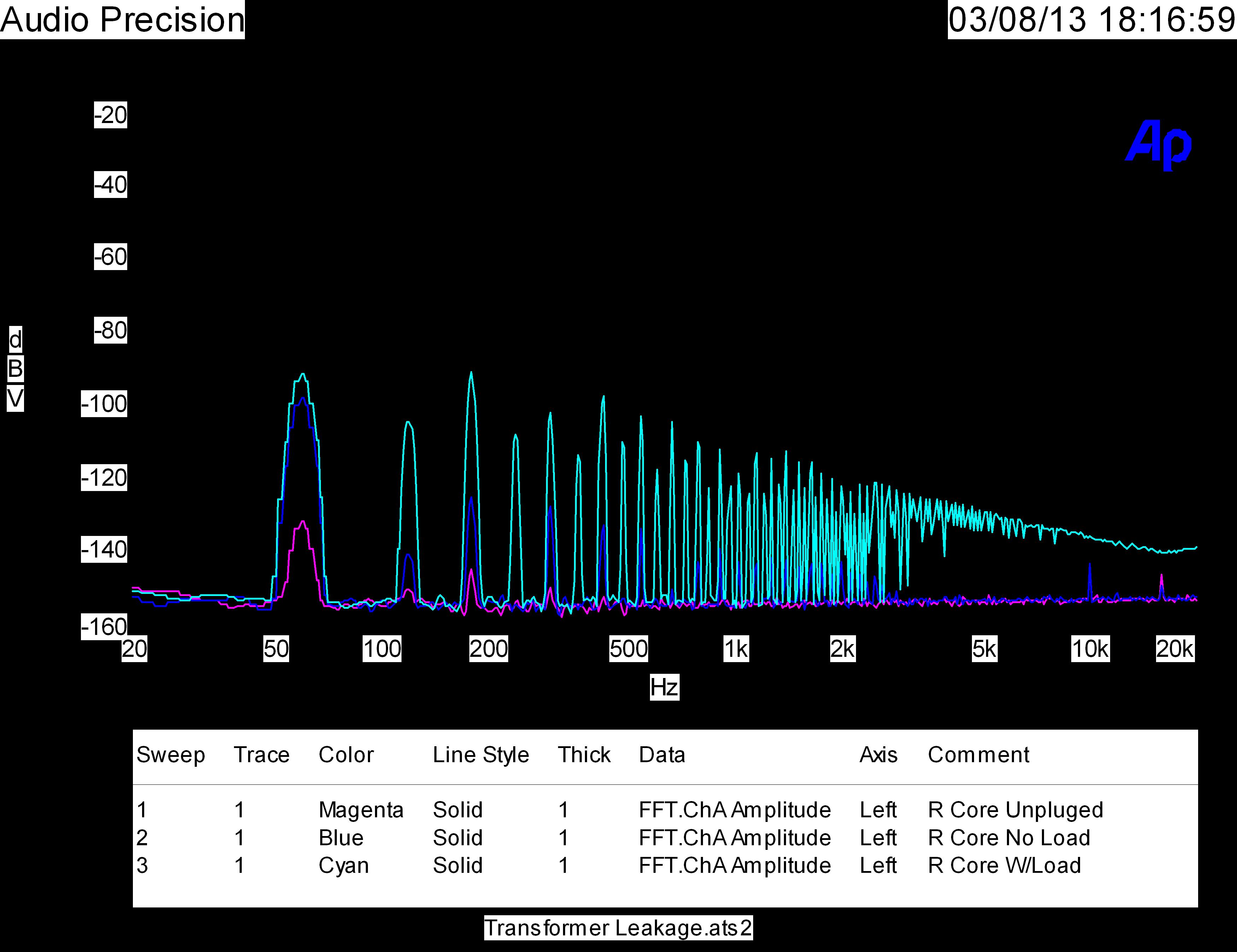

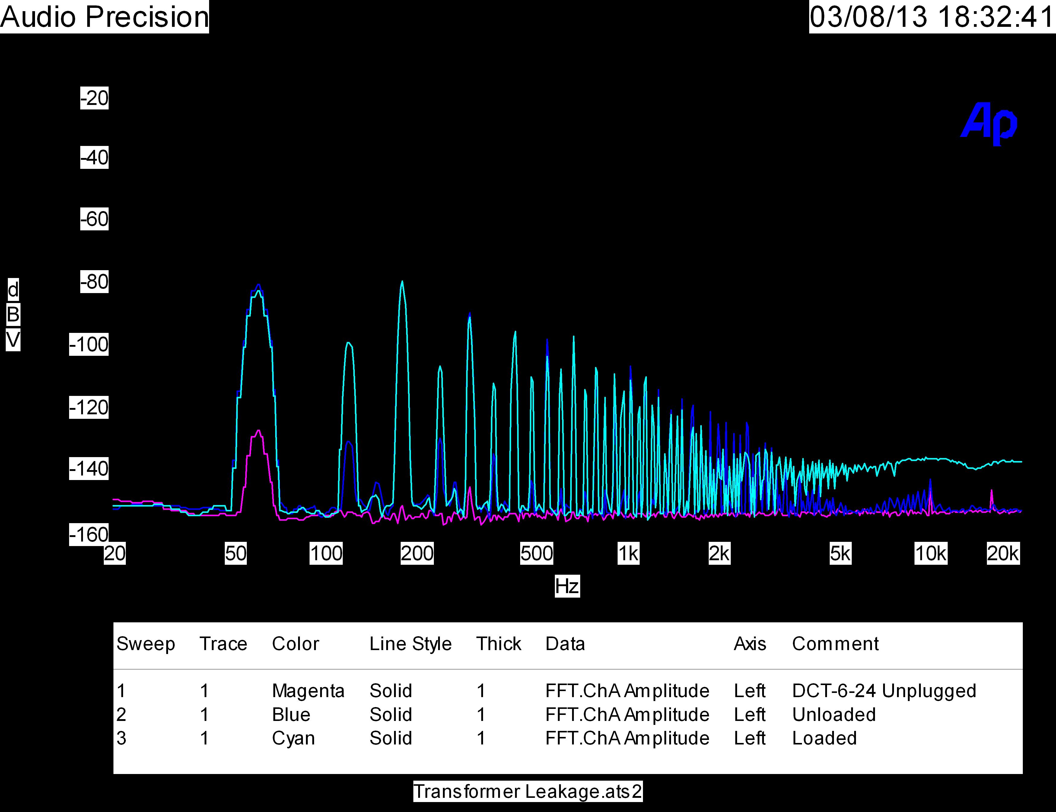

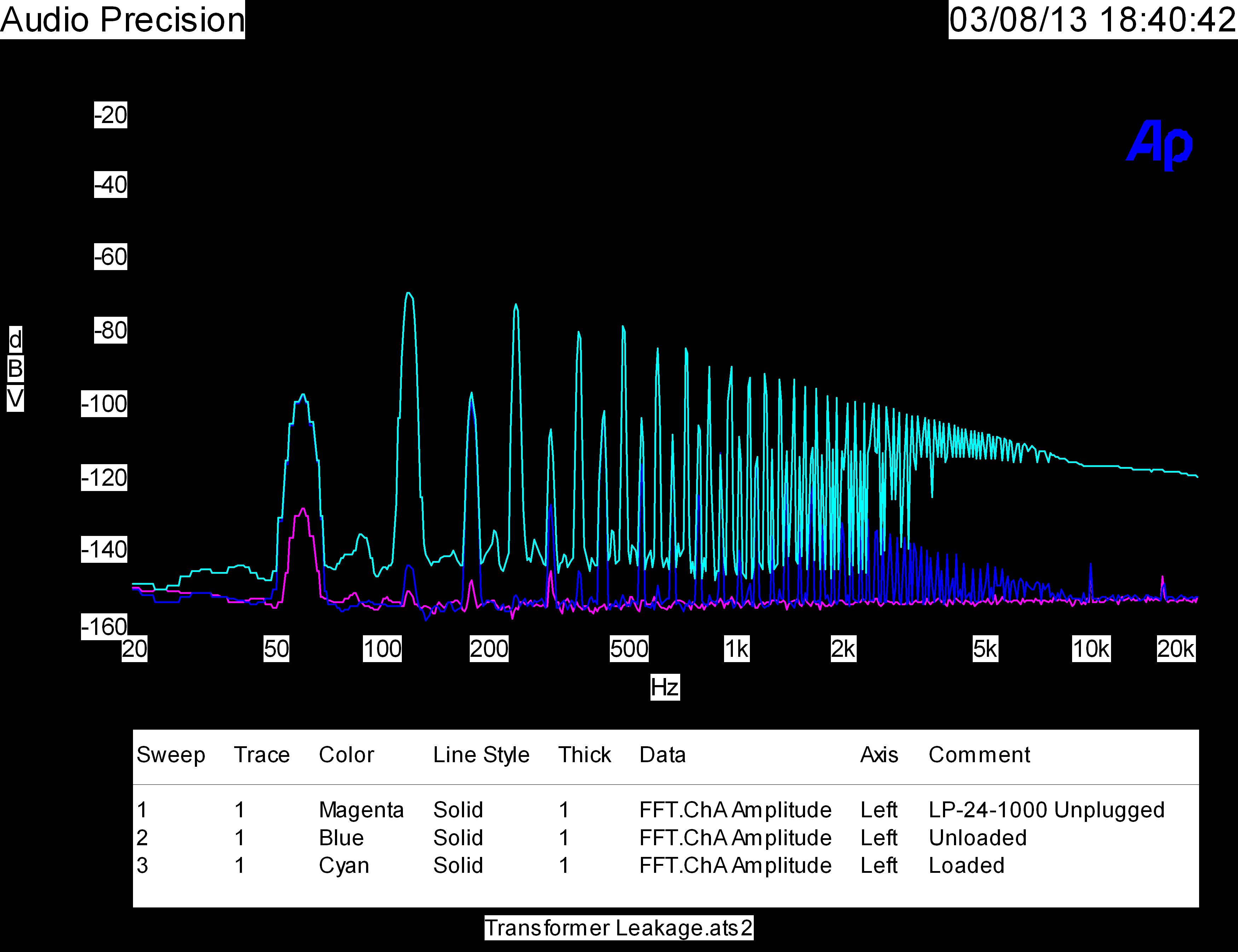

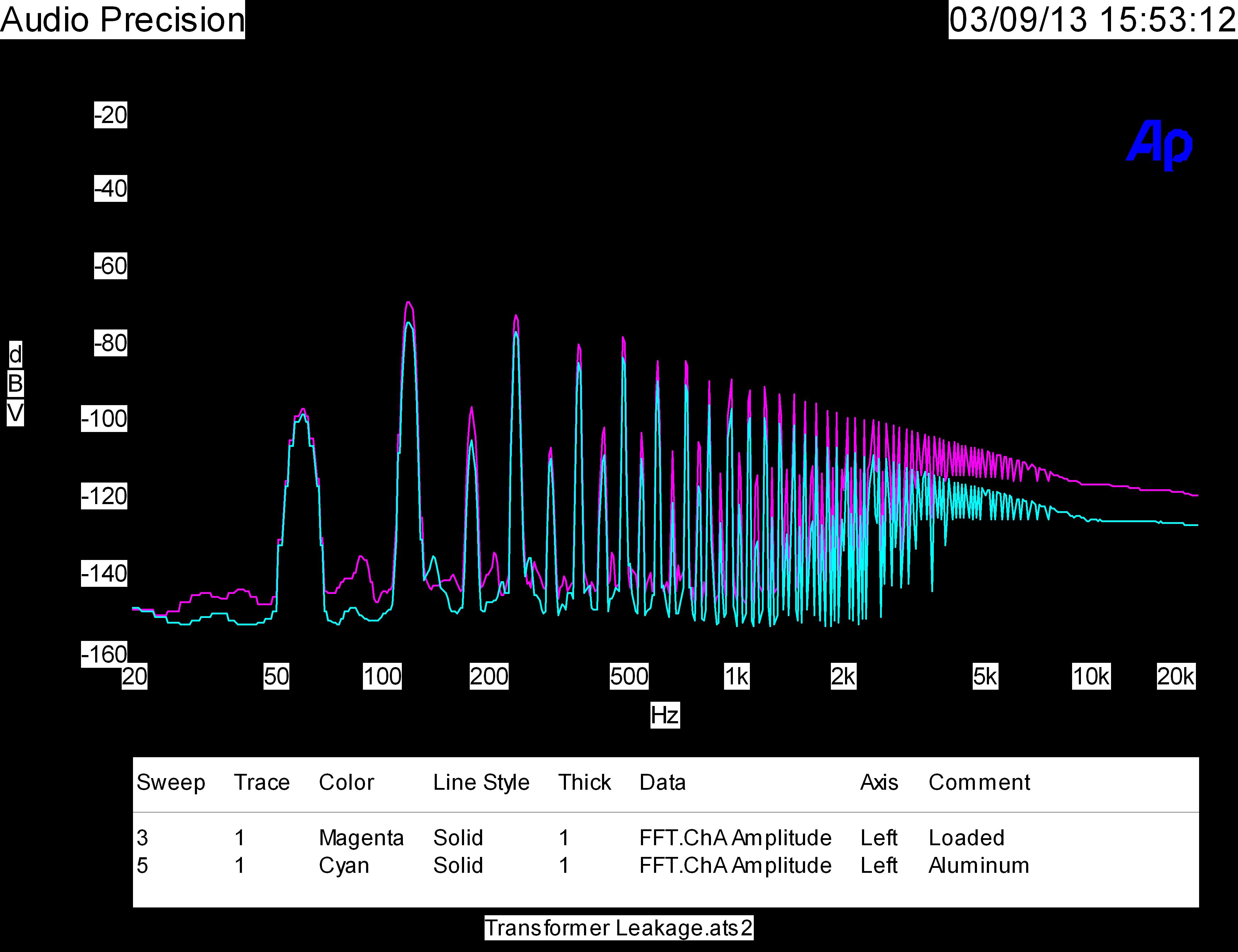

Attached are the FFT results for six different transformers of different construction but all about the same ratings. They are imposing a voltage on the chassis as shown in my test setup (Prior Post.) There is a duplicate of one transformer but using an aluminum chassis.
Four of the transformers (All Signal Brand) are mounted on PC cards. The R core came with a bracket and the Triad Torroid uses a single bolt. The ac cord is the same shielded 6' type with the safety ground connected to the chassis. The R core has a shield that is also grounded.

How are you going to make them all - transformers - zero/base-line'ed?
If you have an idea how to do it I am very open for it. What I tried was to mount them all using the mounting typical for each type. All centered in the same chassis. With the exception of the R core they all have the same voltage rating and are close on current.
