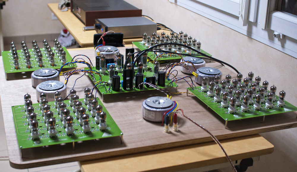

To my knowledge, Richard was the first guy to measure the alarming bandwidth of toroid power transformers. Later, we realized that the high internal cap coupling was the reason that the bandwidth was so high. That is why we switched to R-core or at least split bobbin, if we could in recent years.
Flawless till 100KHz, Menno told me at the dinner table.
Standard series toroidals as output transformers, sounded so wonderful that I have goose bumps, recollecting the moments.
