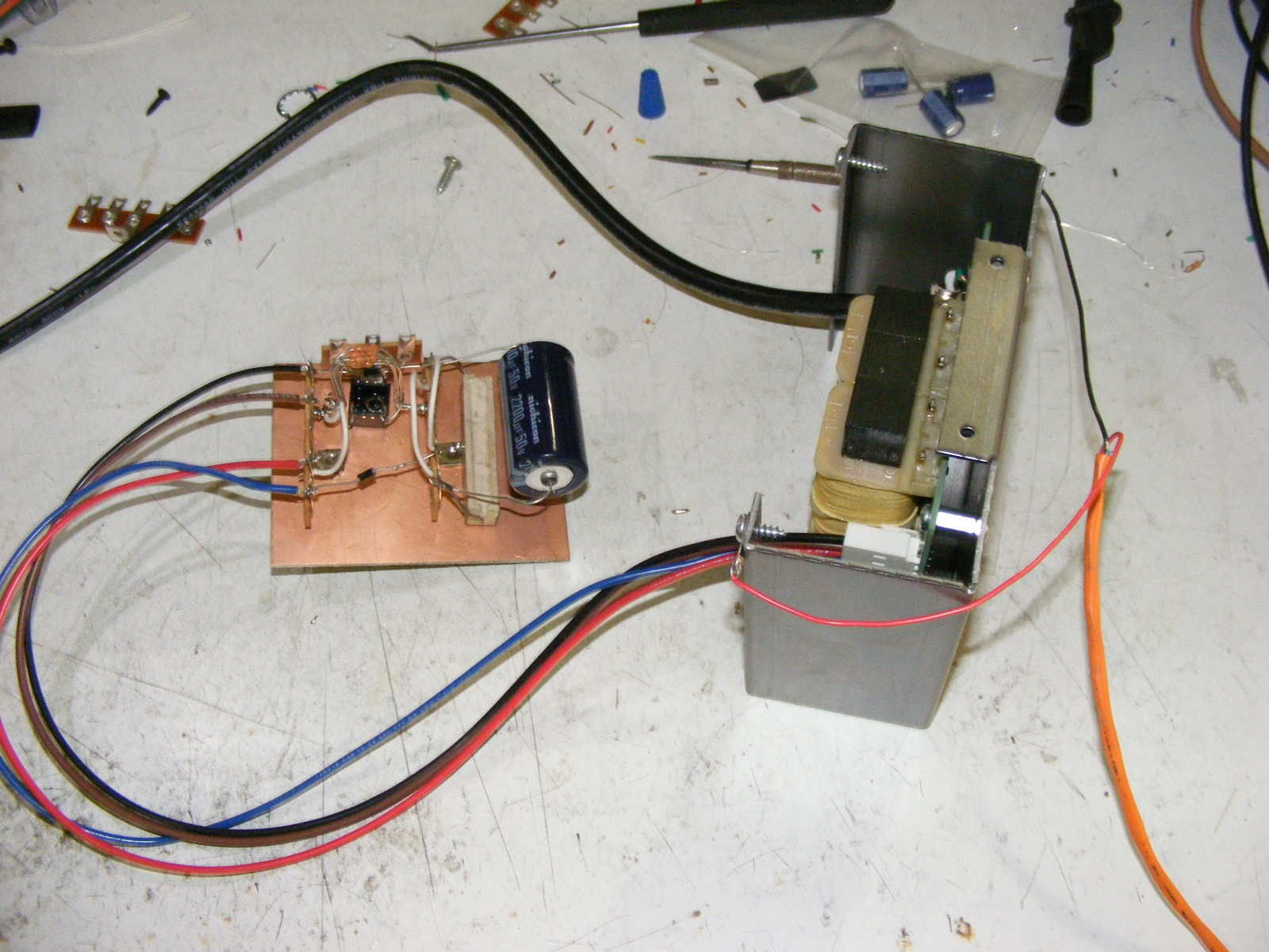

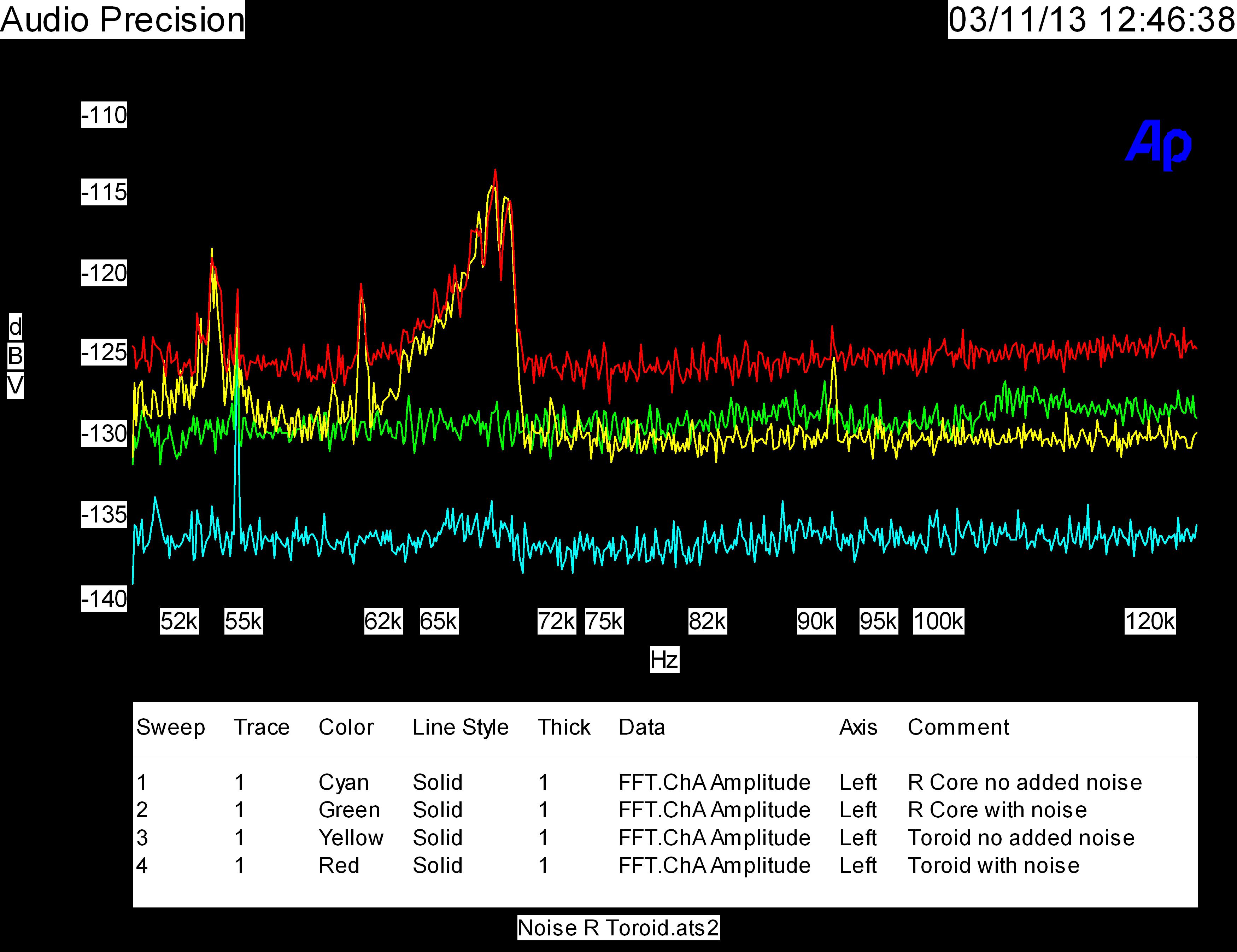

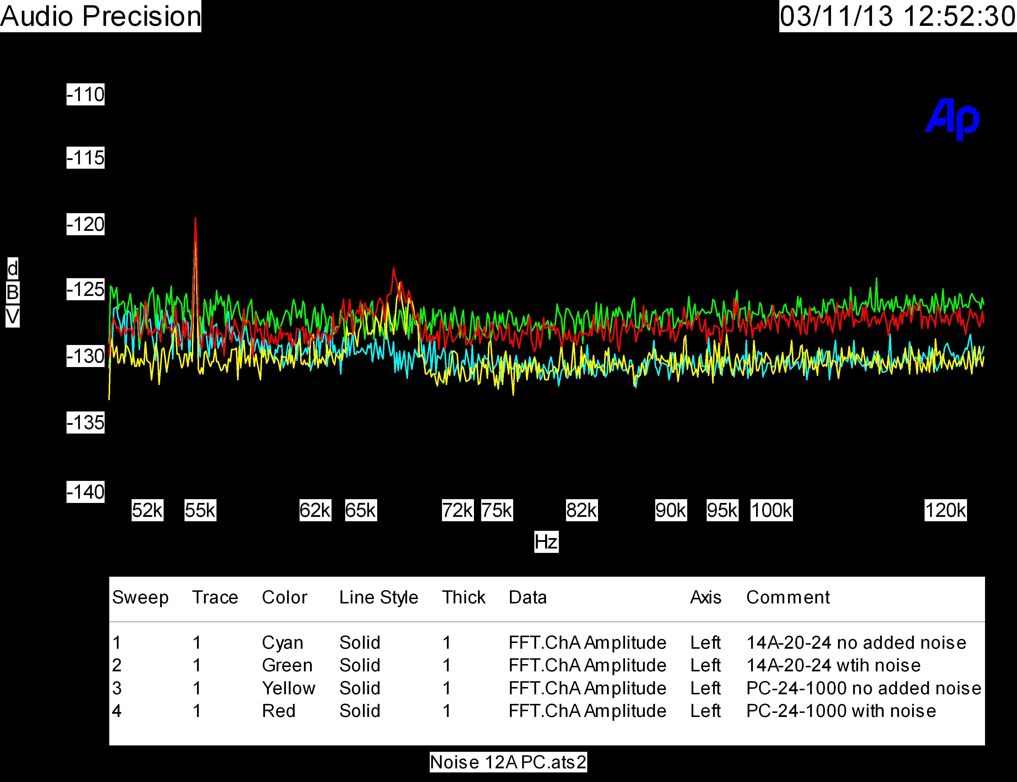

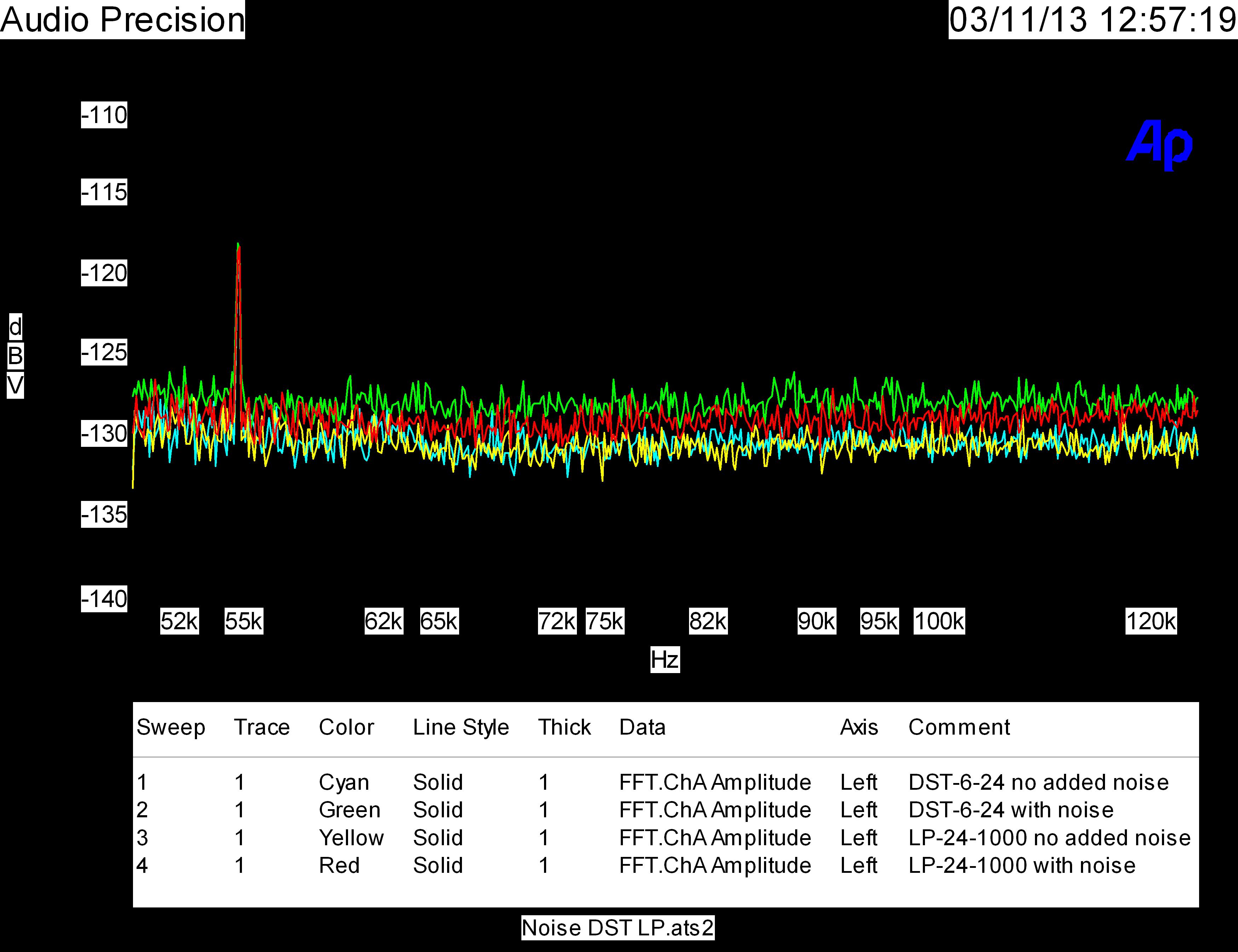

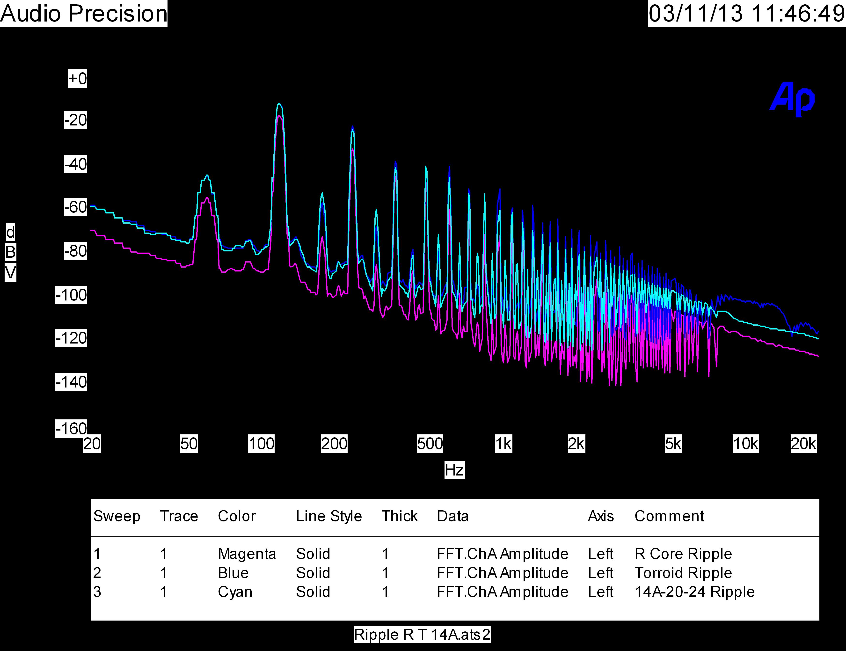

Attached are the noise isolation and ripple. The noise is shown as a baseline with the transformer hooked up as a center tap to two diodes. The filter is 2200 uF and the load is 50 ohms. The noise is measured across the filter capacitor as is the ripple.
My noise source is a small relay connected as a buzzer. The relay coil is coupled via a single 1nF 2000V cap to the AC hot side. The rest of the path is through the diode bridge feeding the relay and the stepdown transformer.
