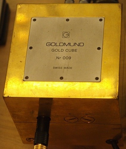

audiophile chassis in plain machined gold.
They do, it's called an Ingot amp, single requirement is to drill & thread some holes.
(duh, no one likes my patent approved wording)

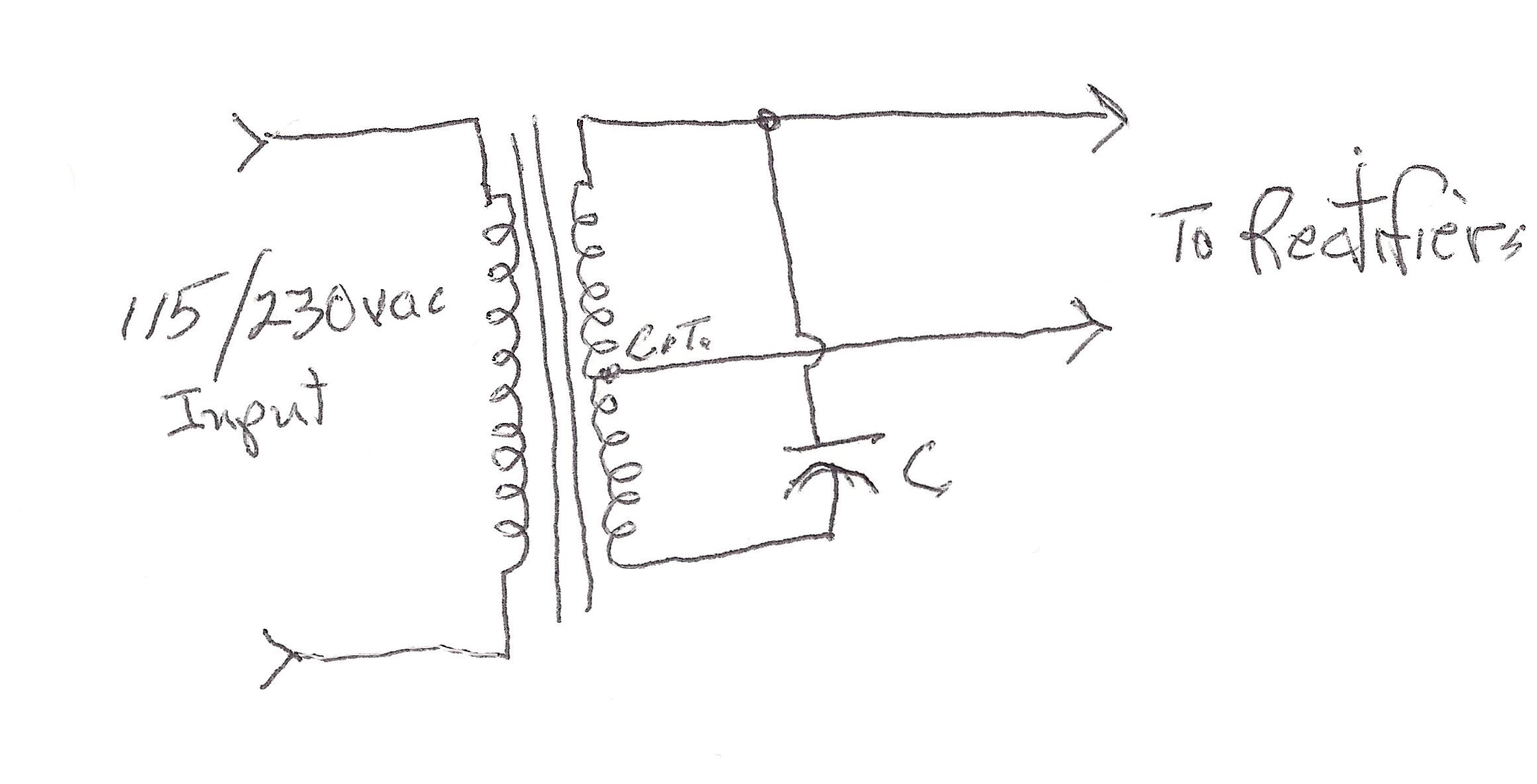

some simple things can help in certain places for certain issues:
What else can be done?
Thx-RNMarsh
Clever,
I sometimes use a series pass semiconducter just after the rectifier. It is set so that it conducts until the input voltage rises to about 70% of the peak voltage. That way you get some regulation, but you also are not squashing the top of the sine wave. It helps power factor, cancels some harmonics and can be used to derive multiple voltages from a single transformer.

in a perverted sort of way.
Only gold plated, weigh about 15lb each, had one in my hand shortly after they were released.(didn't make it to the front door)
http://www.diyaudio.com/forums/soli...mplifier-i-have-ever-heard-6.html#post2326337

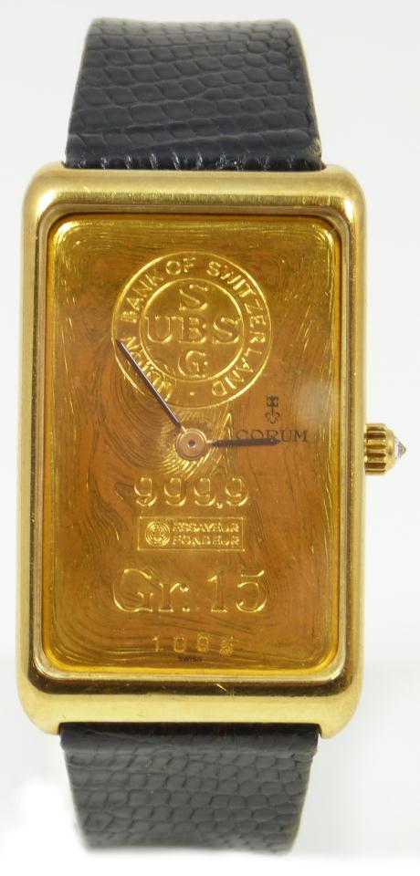

In the '50s and '60s, Swiss watches in the US often had gold plated cases, the inferior bodies were manufactured in America for tax reasons.
e.g. Rolex.
Thx-RNMarsh
Wouldn't you reverse bias the elco every half cycle this way?
Thx-RNMarsh
Well, you could flip it around if you're on 120vac mains with a dual 120vac primaries. In either event, you'd be in 'violation' of Menno Vanderveen's US patent # 6087822. This is used in the Torus conditioners from Bryston.
It worked quite well on the primaries of an overspecified r-core powering a dac.
