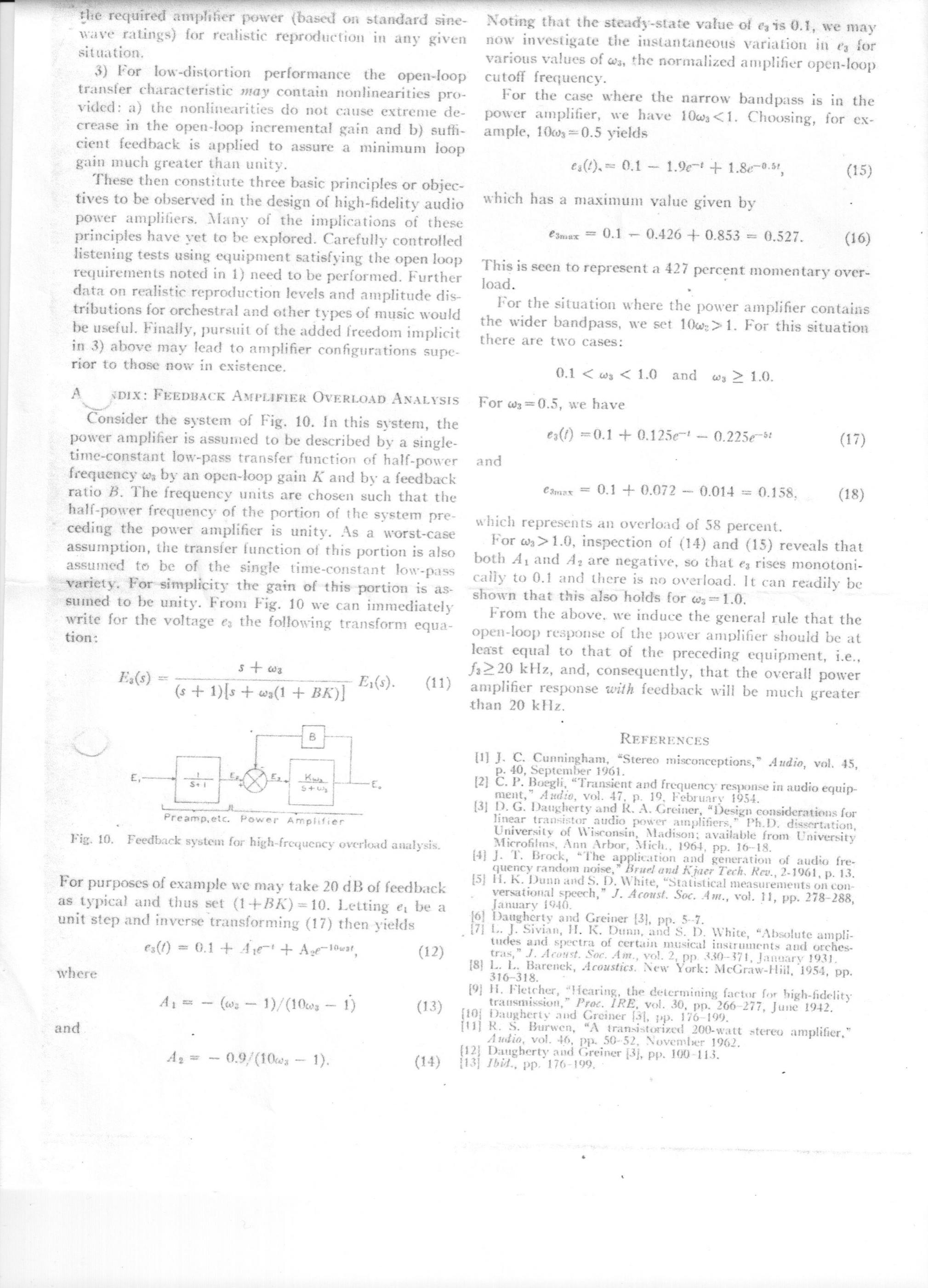

Bogdan, your question is real, but incomplete. What REALLY makes a lot of regulators 'fail' sonically is if they ring, with a changing current output. It might be 'possible' to determine that from the curves given, but not easily. I am going to put up the last page of a PhD thesis, a part of which was published in 1966, in the IEEE. There is the math for what you are asking, however nobody here takes it seriously, except somebody like me.
Daugherty and Greiner's classic paper contains errors an misinterpretations widely discussed in textbooks, over the years. For a short summary, see Slew-TID under "TID".

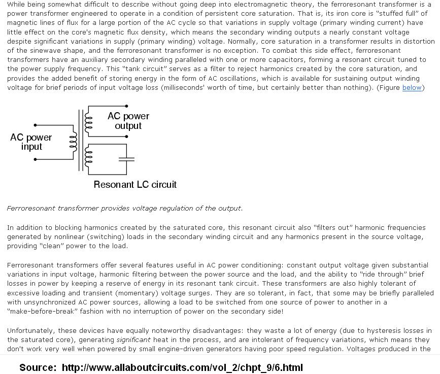

For a given size trafo, low copper losses and working close to core saturation achieve good (low) load regulation. For EI units, the more filled is the winding window, the better.
For this target, one could also consider a ferroresonant construction
The truth is that they are a vanishing component. Between power factor requirements and efficiency requirements the traditional transformer-rectifier supply has a dim future. Investing time in making a good audio grade switcher would have a much higher long term return. And a bigger challenge.
I understand although I am novice.
Thanks for the link. The analysis of max slew rates in signals is somewhat problematic- for a properly designed digital source, I can't disagree, but for the currently fashionable (in certain niches) NOS systems and certainly for phono, they fail to take into account the noise inherent in those sources (especially ticks, pops, and mistracking). A small transient event can affect in band (audible) performance. (In RC-coupled circuits, this can also manifest as blocking, an even worse problem)
It is interesting, however, to see how people were feeling their way around back in the '60s and '70s as well as how quickly these issues were put to rest (other than in fashion audio gimmickry).
