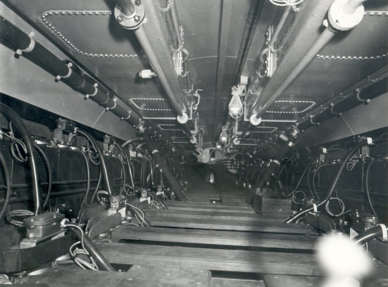

Me sorta grew up with this beauty, she went to bed when I left for university.
(3-cilinder submarine, L+R battery of 168 cells of 2.1V, instead of Forward + Back battery)
All-DC, with 350V-1500A through a 400mm2 cable (subs require far less power submerged), only Biot-hazard law complaints.

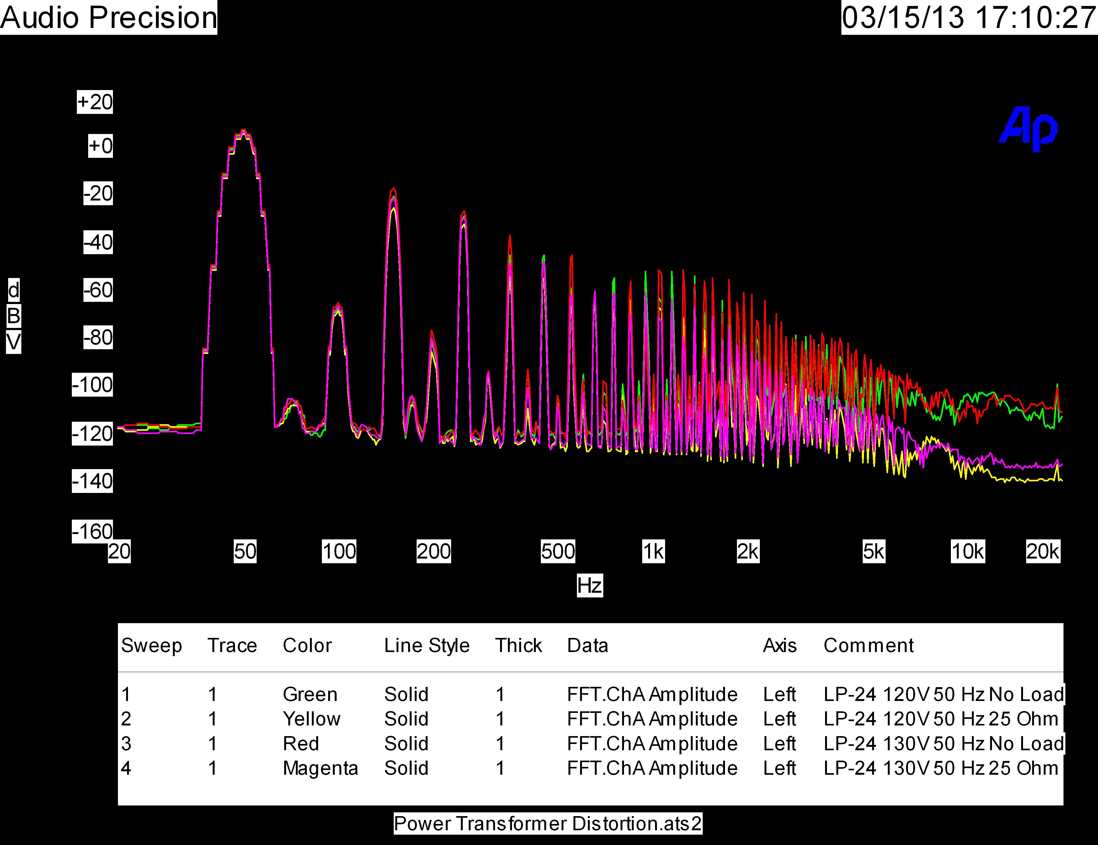

Well I ran a bit more than 100 measurements today on power transformers. Attached is one of them.
This shows the harmonic distortion of a flatpack style transformer with dual bobbins. A primary and secondary on each bobbin. It is measure both with and without a 25 ohm load across series connected secondaries. Since each should be 12 volts that gives just about a 1 amp draw. Input voltage is 120 or 120 x 1.1 (130 ish) at 50 hz.
My conclusion is that it should be loaded with a 10 uf capacitor across the secondary in most uses.
Note the distortion does increase with higher voltage, but not as much as from lower frequency when compared to the 60 hz curves.
I'll show more later if anyone is interested.
Interesting work. Will this be an article on Linear Audio or something?
When you get round to it, you could investigate the effects of a "swenson snubber" as well.
