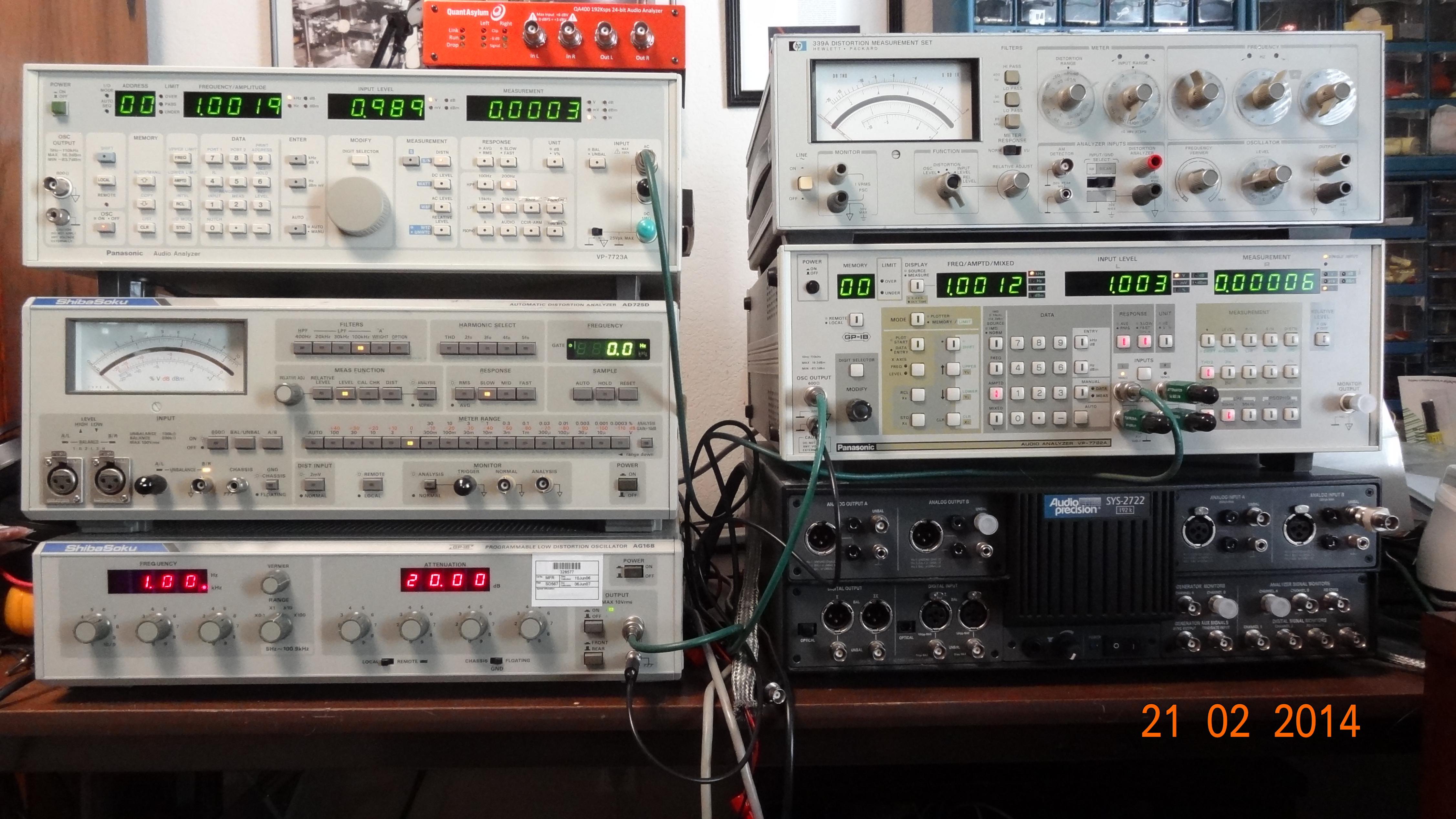

DADOD's DIY amp on another forum at 100W/8, 5KHz THD = .0024%
Pretty nice. BUt the distortion was 10X higher until I rearranged the various grounds... always seems to be a problem with testing.... using isolation transformer on A-P and battery on the PC etc. Then you get lowest data on FFT tests.
Makes me wonder again if distortion will be higher when used in a complete audio system. Thats why I use isolation transformers along with filters on ac line.
THx-RNMarsh
Not necessarily, but again, proper grounding and wiring scheme is requested. I use only one PE-AGND connection in the whole system and for sensitive measurements, battery operated notebook. Then, the whole chain, CD-preamp-poweramp has pretty high S/N and very low distortion. And it reflects real conditions.
BTW, very nice result.

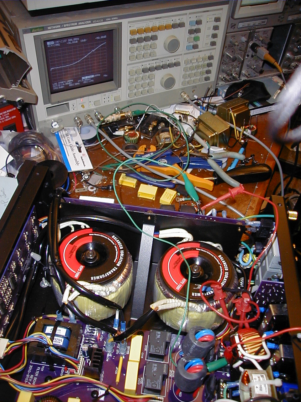

I use a massively over-kill ELGAR voltage regulator on the main audio system which isolates it well from all the rest of the house ac line noise and fluctuations.
I designed this dual ultra-isolation transformer/filter for others and the filter is > 100dB atten within audio. Excuse the R&D mess on my work bench.
It is used to power and isolate the analog and the digital circuits/equipment.
Then use these to evaluate the non-linearity results without ground and ac power emi/rfi --- very clean system is assured.
Well, it's just a hobby so how serious can one be?
THx- RNMarsh
![03010006.JPG 03010006.JPG](https://www.diyaudio.com/community/data/attachments/439/439159-5e7e50dae6a3b8743219aa81e0a17858.jpg)
